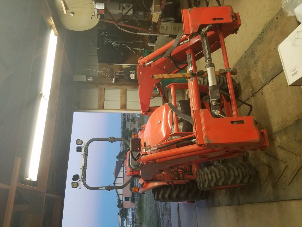

I was wondering how you all have made a bar to attach to the ROPS, to mount your lights on? I need something that will tuck in the ROPS so that when I brush against a tree limb, the limb goes against the ROPs and doesn't hit the lights.
Curious to see what people made and how their attaching to the ROPS. My current is just some angle iron, nothing fancy. Looking for a cleaner setup.

I mounted my lights to a random chunk of square tubing. I then used some U bolts to strap that square stock to the ROPS. Made some hockey puck spacers out of PVC pipe to give clearance between the bottom of the brackets & the ROPS.
Got things mounted without modifying the ROPS.
