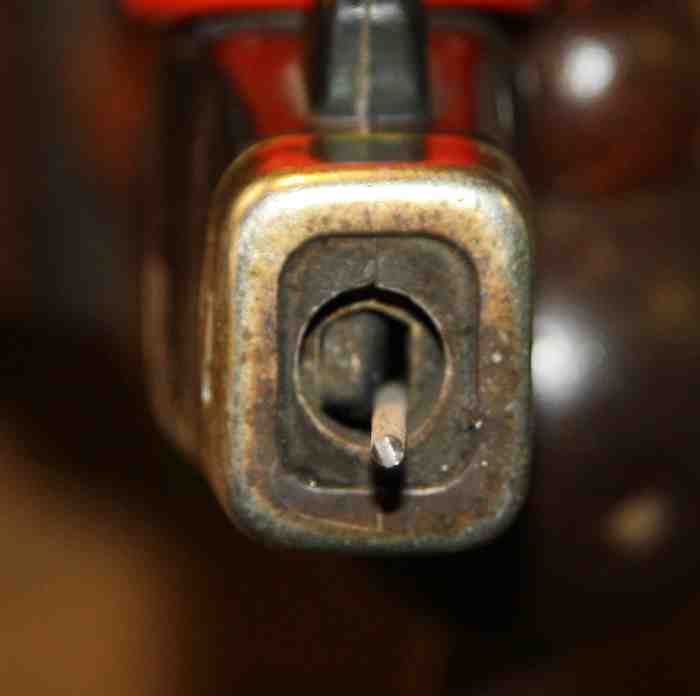

Something I noticed is that 3/32" electrodes can slip by the clamping portion as you screw the head down and it will be beside it rather than between it and the V. You have to pay attention and hold the electrode at the bottom of the V while you screw the head down.

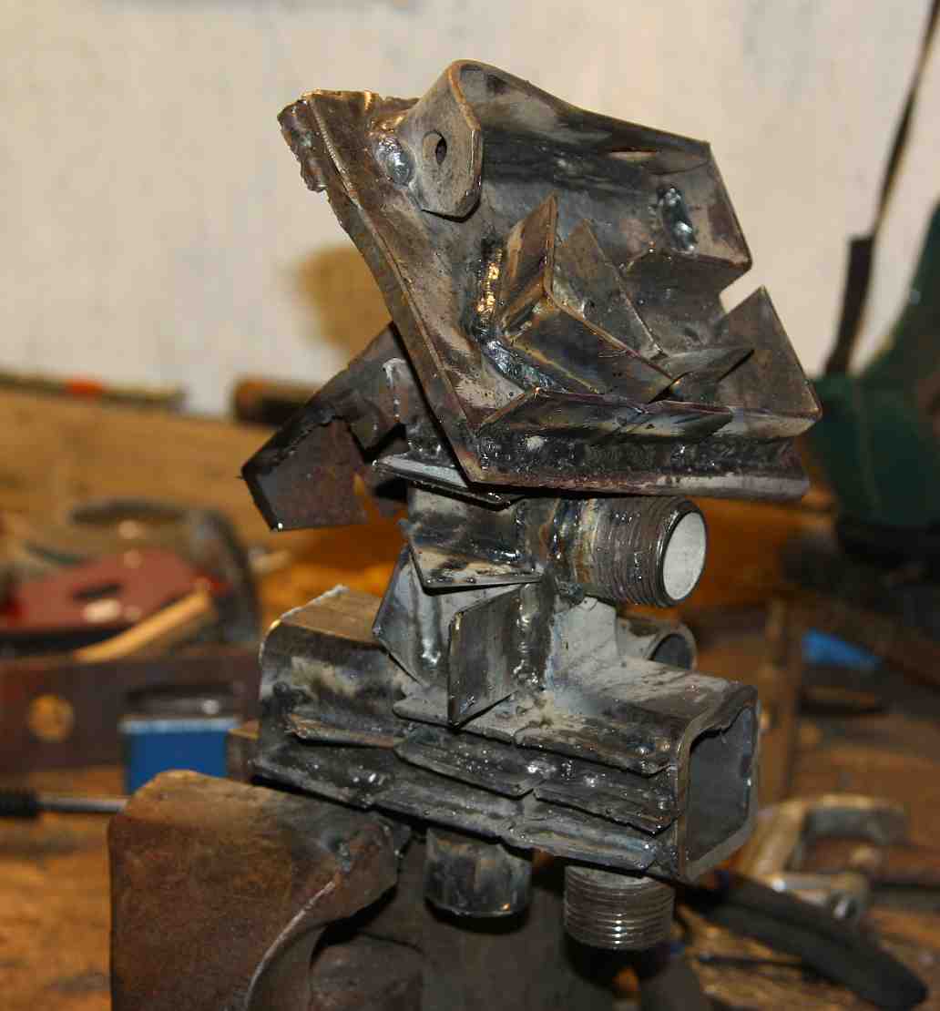

Also attached is the resulting sculpture of me welding all my scrap bits together for practice. Maybe I can call it modern industrial art and sell it on ebay. LOL
Edit: I don't intend this to be an Everlast bash. The screw head is perfectly functional. It's just not idiot (Ian) proof.

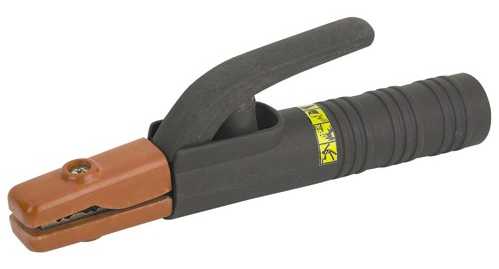

I picked up this harbor freight electrode clamp yesterday for like $4 to try out. I like it. Much easier to operate than the other type. My only gripe is that the release lever is too close to the handle, so getting a two handed grip takes some fiddling. I'm going to order a Lenco HT series clamp. It's got a lever designed with more clearance between it and the handle.

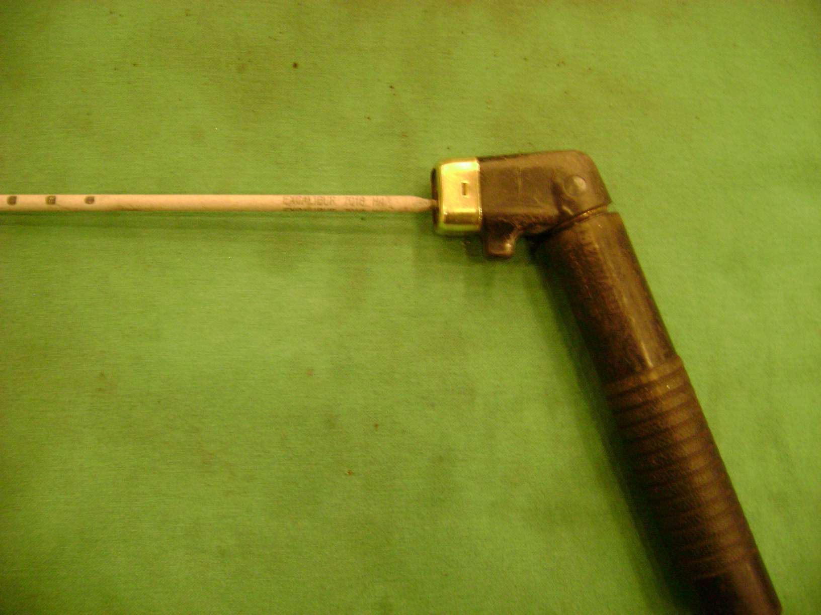

When I started out about all we ever got on the job were the 400, 500-amp versions. I got so use to holding the stinger / electrode holder with the handle on the back of my hand, with the round part in the palm of my hand. Then going to a 200-amp stinger just didn't seem natural having to hold the entire stinger in the palm of my hand, because I couldn't get my hand under the handle. Those 500-amp stinger are nothing short of a club, I guess that's why I like the short stub, have the comfort of a 500-amp stinger, (which I'm use to) but not the weight.
