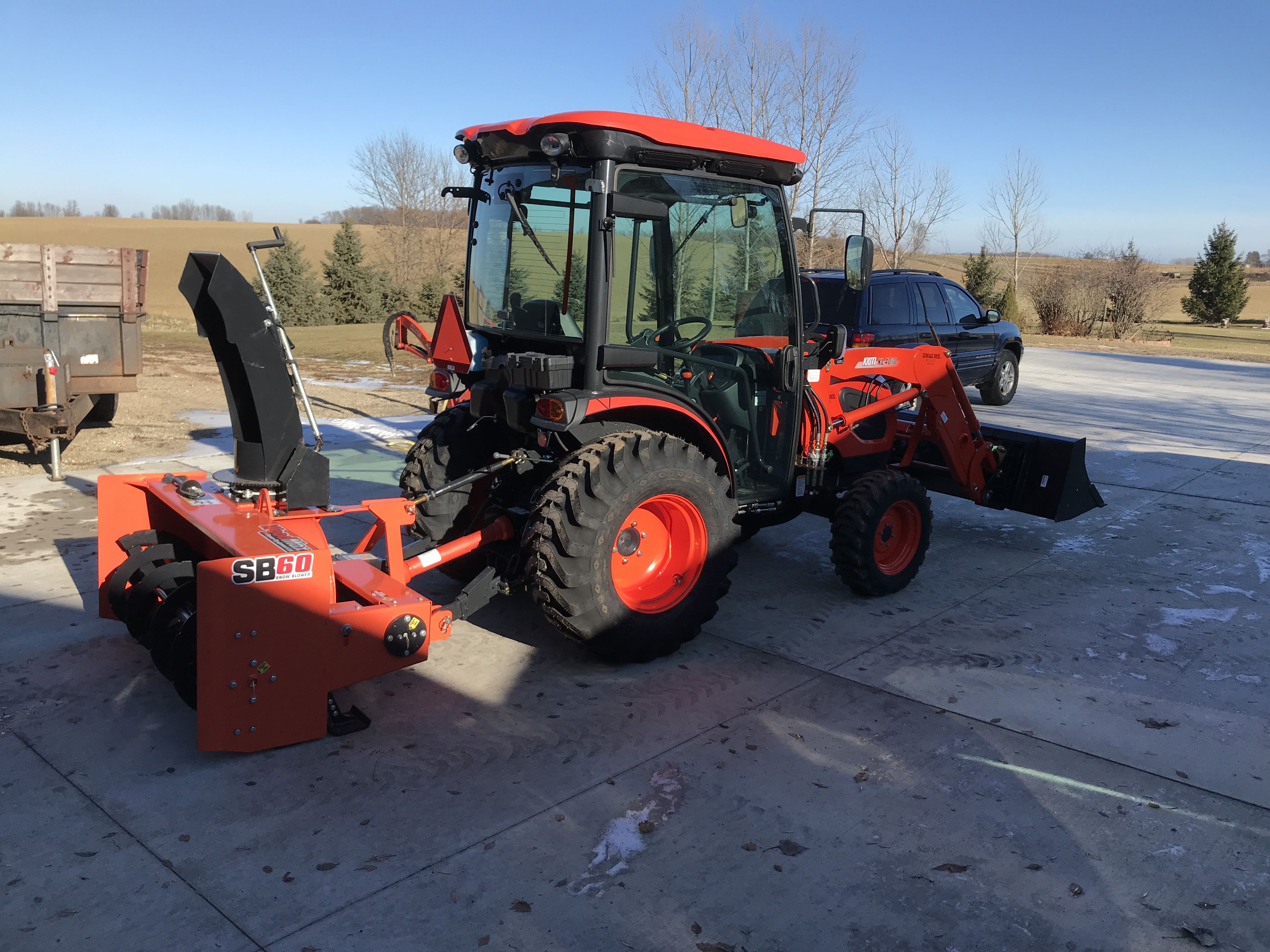

I just purchased a new CK3510 CHSE cab tractor. There is no parking brake light when I set the brake. The dealer told me that it is not an option on this model. My 2006 CK20 HST has a parking brake light, and that is a bare-bones model. Are they feeding me a line of crap? Can I add a switch to the parking brake lever?

Your new CK is already the "loaded" model, so the dealer isn't feeding you a line.
I don't see why you couldn't jury-rig a parking brake switch. But curious why you need one? On mine, the tractor won't start if the brake is off, and won't move if the brake is on. :)

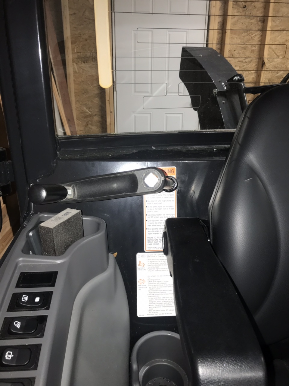

Guys i discussed the lights with my dealer and there is no 4wd or brake light on dash. There is a place for it but no sensors installed. I agree there should be a brake light.

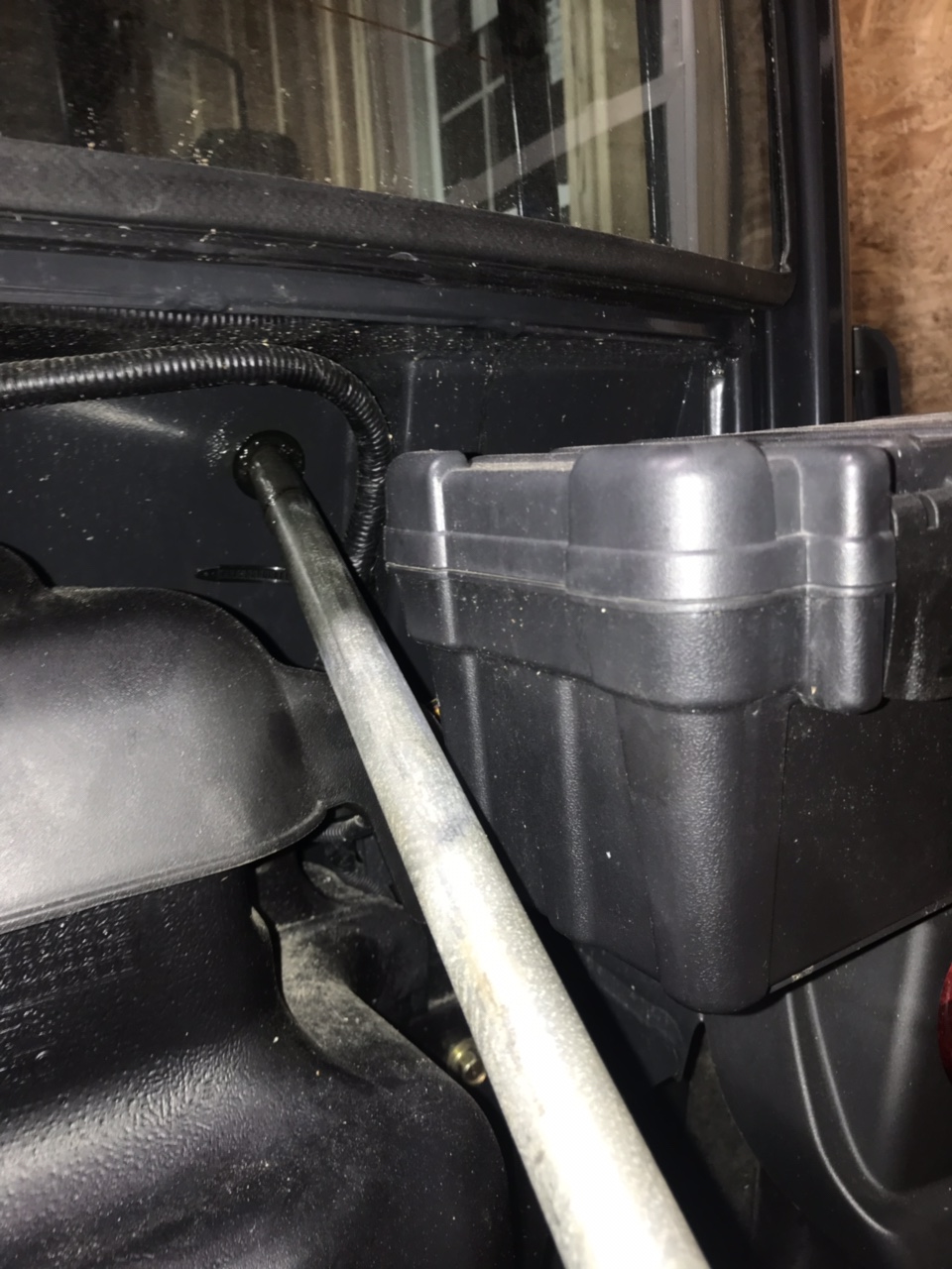

Also to the OP, i have the same snowblower! Great unit. I drilled a 1” hole into the cab and threw a grommet in, sent the manual crank through. I can send a pic or two if you want.

That would be great. I wasnt sure if spending the $475 for the hydro kit was my only option for that blower and my new tractor. Correction....... I DO have a brake (and 4WD) light on the dash. They come on when I turn the key, so they are there. I just need to get a signal to it.

Haha yeah. I figured there was an easier and cheaper way to make it work. Plus i think their manual design is actually really great. Ill snap some pics at some point today and post em up.
/ CK3510CHSE Parking Brake Switch #14
Now putting it where it put it, the crank has full range when blower is up or down, but the only downside is that the armrest has to be up lol.
I used a 1” holesaw and a 1” grommet from this kit 180 Piece Rubber Grommet Kit Assortment - Heavy-Duty Pieces In Different Sizes - For Car Repair, RV Wiring Jobs, Restorations, Boats, Wires, Cables, And Firewall - By Katzco https://www.amazon.com/dp/B01BGZ9WVU/ref=cm_sw_r_cp_api_i_ckdgCbRCV9F5P
You will need to drill out the hole in the grommet to get the shaft through. I used a half inch drill bit and just worked it around. Then lube it up with fluid film and youre off to the races!
Hope it works out for ya!
