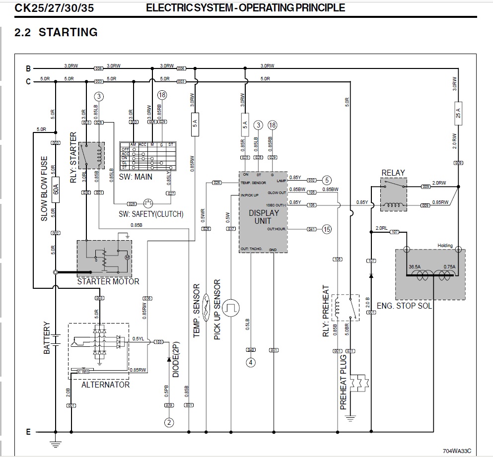

Similar problem has been reported here and it turned out to be the the stop solenoid relay vs the actual solenoid.
The "hold" coil is powered directly from the key switch. The "pull" coil is powered through a relay on the "firewall" and that relay is energized for about one second by a pulse from the "display unit."
Based on reports here, the relay is the most likely culprit. The stop solenoid and display unit are unique Kioti parts but the relay is a common automotive relay available at car parts places, like Autozone, Oreillys, etc.
You can easily test the relay. There should be two identical relays on the firewall: one for the starter and one for the stop solenoid. If you swap connectors on these two relays (and the SS relay is bad) you should hear the distinctive SS "clack" when you turn the key but the starter probably won't crank. If that's what happens, get a new relay locally (not expensive) or from a dealer (should be free). If swapping connectors doesn't "fix" the SS (and probably break the starter), it's time to get out the volt meter and systematically trace the problem. The schematic should look something like this:

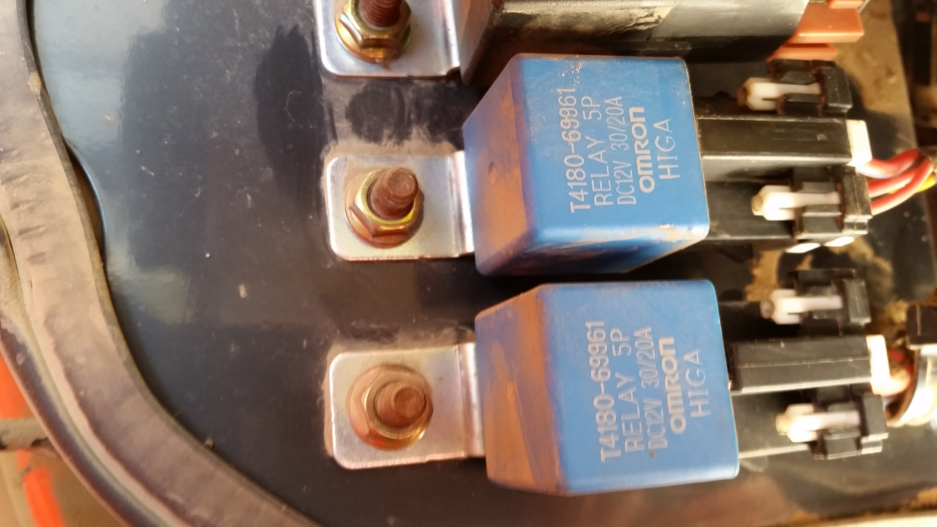

That's not an exact match for my machine; it uses a 30/20 Amp, 5 pin version.

Take the bad one with you to the auto parts store to be sure the connector will fit. Going to a higher amp rating (e.g. 40 or 50) is fine and may make the part last longer. But don't go to a lower amp rating (lower than 30). The SS pull coil draws 26 amp, as I recall. The stock relay 30/20 rating means the normally-open contacts are rated for 30 amp; those are the ones that feed the SS. The normally-closed contacts (not used in this case) are rated for 20 amps.
There are three of these relays. The two identical ones power the starter solenoid and the SS. The odd one (with higher 60 amp rating) feeds the glow plugs. For some unknown reason, at least one other owner who switched connectors reported that the relay that wouldn't pull the SS still worked fine for the starter. But that may not last. If it were me, I'd replace a marginal or unreliable relay while I'm thinking about it.
ADDED: This being the second such report (swapping connectors fixed no-crank or no SS retract) I wonder if the problem could be high resistance at the connector (from dirt, grease, corrosion, etc.) that got polished by removing and reconnecting the connectors?
