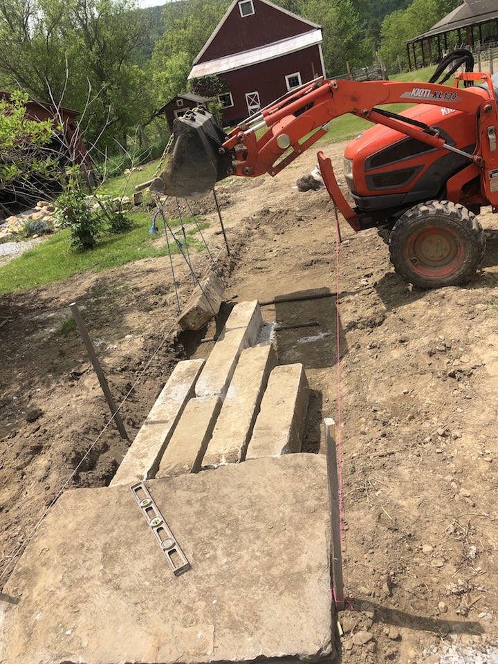

Hi folks:
My 2008 CK 30 with 760 hours is having trouble lifting a pallet of firewood. This is a task that it used to do routinely with ease. The loader can still lift two 12-14 foot logs (must weigh 200-300 lbs total). It can also raise and lower through the complete range of motion.
regards,
DOC
Another thing to keep in mind is, logs roll to the back of the forks, the pallet spreads the load out to the end of the forks, where your tractor has LESS lifting power.
SO, it will pick up heavier logs than it will lift a pallet of wood.
SR

It wouldn’t take much of a pallet of firewood to overwhelm the 1500 pound rated loader and anything I’d consider a log would weigh way more than 150 pounds in a 14’ chunk but he did say the loader would lift it before.

Folks:
Many thanks for all of the advice. I did the leak test and it was fine!
Therefore, I did a little experiment today and I have to admit I am red faced with embarrassment. Over the past couple of years my firewood logs were mostly: box elder, maple, white birch and beech.
I changed suppliers and this year my firewood log pile is made up of mostly black, white and green ash, some cherry, maple and oak. I checked the relative weights of the various species and you guessed it: a full pallet of the wood I am cutting this year weighs about 25-30% MORE than what I was moving last year.
No wonder the tractor can't handle a full pallet. I feel like a dumb *****! for troubling you all.
