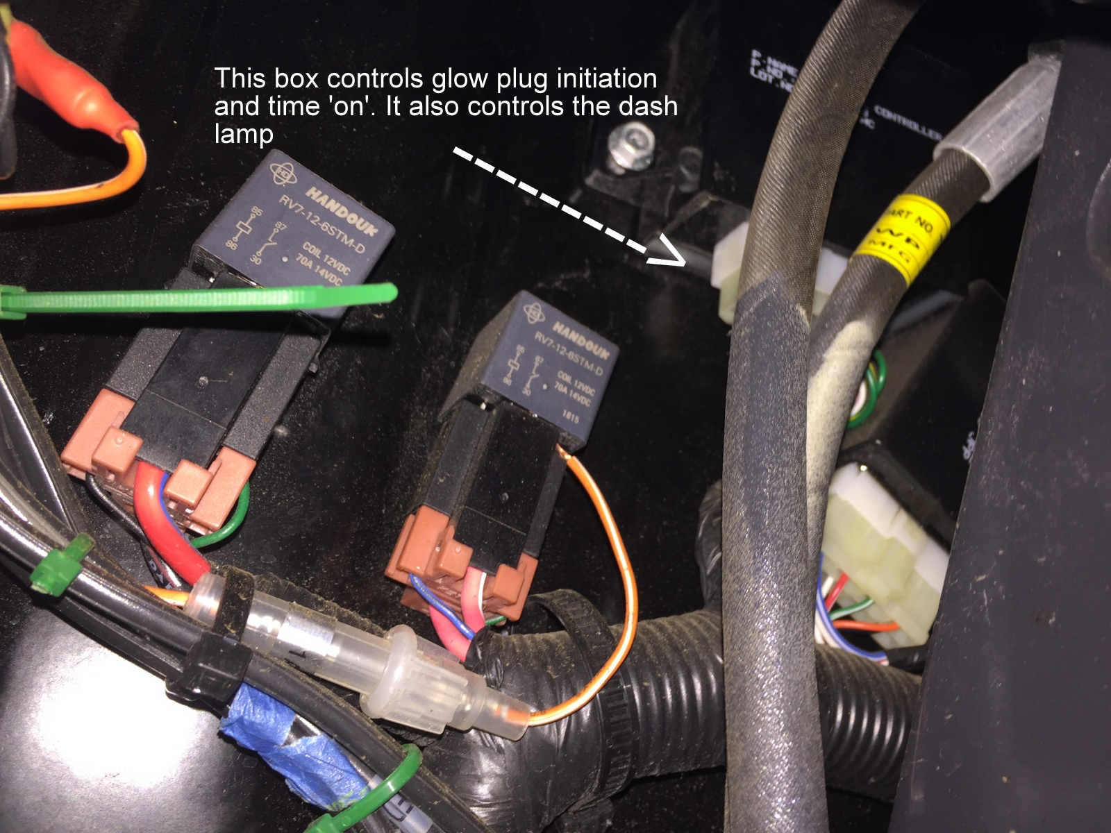

Is your dealer local to fix it?
Looking at the schematic, I do not see how the glow plug relay would affect the light indication on the dash, but maybe it's internal to the Preheater Controller seeing current flow to the glow plug relay coil. I would look above the glow plug relay (it's the one in photo with large red wire), located as stated on the left side just above the clutch pedal. I was going to say check that the connector shown is fully engaged, BUT it also controls fuel related components, so the tractor would not run.
I do love Kioti documentation- on page 12-71 they call the box 'Preheat Controller', then on page 12-73 it is now called the 'Safety Controller'. The box is making sure the coolant is less than 20 C/ 68 F to initiate the glow plug energization by picking up the glow plug relay via pin 12, and turns on the dash light via connector pin 11.
Seems like the box is working functionally on everything else, just not the glow plug light. I would check that the temperature sensor is fully connected (appears to be a three wire connector) but haven't a clue where it is. In the factory service manual page 12-11 it shows it on the block just above the alternator as posted above, but mine only has a allan type plug installed there. Gotta love it!!
For what it's worth, Toukow

Didn't mean to submit the above post, but oh, well.....I would do a quick check and put a finger on the glow plug relay and see if it clicks when turning the key on and temperature below 68 degrees indicating a light LED issue. Oh, I did find the temperature sender and it's located just underneath where the top radiator hose connects to the engine, on the right side of the block. Good hunting.....
