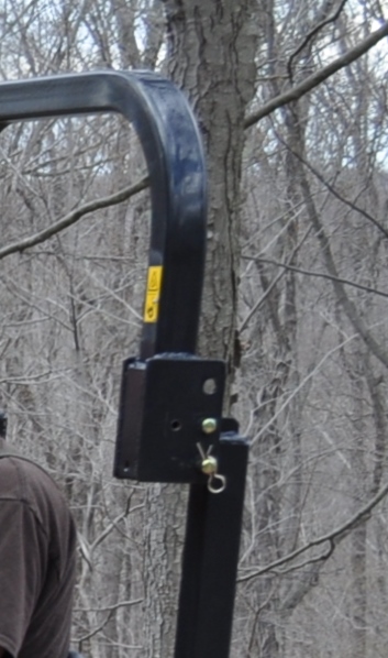

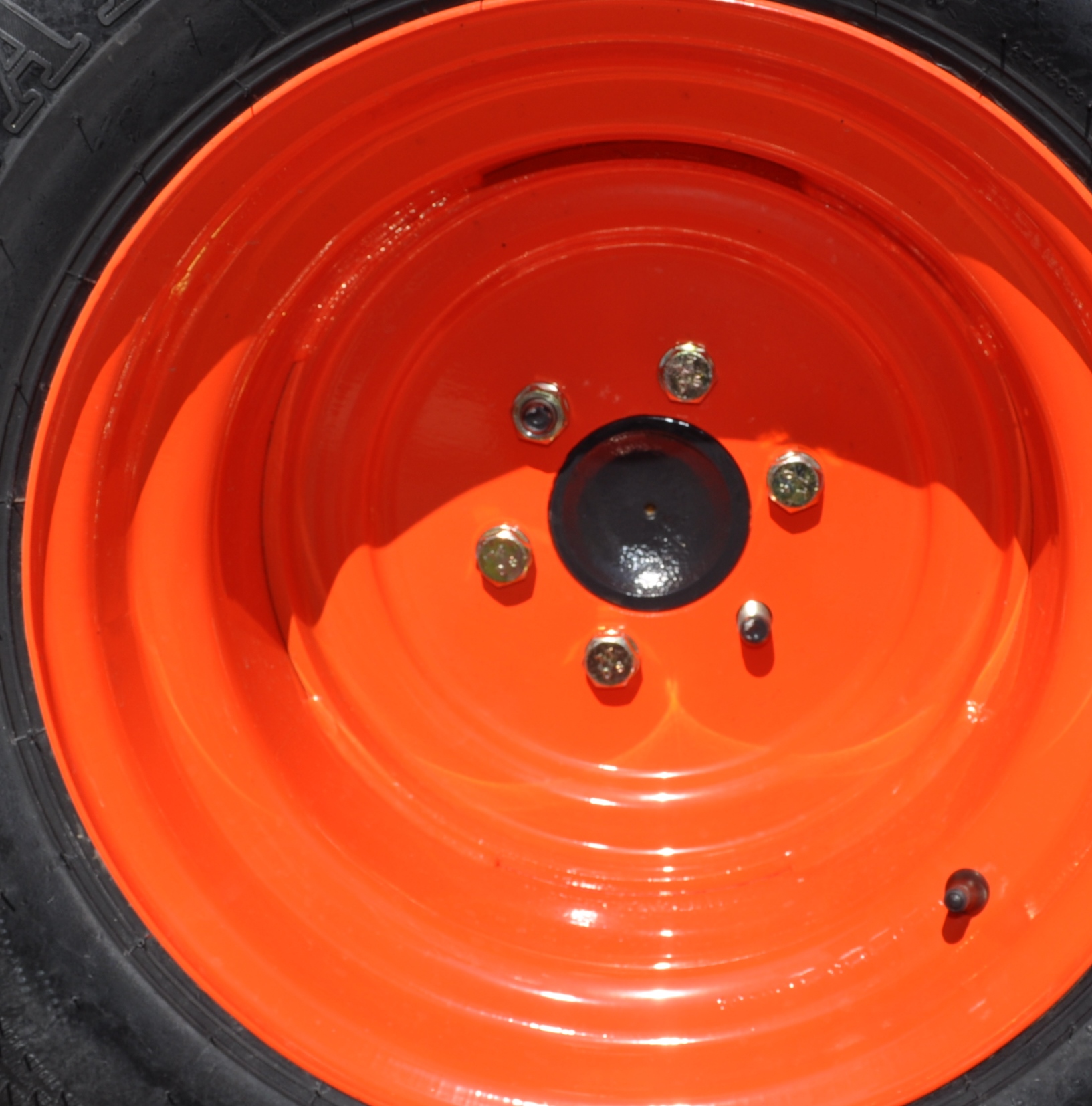

This shows the ROPS mounted backwards and the missing lug nut. The ROPS top was backwards and they had the posts on the wrong sides so when it folded down it covered the drivers seat.
I found the stripped bolts when I went to rotate the ROPS, which I thought was going to be an easy fix. The missing draw bar, wires mis-routed etc are minor matters. My biggest concern is if you can't do the ROPS installation correctly, how could they tackle some thing complicated like attaching a FEL and Backhoe and rear remote valve.

View attachment 374844View attachment 374845

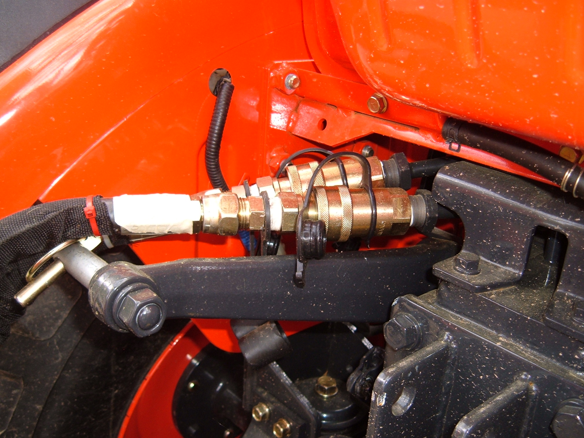

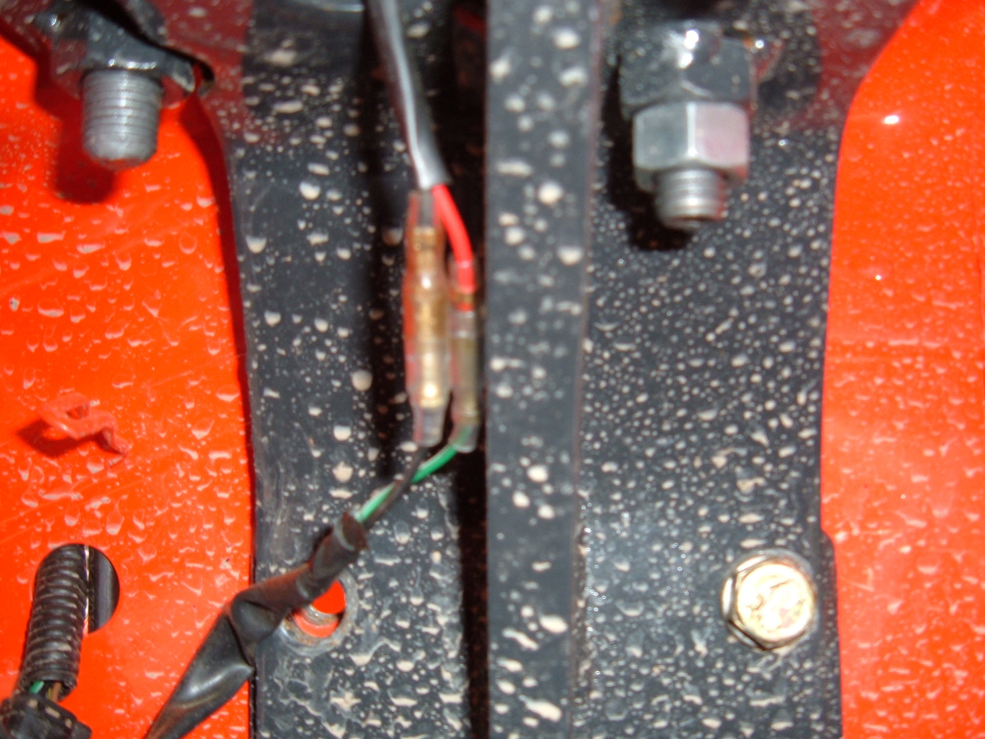

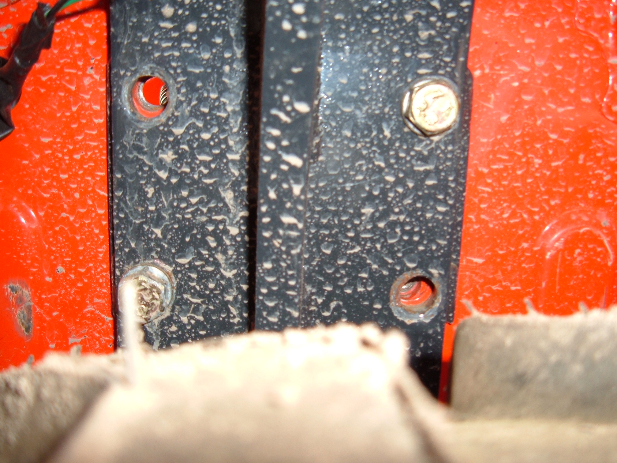

Melissa Waters is the CS Rep/Supervisor. She finally got back to me ... no help yet. SO I forwarded my complaint to the CEO's assistant. I'll post pics. The BH lines touch the 3pt hitch arms. If I accidentally move the 3pt hitch lever I think they'd rupture. I sent these pics to the CEO.Hoses hit 3pt hitch arm.JPGTwo missing bolts.JPGMissing bolt & stripped bolt.JPG
I just heard back. The e-mail and photos might have lit the fire. She is promising a reply from the Regional Manager w/in 24 hrs.
