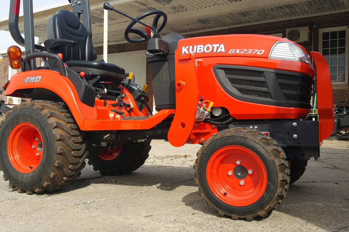

We just installed this loader on Rick's BX2370 Kubota tractor and I decided to take some pics and add it to the website with a quite attractive price, which includes free shipping to a business or freight terminal within 1,000 miles of Newton, NC.

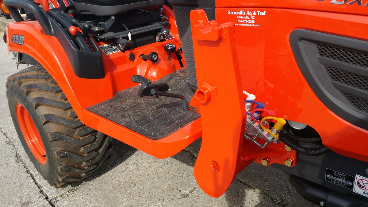

These BX tractors come "loader ready" from the factory, so adding the loader is extremely simple.

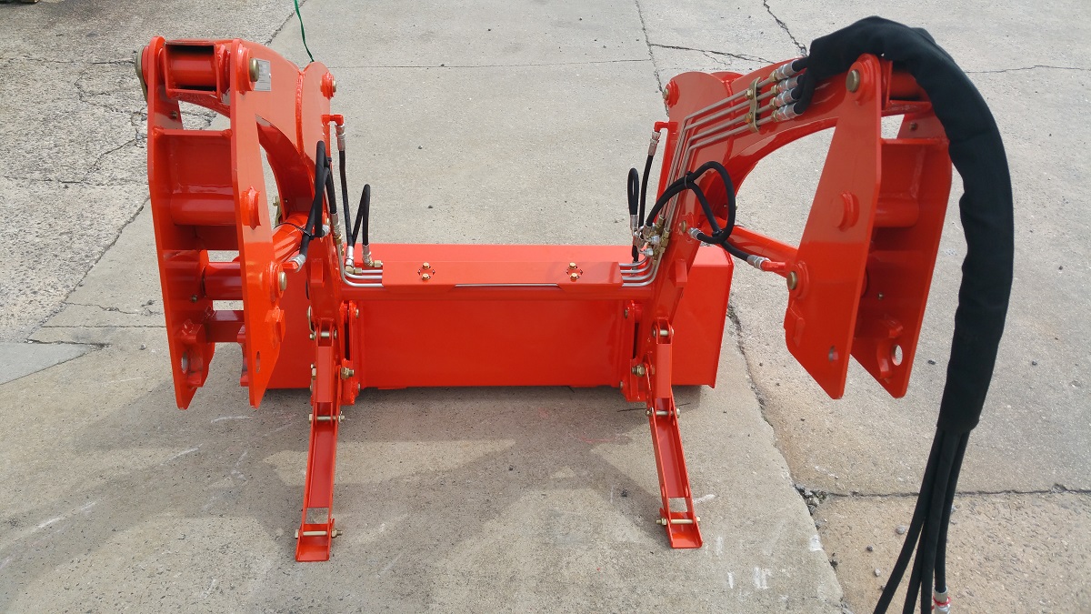

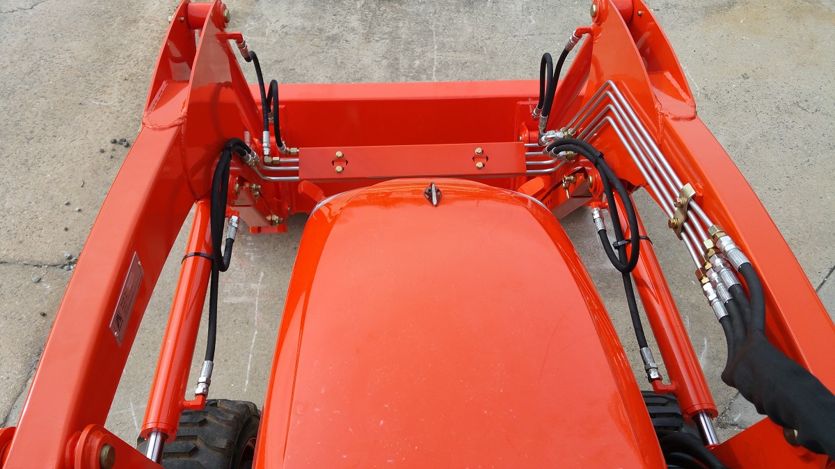

This loader features dual curl cylinders, which is a very desirable feature not found on factory Kubota BX loaders.
When I say "we" installed the loader, I mean Rick(in sales):

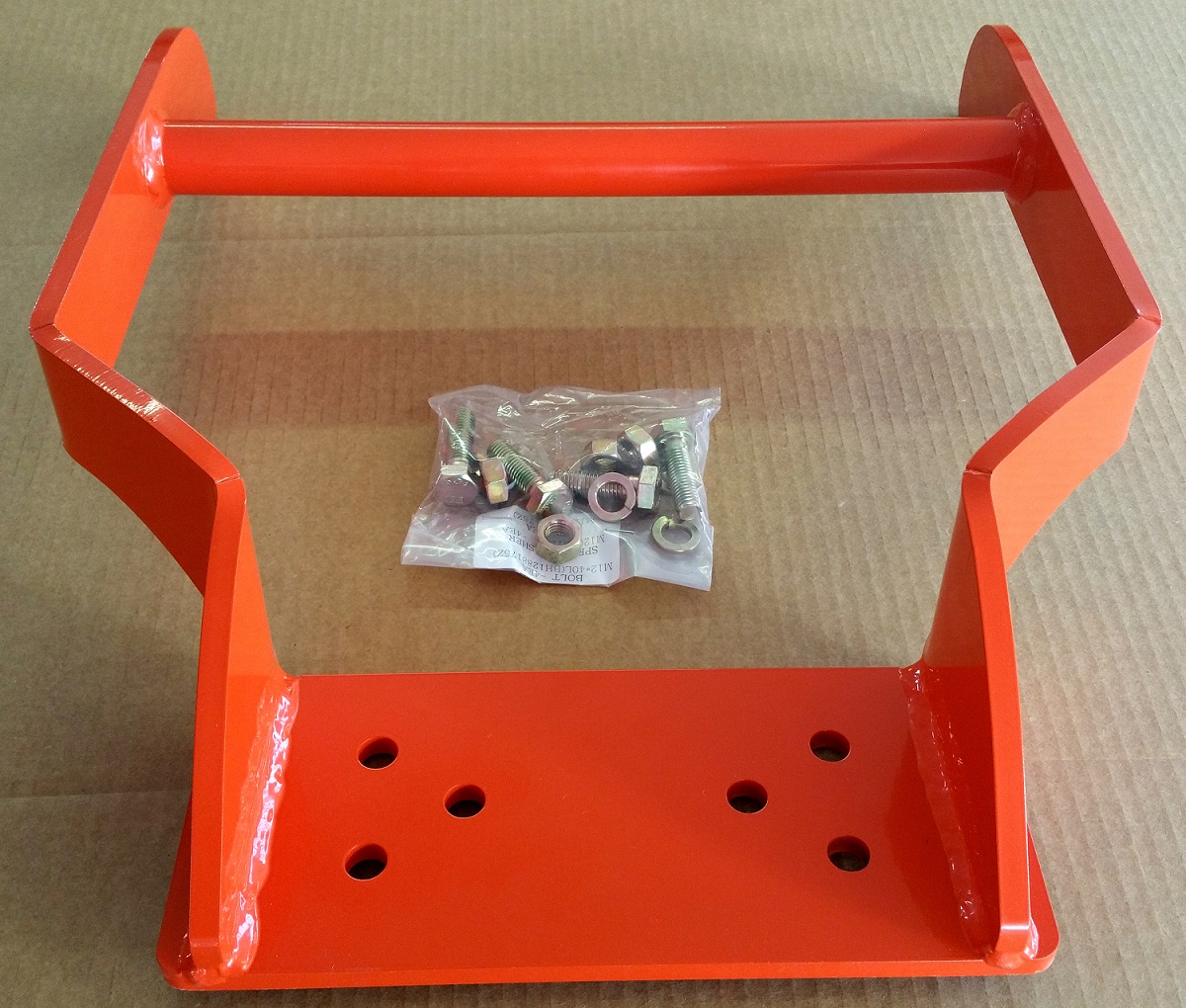

Bolted the included loader mounts to the frame, which are attached by 5 bolts on each side of the tractor.

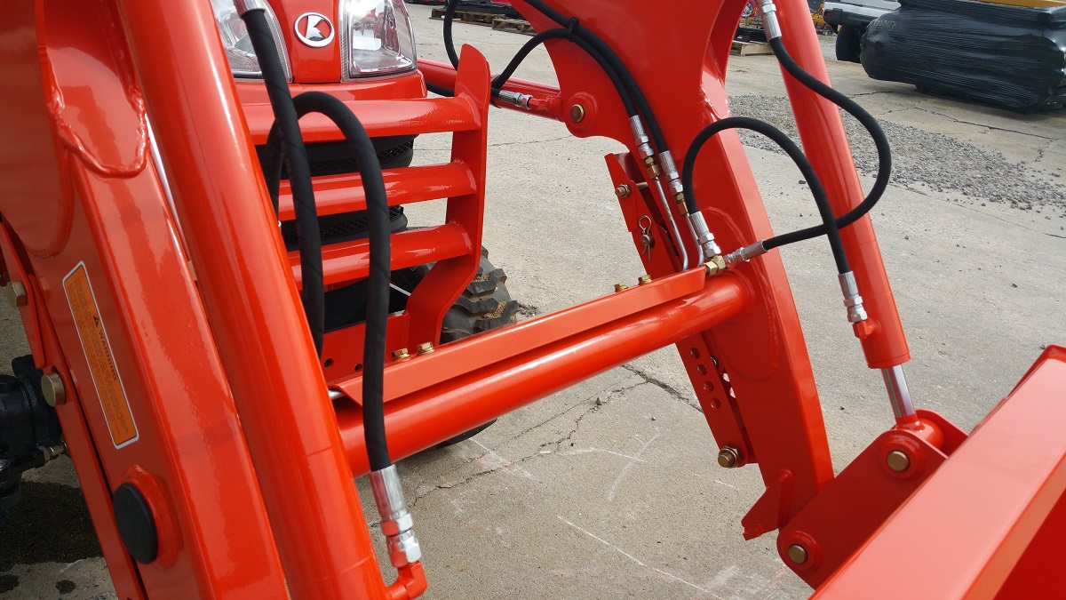

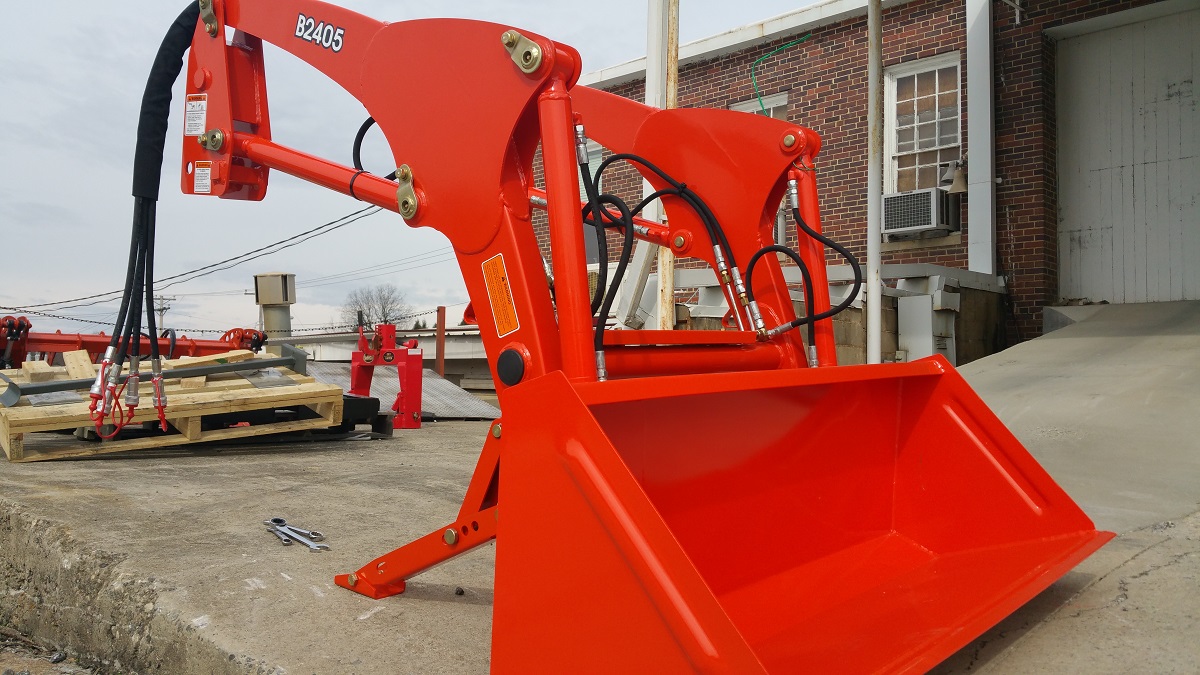

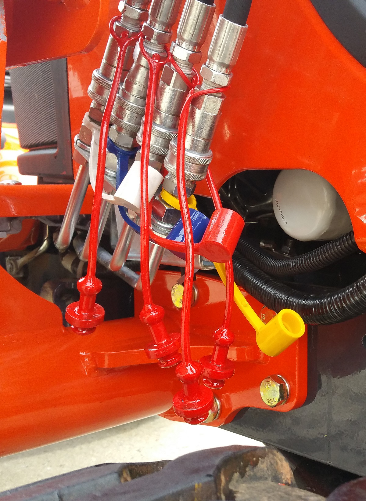

Unstrapped it from the crate, which you can see in the background, and installed the 4 long hoses(used thread sealer tape) you can see hanging down(red caps on the ends).

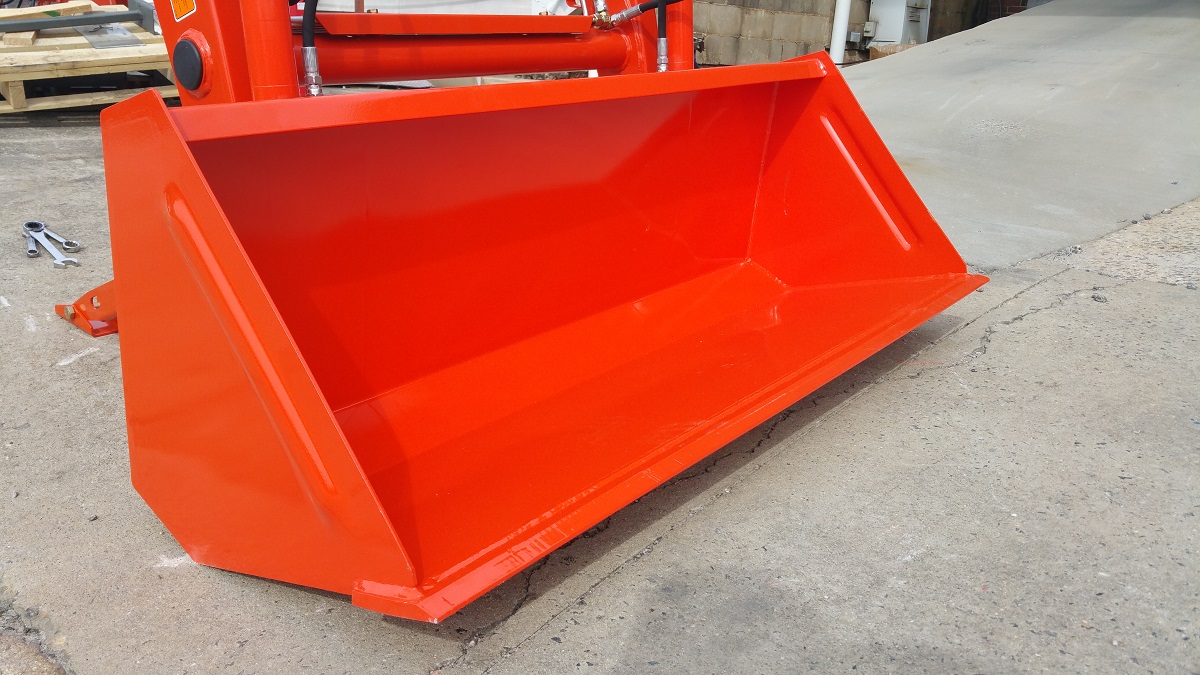

Me and another guy helped him flip the loader over so it rested on the stands, and line up the included 50" bucket, which attaches with four pins.
Now it was time to attach the 4 hoses to the tractor's existing hard lines, which run from the loader valve. As simple as attaching air lines. First, we depressurized the system(Ted video).
With those attached, you can move the joystick around, which will result in the cylinders extending and retracting for lining up the mounts.
Once the mounts are lined up, we installed one pin in either side, folded up the stands and pinned them in place.
Looking it in the eye. A grille guard is also included, but he left on the factory one, which still works fine with no interference.
This is the guard which comes with the loader.

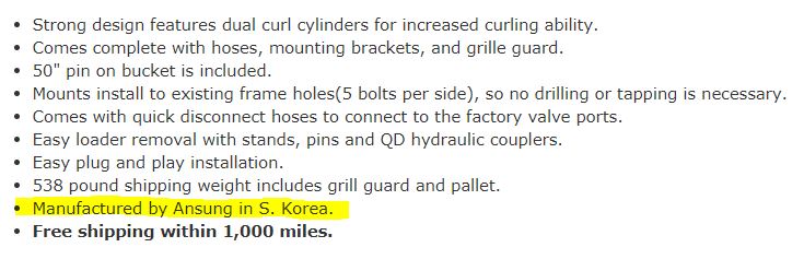

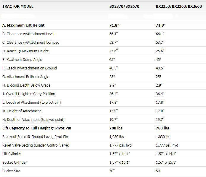

Here are the detailed specs. The loader's shipping weight, including the grille guard and pallet, is 538 pounds.

Thanks, Jeff. We had a truckload of tillers coming, so the loader rode along for Rick's tractor. We hadn't really planned to add it to the website, but, after seeing it, I thought why not.
It is an extremely nice loader and the price is very affordable. It is made by Ansung in S. Korea, as shown on the page I linked above.
