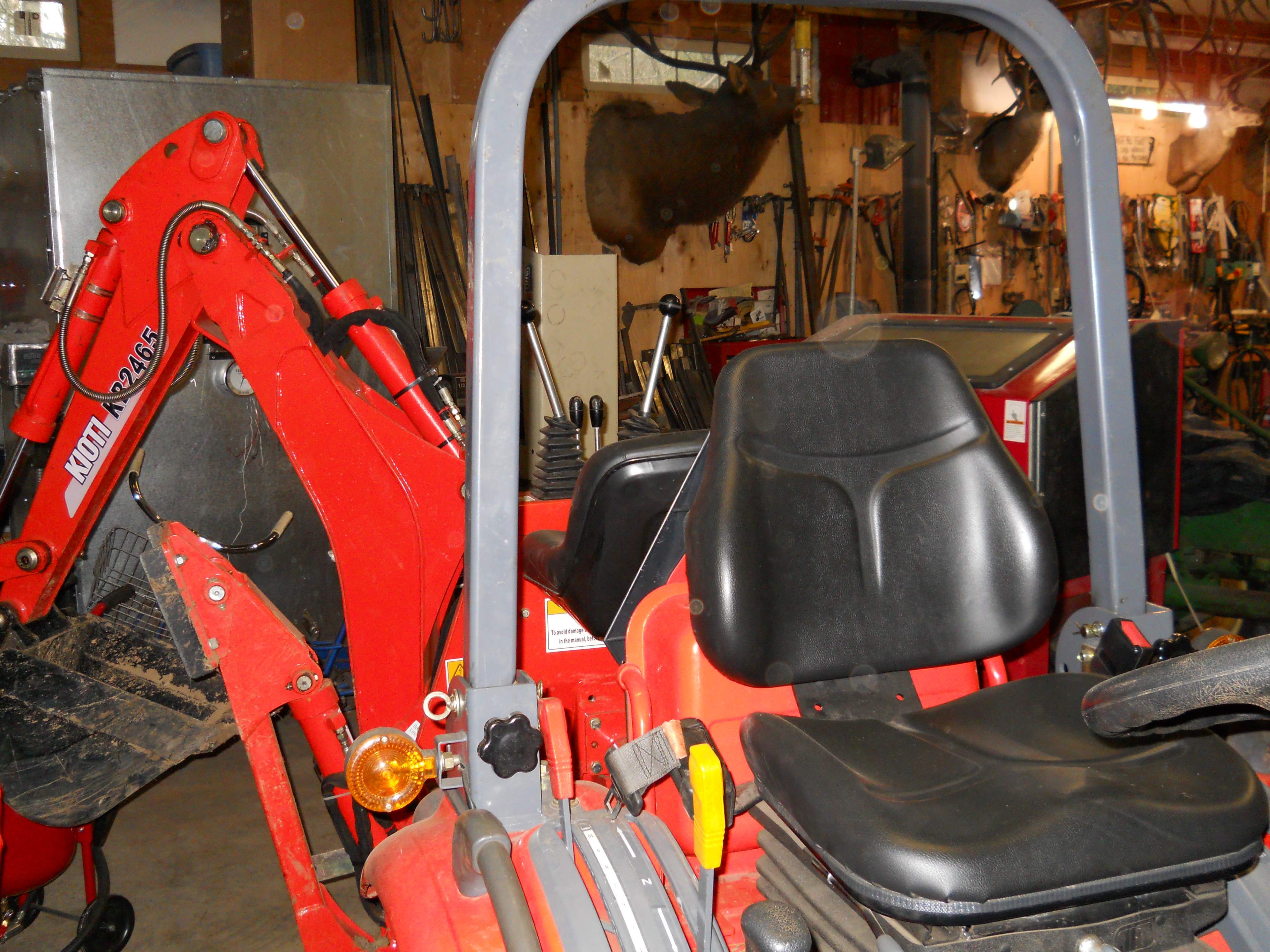

jlsanborn, Heres a picture of my coolant heater, as you can see it is at a right angle and fits nicely. I also cut about 8 inchs out of the roll bar so it will go under my apple trees without having to fold it down all the time. Fred

Thank you! That's EXACTLY what I was hoping for! I'll get one headed my way tomorrow. I guess I'll ask the seller, but do you know if he ditched the OEM hose and just used a couple bits of straight hose, or was he able to cut the heater into the OEM hose?

Nice job on the ROPS. I'm sure there's some 'figurin' in the height they choose, but it would seem that you've made it a bit stouter and a little more low profile. I've already gotten my rear chewed by the "girl" in the house for busting branches off the pine in front of the wood shed and I can't believe I haven't pulled out my shop door yet. I'm not planning on using that thing for its intended purpose, so I may consider snitching a little off the bottom too.
