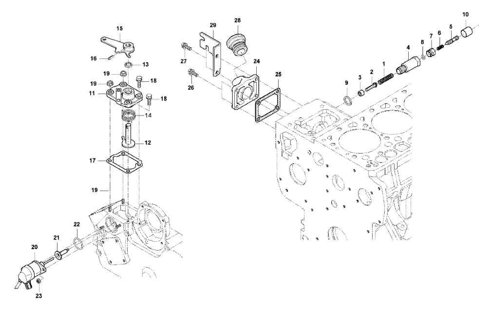

My solenoid looks like it is working fine. I can visually see it open and close. It goes to open after a few seconds after I turn the switch off. Is there a better way to test this? Bearhawk comments make me question if it is really working now.
Sounds like you are getting fuel. If you remove the lines at the injectors and crank it, you just get a little squirt of fuel, nothing impressive.
