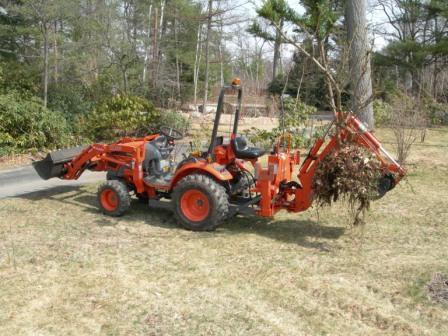

I'm finding this discussion as useful as usual for this group - combining guidance and moral support.
I drive the BH pretty hard (though never above 2000 RPM - that's already a lot of power!), and generally press down the stabilizers about enough to raise the wheels by half an inch an inch or so. So the tires aren't anywhere near off the ground, just unloaded by a few hundred pounds. This lets me use the parking brake to hold against dragging, while making the whole thing more stable. I've never actually lifted the rear wheels; seems unnecessary and risky for the machine.
Now if I could just figure out why the loader creaks so much since the dealer's first 50-hour service. he says it's OK, so I hope that if anything breaks, it happens w/in warranty.
On a slightly related topic, what do people do for grease guns? I had to bend the end of mine to reach the lower BH swing pivot zerk. Seems like there ought to be a more elegant solution.
Thanks as always-
Chelydra
(Attached pic is a 200-lb yew getting a ride to a new location. Bit tippy unless I load a log or some dirt up front, but minimizes handling so best for rootlets.)
