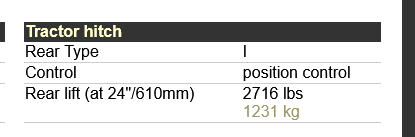

I worry about bit about these published specs, not sure how accurate they are. For example the CX2510 claims 24.5hp at the PTO, from a 24.8hp engine. That's not correct. I picked that one up because the dealer was offering an ex-rental CX, and that was the figure he had.
And now I see the DK supposedly lifts more at 24" from the pins, than at the pins themselves..
For the CK those figures are 1130, 1030 and 740 (kg)
/ CK series vs DK #18
Tractordata.com lists the DK rear lift specs at 1231 kg.
