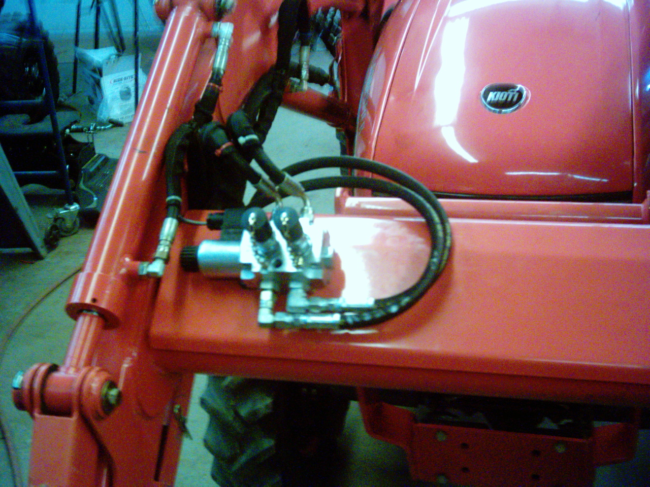

Update: As of today my tractor is now working good. Dealer road service did come and check it out, happened to be a bad relief valve. Anyhow i'm glad my tractor is fixed:):thumbsup: Also had this installed on my tractor, now just have to buy/make something to use it for:laughing:

Glad you got things straightened out. I'm sure you will find a few things to plug into your new hydraulics on the loader. :laughing: :thumbsup: ;)
