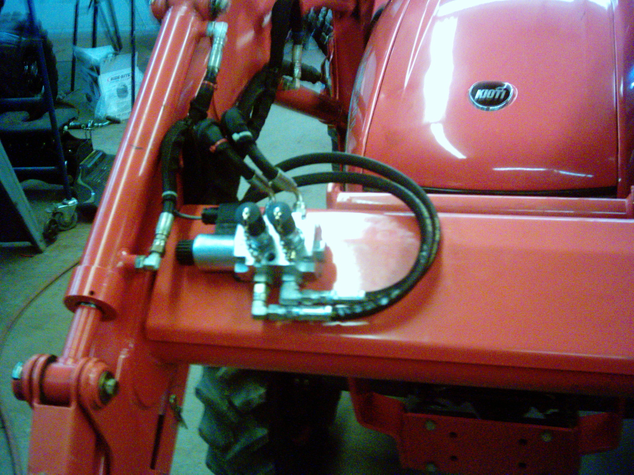

When was the last time you had the fluid and filter changed?
I would start by replacing the filters. Maybe even the oil if its not a good quality oil.
Last maintenance was 200hr engine oil and filter and fuel filter, 50hr service everything was flushed and all filters replaced including fuel filter. Hydraulic oil is shell donax TD, all kioti filters. If this could be a cause of my problem, why didn't the dealer ask me about the last maintenace:confused: I have all the filters and oil for a complete flush, but if this doesn't change anything it's 300$ down the drain.:(

Is the backhoe still on the machine or have you taken it off?
/ CK 30 Hydraulic problem
#15
The BH is still on the tractor, have disconnected the BH hoses but no difference, i think the problem is on the tractor. The BH is only 3 weeks old, as of today 15hrs on it.
/ CK 30 Hydraulic problem #16
I check the pressure at the rear remote A outlet. This is where the dealer says to check it.
Also i either use the BH or the loader, never both at the same time, and shut the rear remote in the neutre position whenever i don't use the BH even when repositioning the tractor.
The pressure is 2700psi hot/cold, and holds for a few secounds, then drops to 2200-2500psi when the relief valve opens, and raises to 2600-2700psi once the valve closes.
That's interesting. Do you know your hyd pressure is about 150psi higher
than spec?
Your tractor has only one relief valve, and it's on the FEL valve, under the
right floorboard. (The hoe has one, too, but you said you removed it.)
Take it out and get a good look at it...it is very easy. You might also
turn out the adjuster a bit to get back to spec.
If you touch it when doing your pressure test, you will prob feel some
serious vibration when it opens. Is it constant?
than spec?
right floorboard. (The hoe has one, too, but your said you removed it.)
turn in the adjuster a bit to get back to spec.
Thanks for the info, I will adjuste the pressure to spec, funning thing is. the dealer did ajuste it to what it is when doing the 50hr service:confused: I have the workshop manual so i should be able to do this:D
Anytime the hydralics are working hard ie; lifting a bucket of gravel, excavating, i can feel and hear the vibration on the tube that goes from the pump to the valve. When the valve opens its only worst:( feels like something gonna fly out of somewhere:laughing:

Check your diverter valve under right side fender.....make sure it is all the way open or shut (don't recall which way for BH use)
