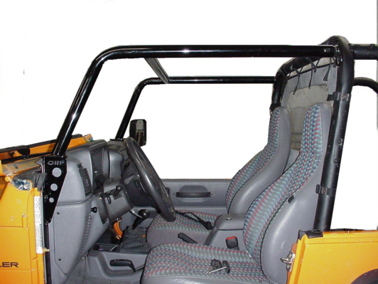

Robert, I didn't write it right. It should not anchor to the windshield but to the cowl - like OR FAB

I think a buddy of mine put something similar in his Wrangler. I think it still has some square tube or somethingthat ties it to the floor and frame.
I grew up in MB's and CJ2a's, then had short fender(pre '72) CJ5's. They had no room to begin with; add a cage kit, and getting in/out was even more fun :D These CJ7's and Wranglers have miles of room in them :D
   / CJ7 rear ended #34
I looked at their website. I'm not my friends kit is the same brand, but it is very very similar if not.
He has the complete floor tie kit, the dash bar, and a couple of streamers as they call them. He mad an overhead CB radio mount on the streamers. He also added some support in the back roll bar area; he has a 5 and 7 year old so wanted more protection for them. I do not see those bars on the website.
It was all clamp-on too, so he didn't have to weld on his ROPS, uh, I mean rollbar. They do make the precut weld in stuff too though. The clamp on stuff was nice, not because of any affect it might have welding on the ROPS/rollbar, but because these newer Jeeps have so much carpet, padding, plastic consoles etc that the older rigs did not. Hard to weld in them without splatter/slag ect leaving marks all over.
He has a hard top and soft top; this type kit lets you roll down the manual windows without making shorty window handles too.

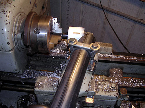

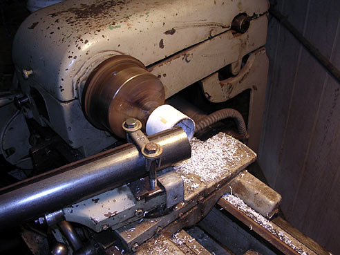

Notching tubing, works like a charm. Was lucky to find plastic tube of the same diameter to test every cut first.
And yes, it is an exhaust clamp.

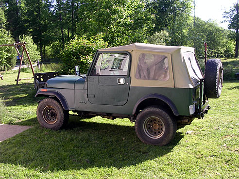

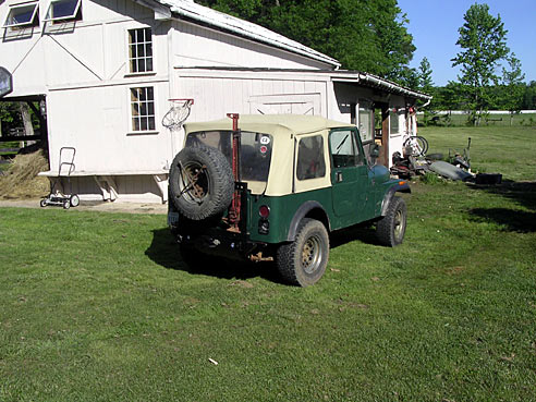

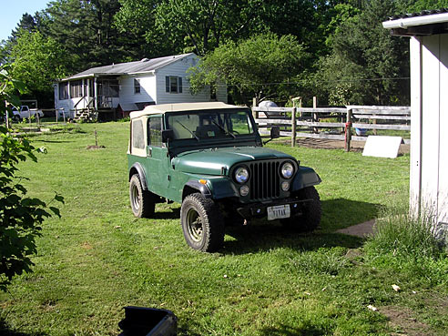

I would like to call it done, but there are still few problems with the electricity. Like back up lights and that d@mn fuse that keeps burning, not sure why.
But the jeep is driveable and driven daily.
