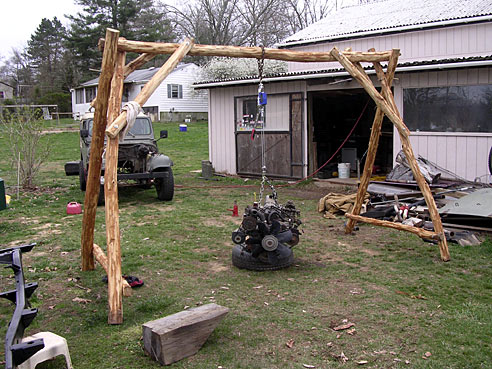

Well thank you:) It's made from oak and it is gonna be a swing for the lady - not like she needs one to hold 500+ pounds, but that way it will be part of the landscape and I nuse it for hoisting when there is a need :D

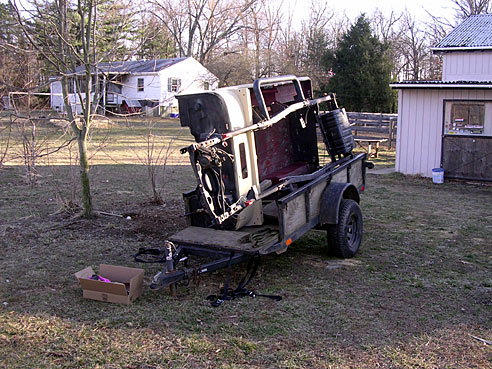

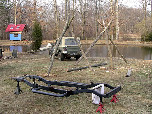

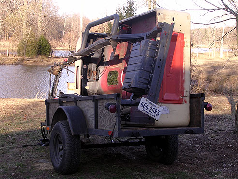

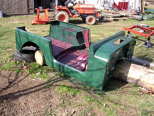

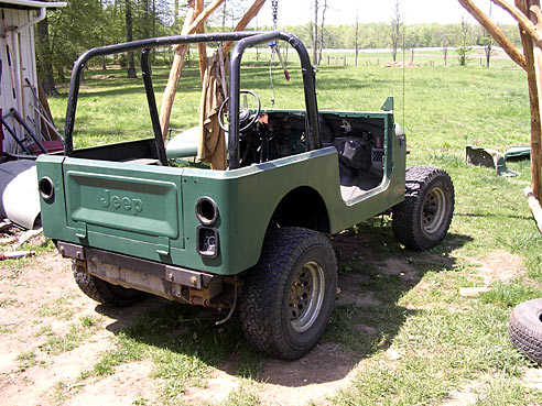

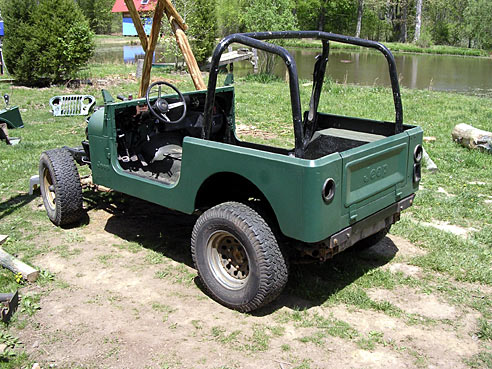

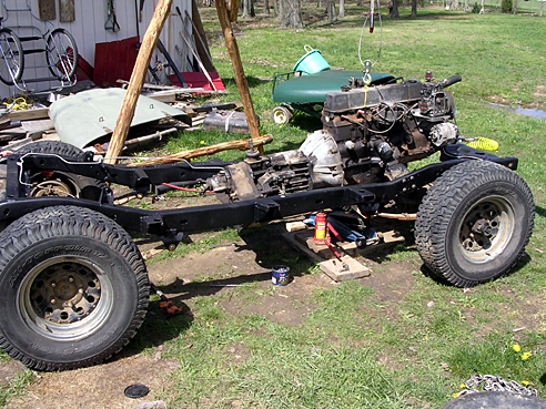

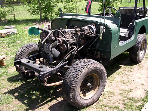

I feel lazy to slave on it - posting pictures is work too, right?
I spent 4 hours yesterday putting the steering column together. It had play and I couldn't get it right. It was an upside down washer, talk about stupid:)

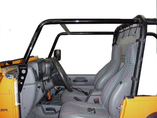

While you have plenty of room to work, now would be a nice time to weld on that ROPS for more protection in the driver area. OOPS! I mean, weld in a full front cage kit on that rollbar. Maybe add an additional horizontal support to the top/back of the rear rollbar for more support for backseat passengers.
When we had Jeeps, the first thing we usually did was weld in a front cage kit to the ROPS, uh, I mean rollbar.
Dadgummit, I can hear the ROPS police circling in their black helicopter already...

I am toying with the cage for a while. I would anchor it to the dash, being bit overgrown, I really don't need any restrictions in the door.
But I don't really wheel it, it is more daily driver and hunting truck to get me where I need no matter what the weather sends our way.

I like the cage to go to the floor, so it can tie to the frame. The back rollbar has more tie points to spread more stress across the body, where as the front cage bolted to the body usually only has one small mount point with a couple bolts in it.
It's a lot more protection that just a windshield frame no matter which way it is done.
All the Jeeps I(or my Dad) had, had cages, as do friends. I feel naked without them :eek:

Robert, I didn't write it right. It should not anchor to the windshield but to the cowl - like OR FAB

I think a buddy of mine put something similar in his Wrangler. I think it still has some square tube or somethingthat ties it to the floor and frame.
I grew up in MB's and CJ2a's, then had short fender(pre '72) CJ5's. They had no room to begin with; add a cage kit, and getting in/out was even more fun :D These CJ7's and Wranglers have miles of room in them :D
/ CJ7 rear ended #34
I looked at their website. I'm not my friends kit is the same brand, but it is very very similar if not.
He has the complete floor tie kit, the dash bar, and a couple of streamers as they call them. He mad an overhead CB radio mount on the streamers. He also added some support in the back roll bar area; he has a 5 and 7 year old so wanted more protection for them. I do not see those bars on the website.
It was all clamp-on too, so he didn't have to weld on his ROPS, uh, I mean rollbar. They do make the precut weld in stuff too though. The clamp on stuff was nice, not because of any affect it might have welding on the ROPS/rollbar, but because these newer Jeeps have so much carpet, padding, plastic consoles etc that the older rigs did not. Hard to weld in them without splatter/slag ect leaving marks all over.
He has a hard top and soft top; this type kit lets you roll down the manual windows without making shorty window handles too.

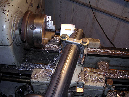

Notching tubing, works like a charm. Was lucky to find plastic tube of the same diameter to test every cut first.
And yes, it is an exhaust clamp.

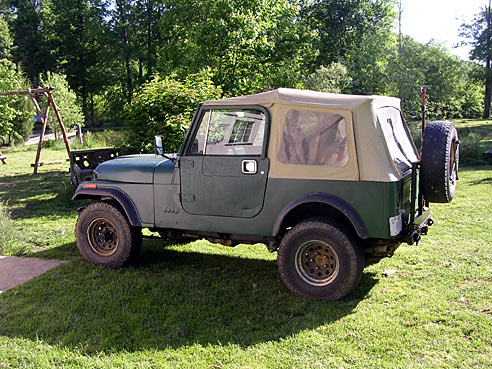

Interesting thing happened. This lady, friend of ours, said she would not trust the jeep since I have it all apart putting it back together. Well, she trusts a cart that some waged labor union worker put together on an assembly line and some other waged guy maintains to keep running. She trusts her life to an airplane maintained by employees and kept in the air by air traffic controllers.
Nothing against wages or labor union, but I think she is bit off:D
/ CJ7 rear ended
#37
I would like to call it done, but there are still few problems with the electricity. Like back up lights and that d@mn fuse that keeps burning, not sure why.
But the jeep is driveable and driven daily.
