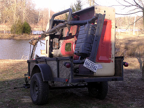

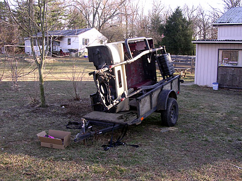

Collecting parts:

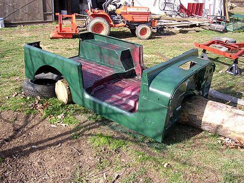

Progress:

Do you have a helper? JC
Buddy of mine will show up when there is a need for second pair of hands - like to position the tub. The rest I can handle with some primitive machines and brutal strength:)
What does shade tree mechanic do when there is no good tree?:D
