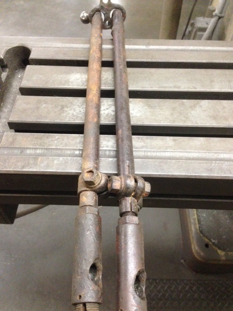

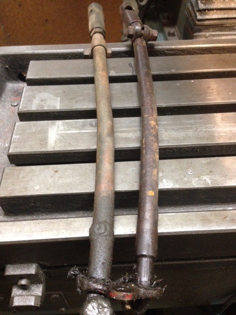

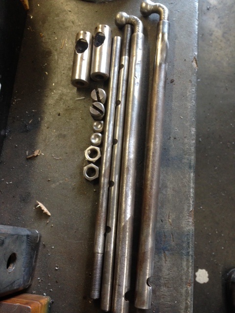

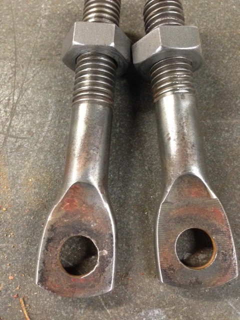

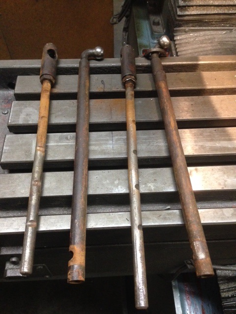

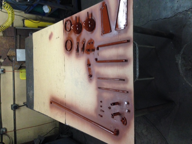

#11
Straightened out the tie rods and fixed all that.

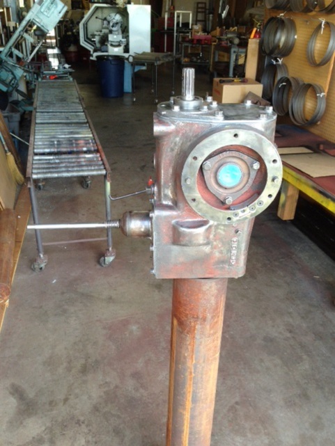

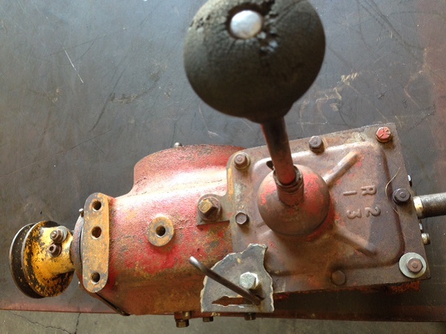

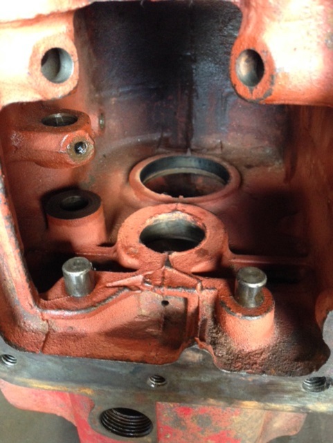

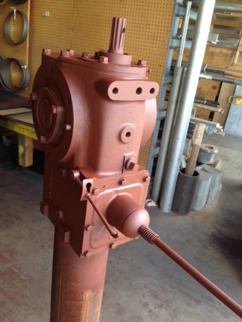

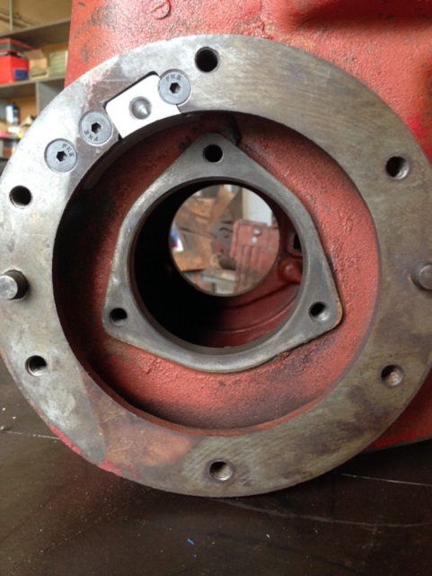

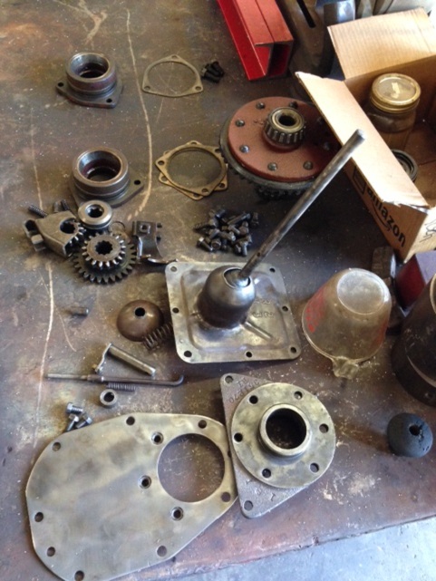

   / Circle Cub (4 digit) Restoration

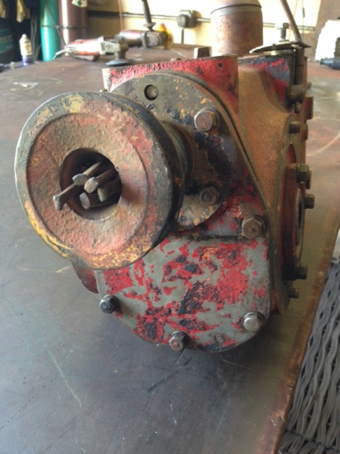

#12
Repaired the transmission and installed new bearings/seals.

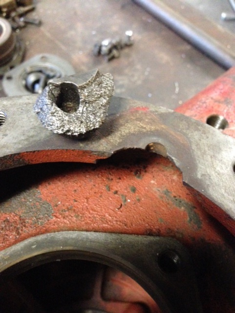

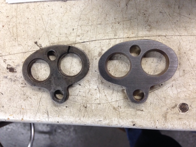

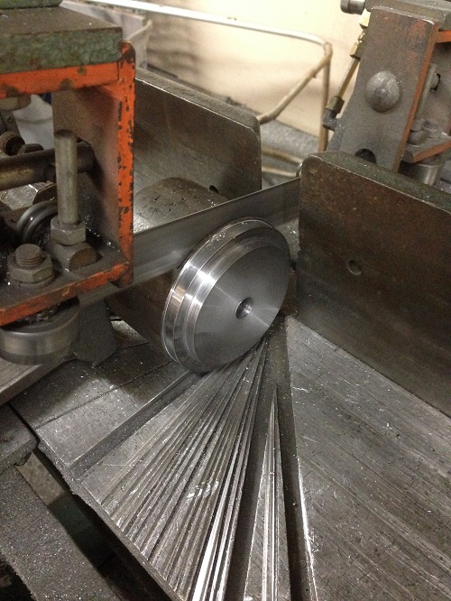

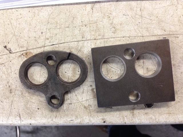

#13
Repaired the oil filter bolt and made a new top for it & added an o-ring for better sealing.

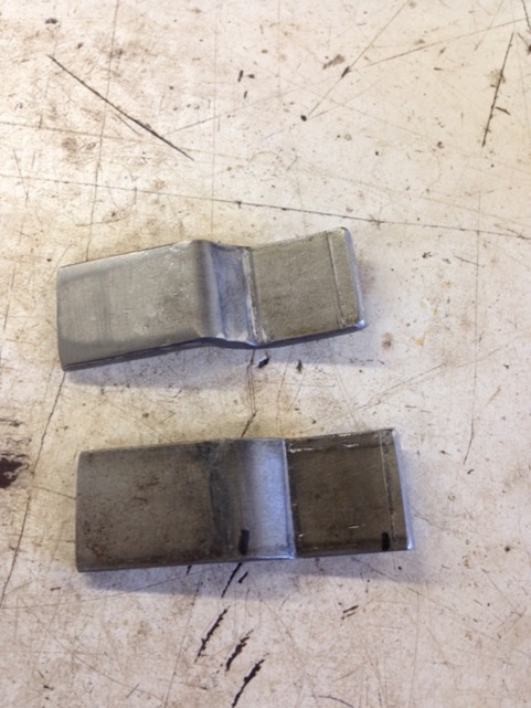

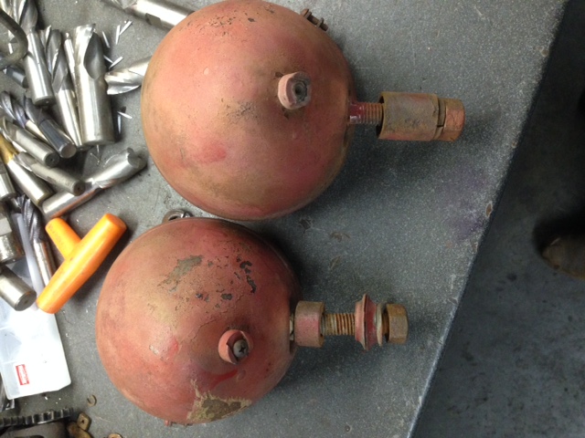

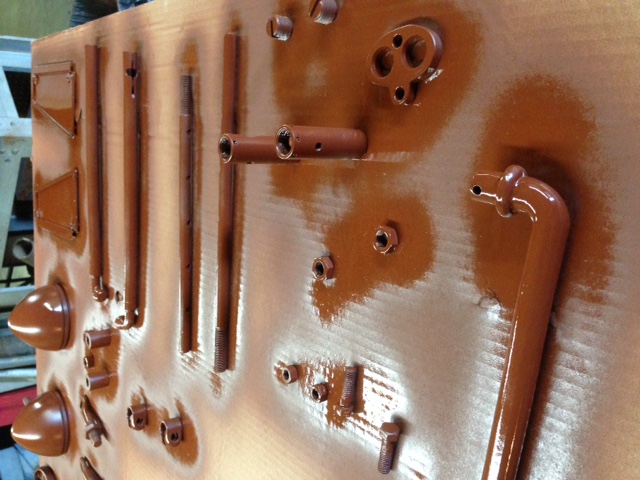

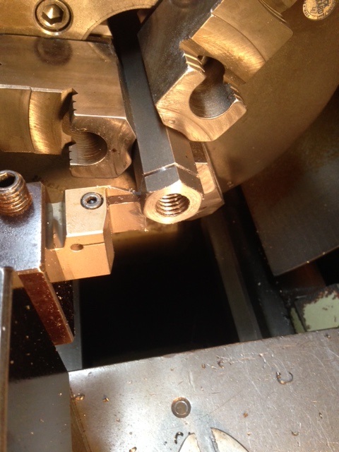

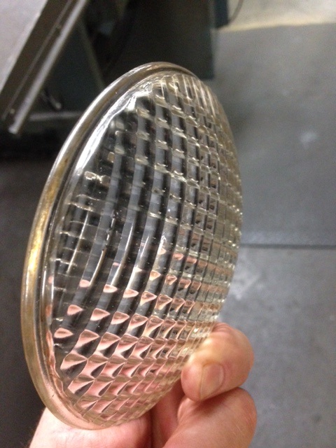

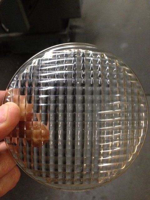

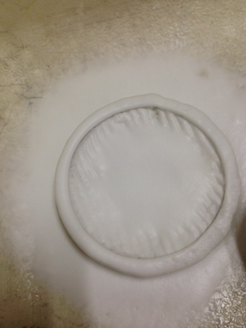

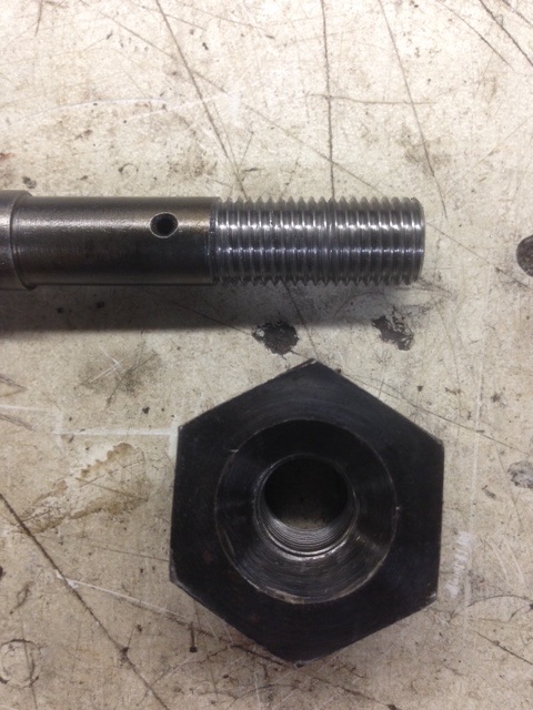

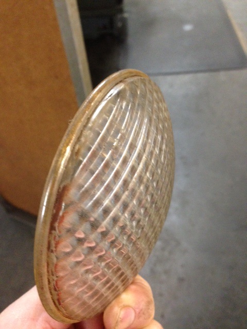

#14
Cleaned the light lenses with oven cleaner to get the rust off, found nothing that works better. Cleaned the rest of the lights and primed them. Also made 2 new locking nuts.

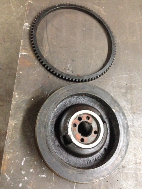

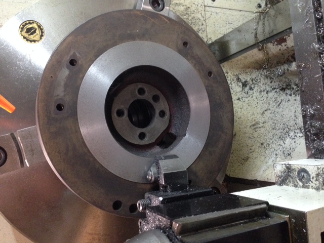

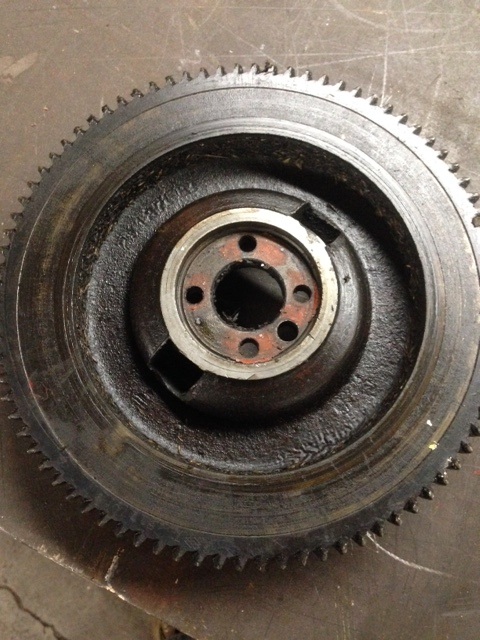

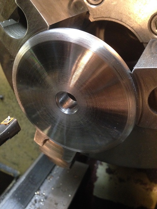

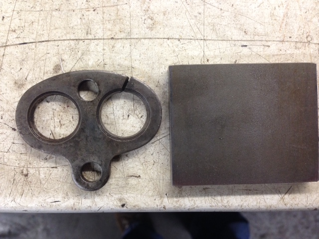

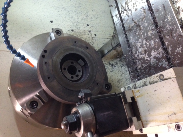

#15
Took .004" off the flywheel and turned the starter ring around.

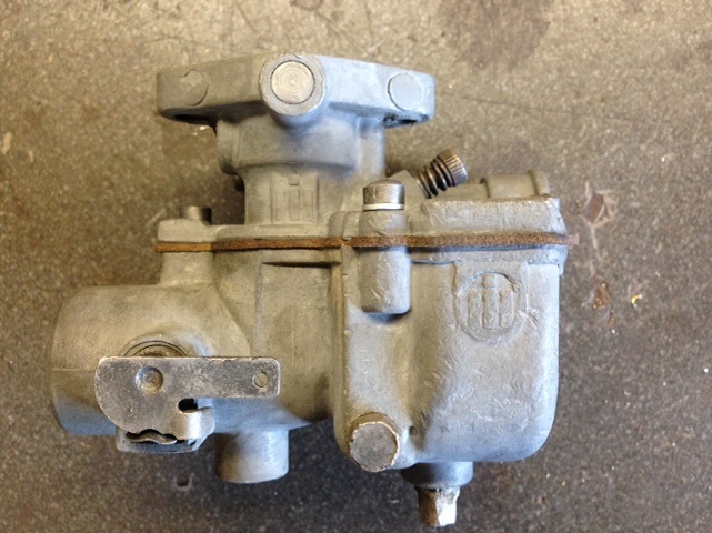

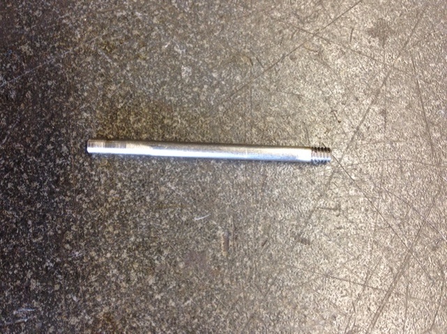

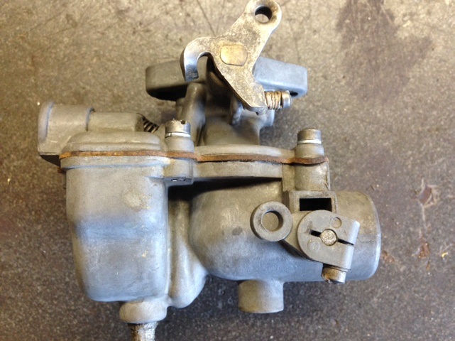

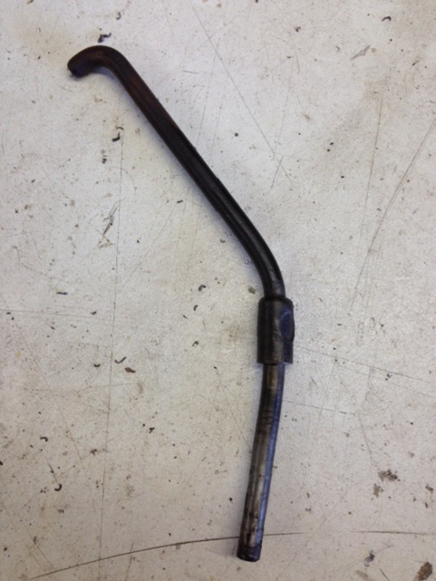

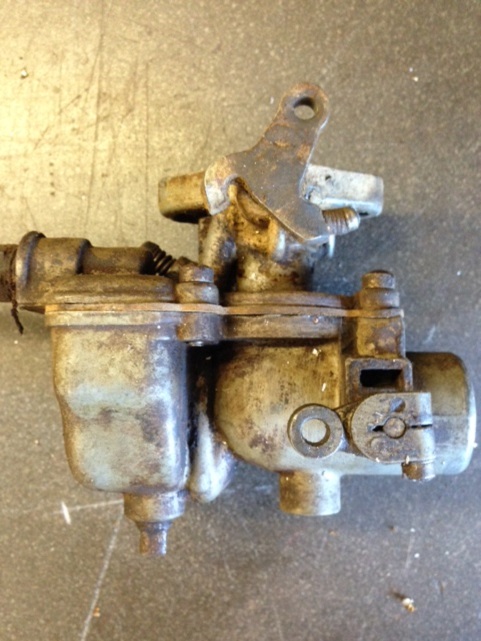

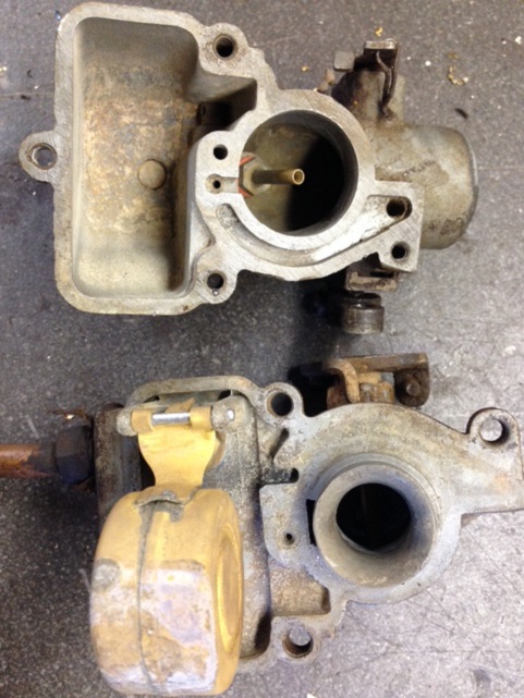

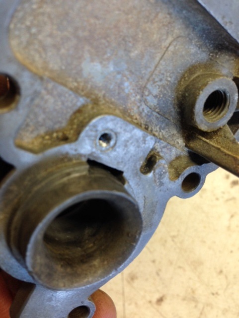

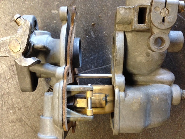

#16
Cleaned the carb and made a new idle tube for it. It was broke off and missing.

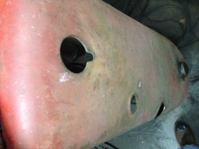

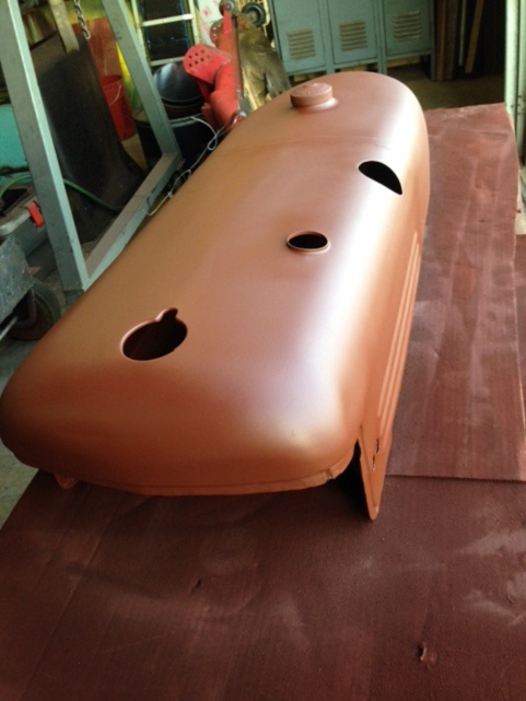

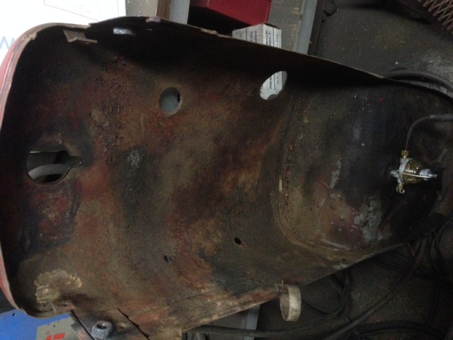

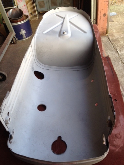

#17
Had the hood sandblasted before priming.

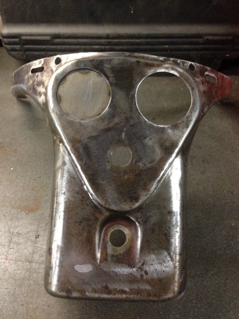

#19
Repaired/cleaned the dash.

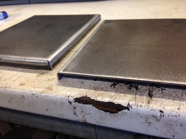

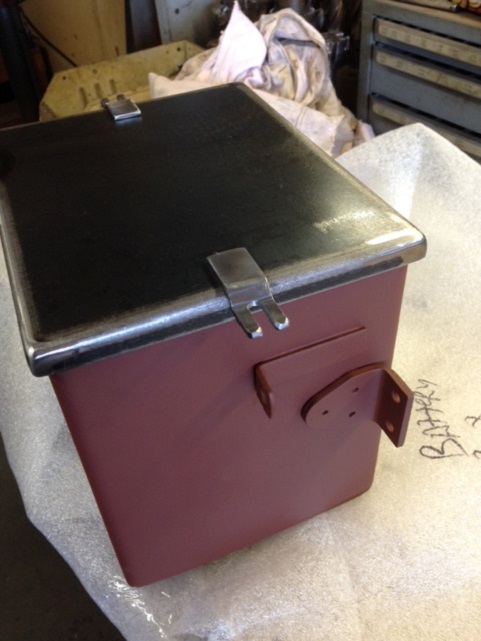

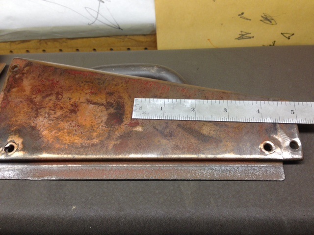

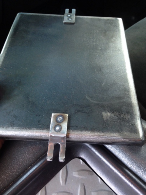

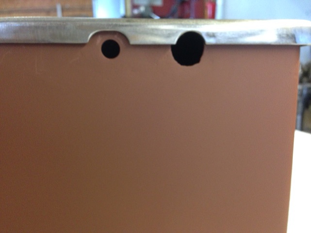

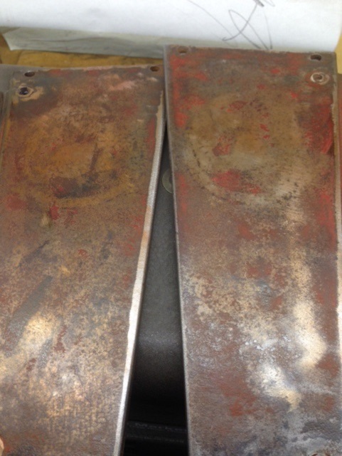

#20
Made a new lid & front for the battery box.
