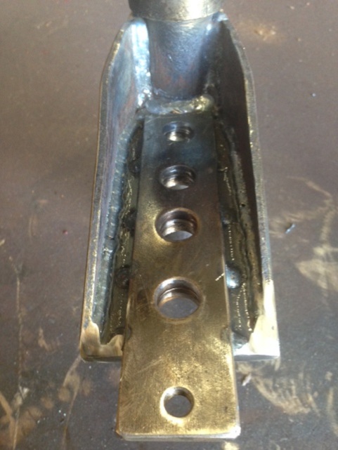

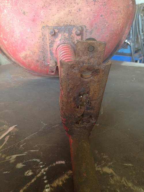

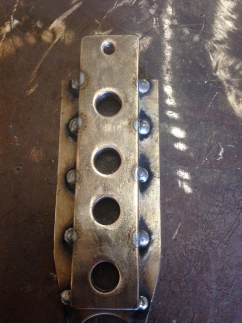

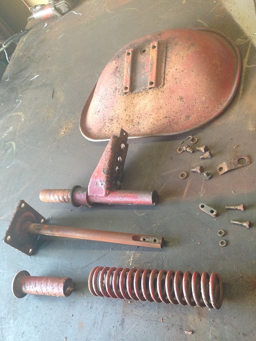

#21

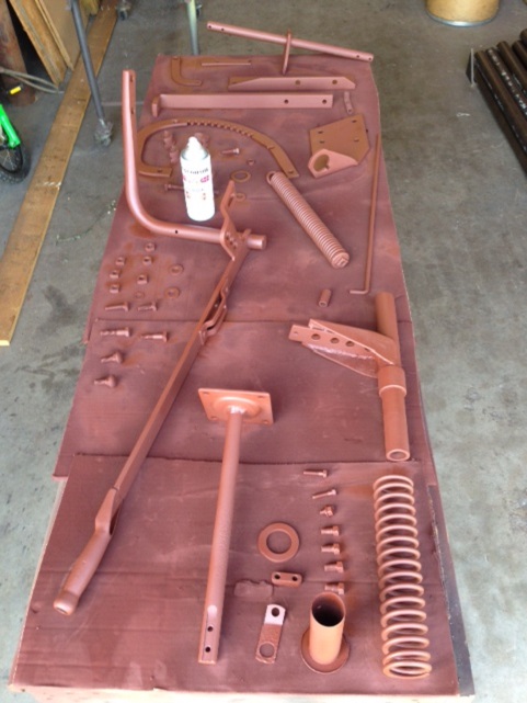

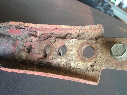

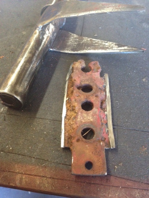

Repaired the seat frame.

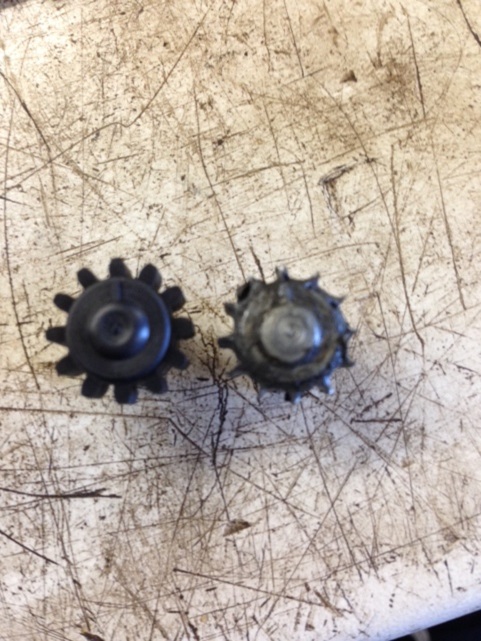

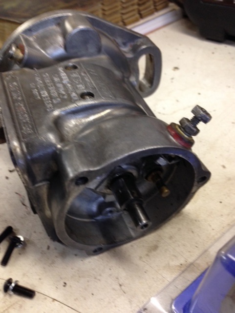

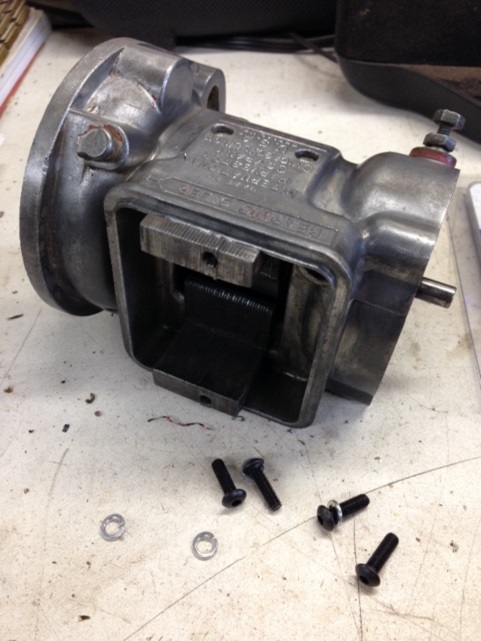

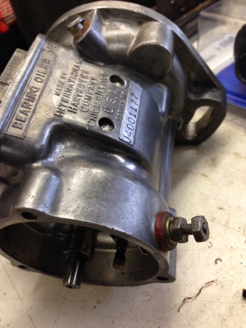

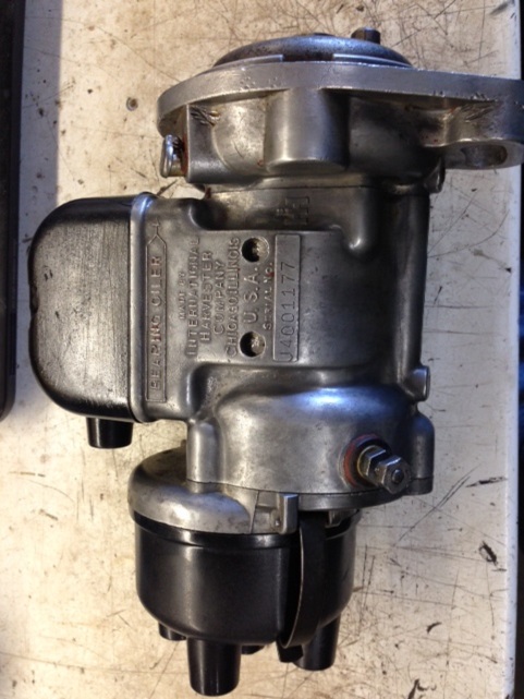

#22

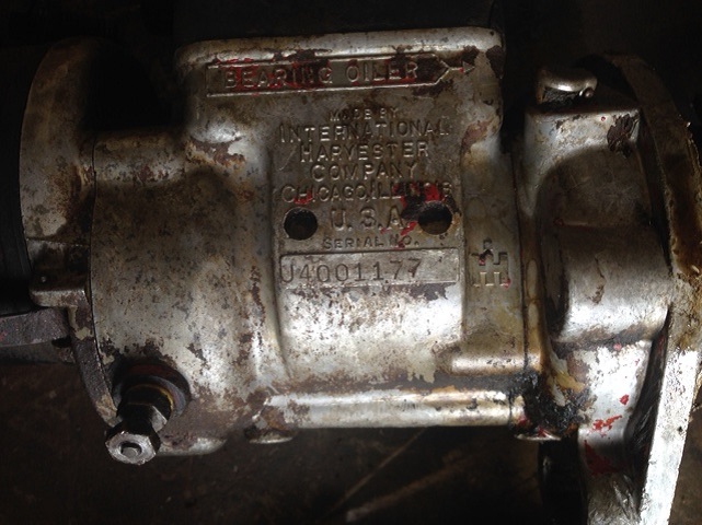

Rebuilt the magneto.

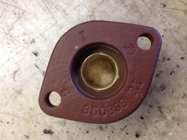

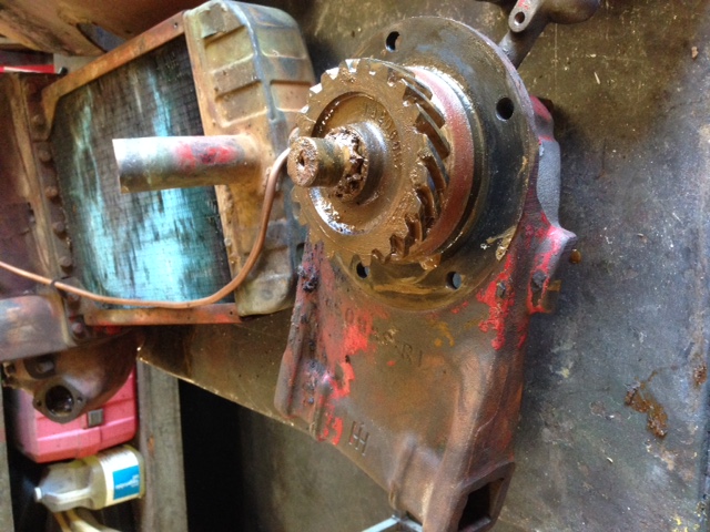

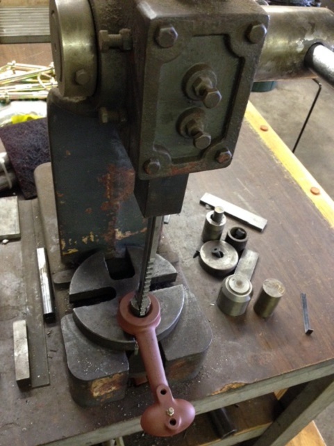

   / Circle Cub (4 digit) Restoration

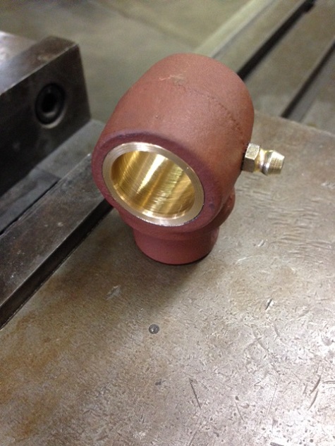

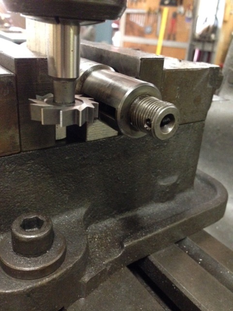

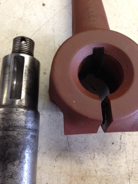

#23

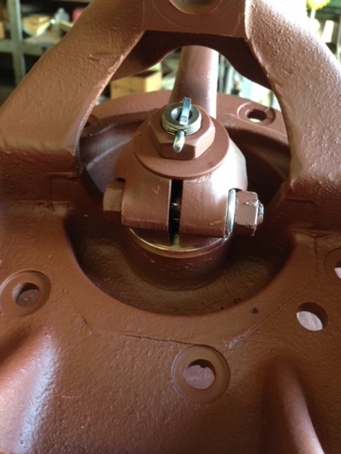

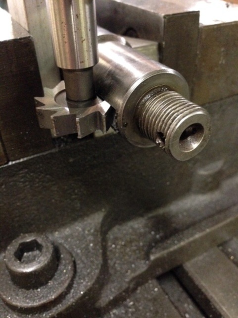

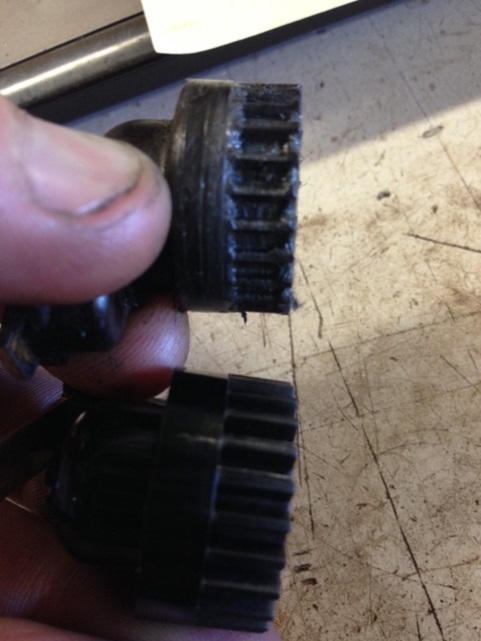

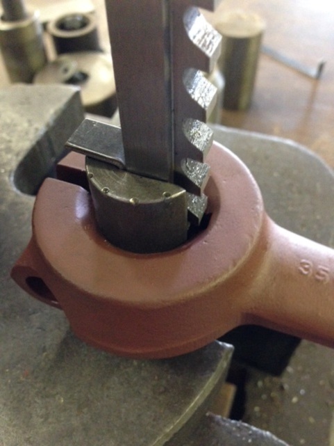

Rebuilt the steering. Cut a new key-way a size bigger to take out play.

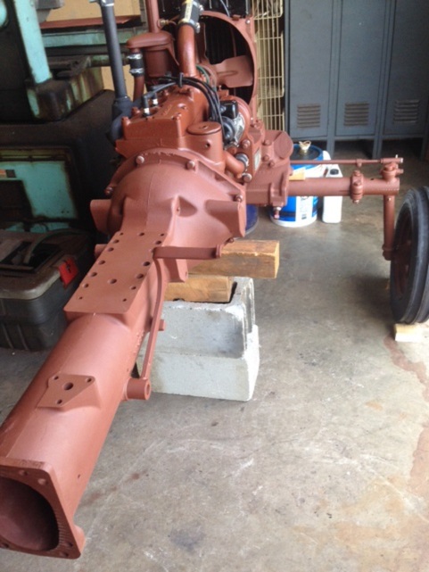

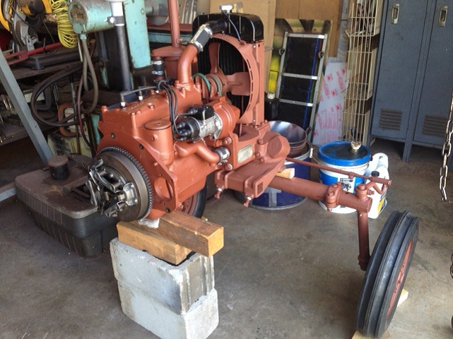

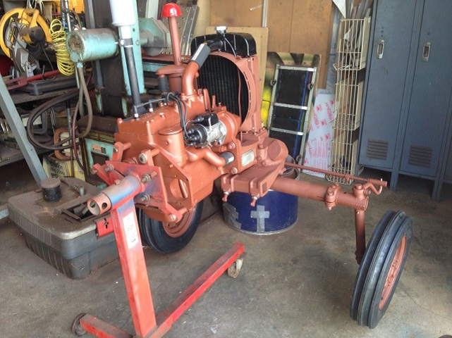

#24
Going back together.

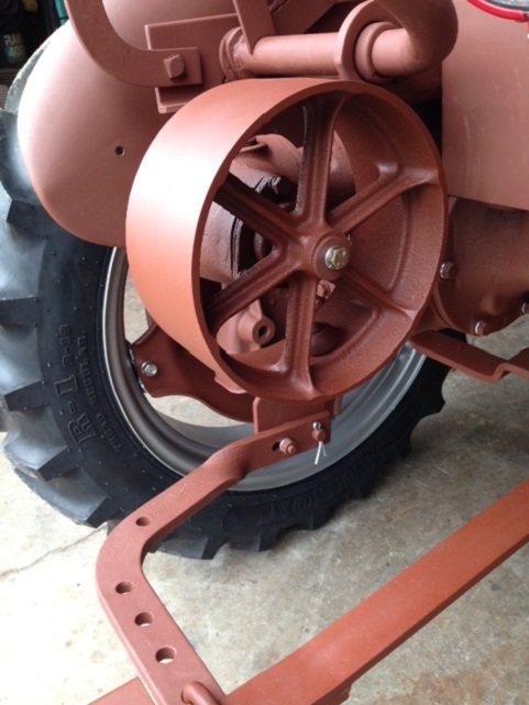

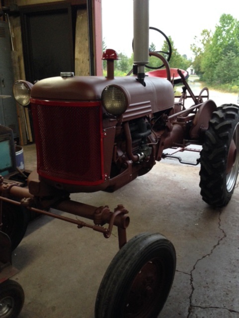

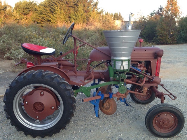

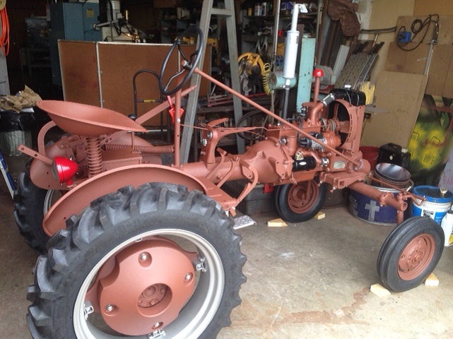

#25

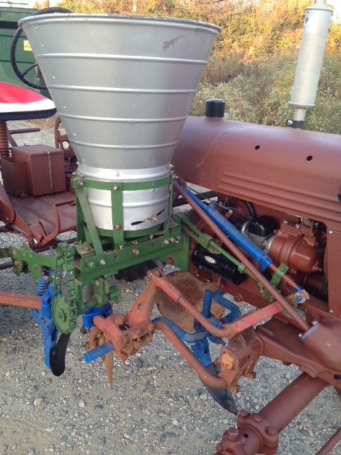

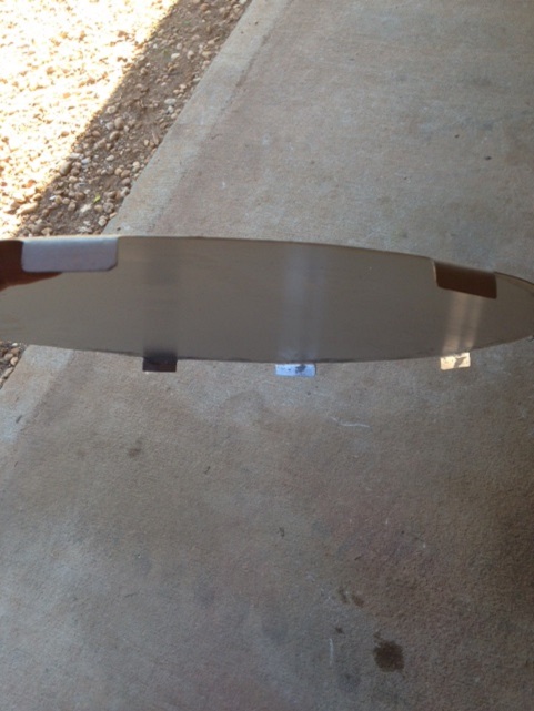

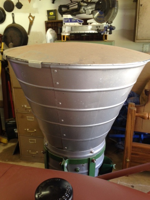

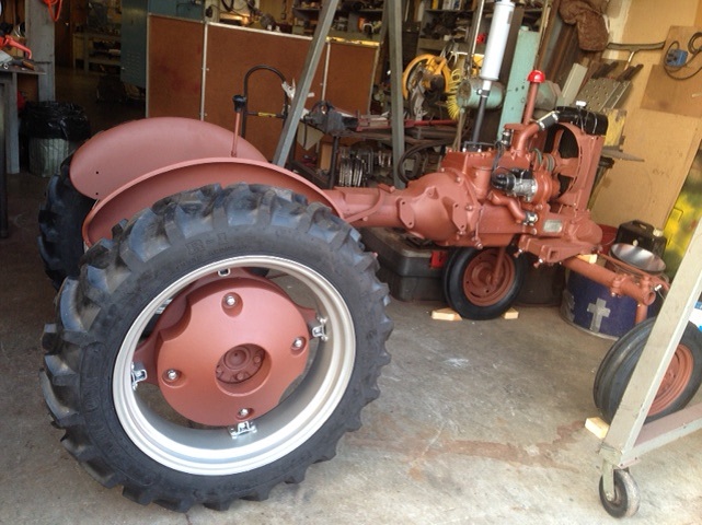

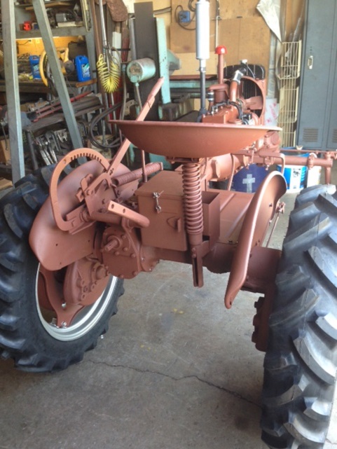

As it sits right now. Added the Cole fertilizer on it, cultivators need painting and tractor needs to be painted red. Got to find a place to paint it and the time. Oh and the lid for the fertilize I made out of an old satellite.
