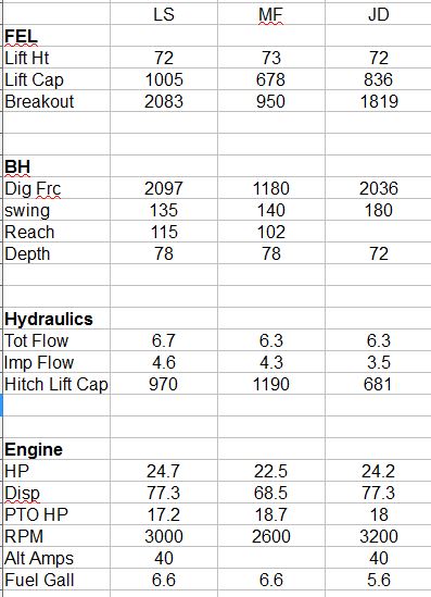

There may be other things to look at, but this chart is a quick glance at some basics. Some of the ratings are different,m ie Deere rates the hitch lift at 24 behind while the others rate it at the hitch. Also this is based on the MF GC1710 which is a step down from the more equal GC1720, but it's what I was quoted, so that's what I have to go with for now.
The FEL specs on that chart are wrong for the Massey since they changed the loader to the DL95 from the DL100.. Lift cap on the DL95 is about 890.. I like the 1025R but the GC is stronger and better built IMO but dealer support (in my area at least) just isn't there like the Deere is..
The GC has an impressive 3ph lift and they are getting over 18hp at the PTO with a 22.5hp motor, the hydro pump on the GC is stout for the engine HP it's matched with.
I have not operated a 1025R but I did own a 2305 TLB and I will say my GC1705 with less HP is more capable than the 2305 was.
