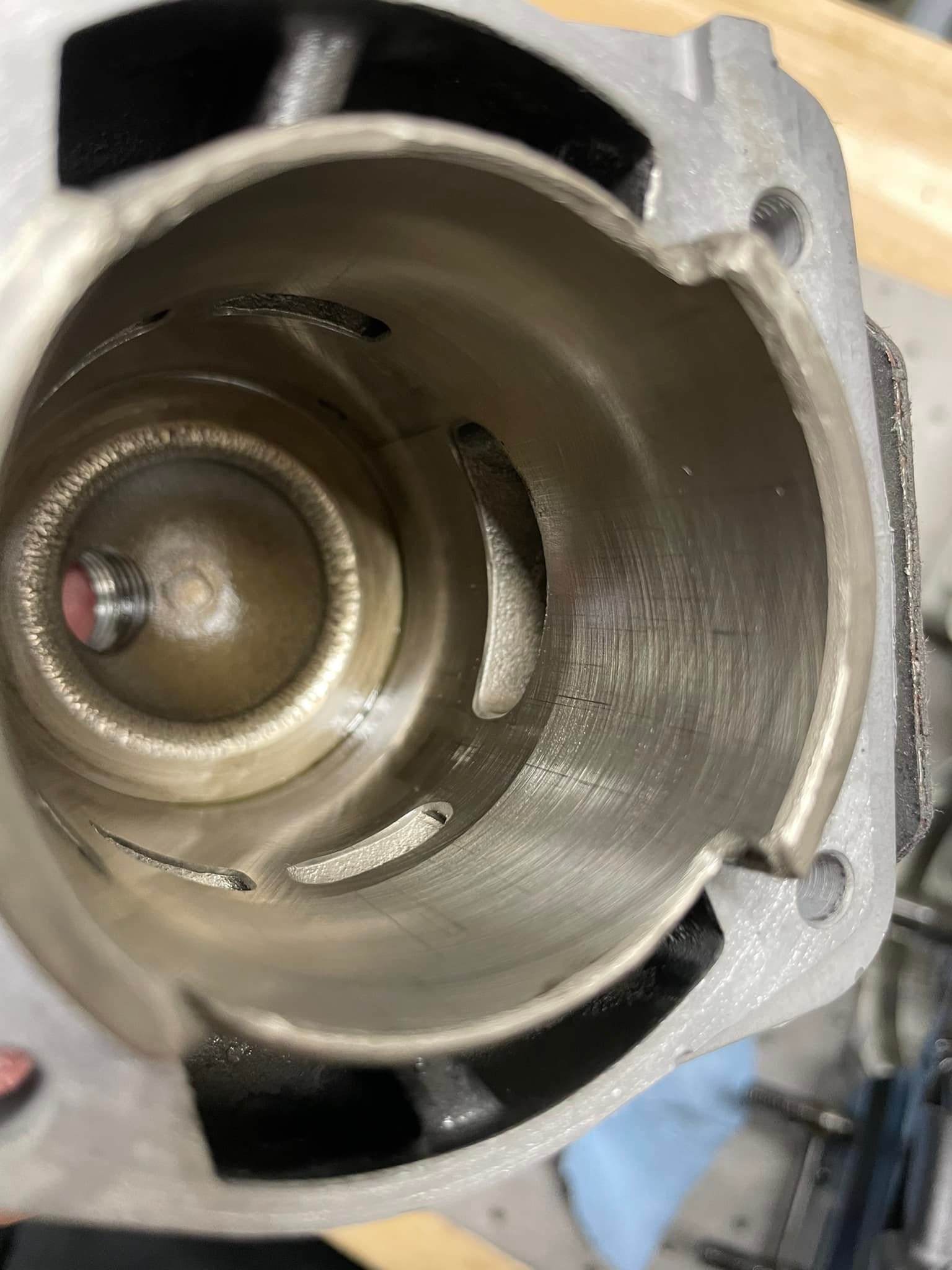

Do I see scoring or gouges in the sleeve?
Not scoring or gouges.
Have you ever pulled OEM cylinder. You will see the same crap now days. Just where folks pull dry piston through is what I think.
   / Chinese knockoff saws? #22

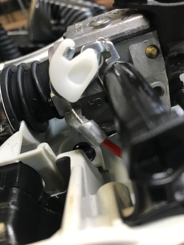

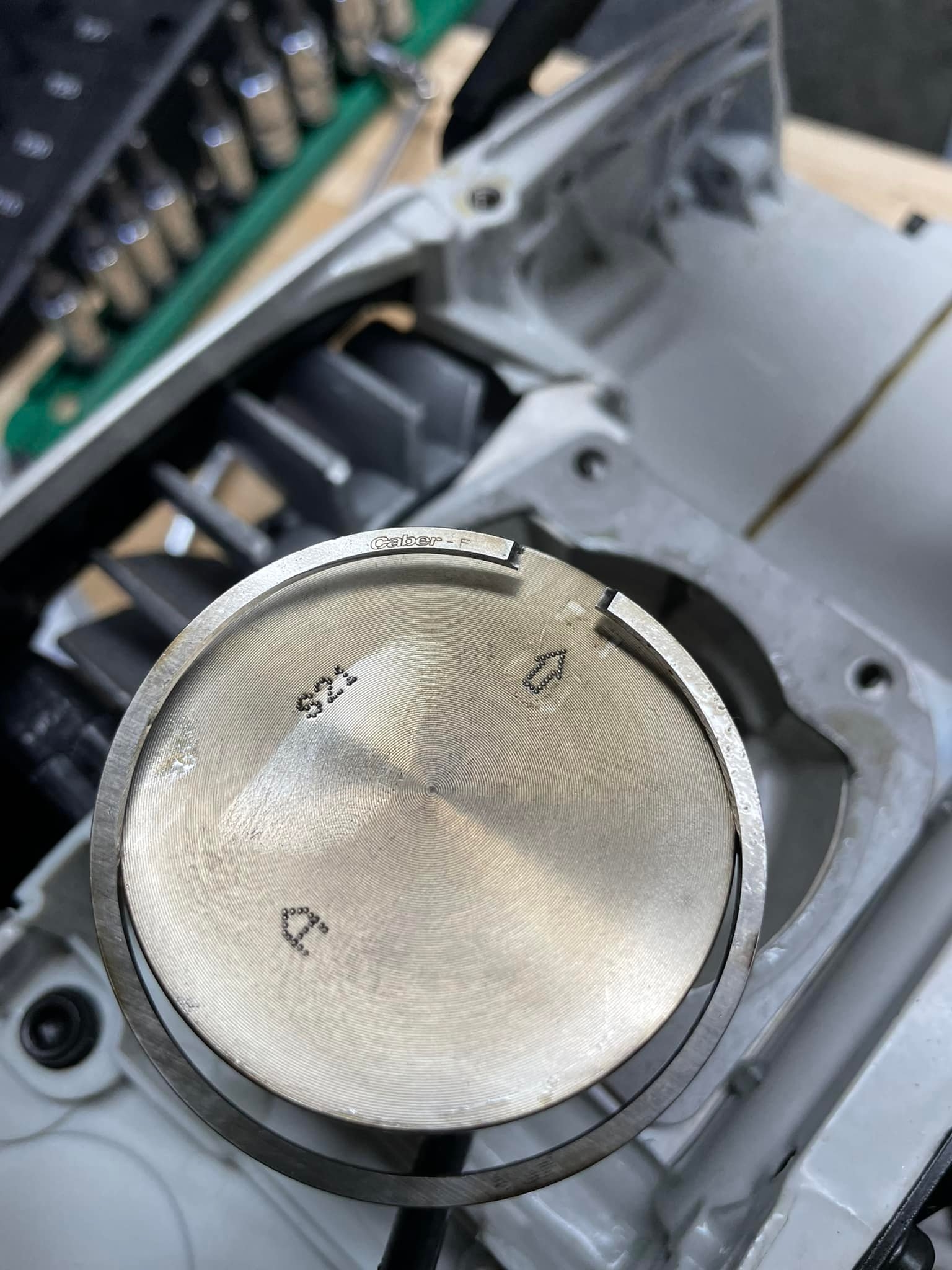

G395. Didnt think to take close pics like the dealer did of G372pro cylinder.
Ran mine for a few tanks before pulling.

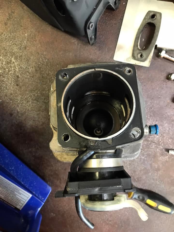

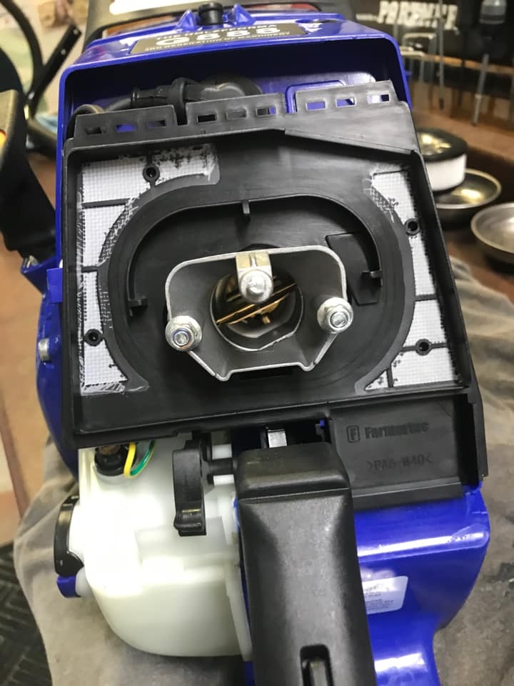

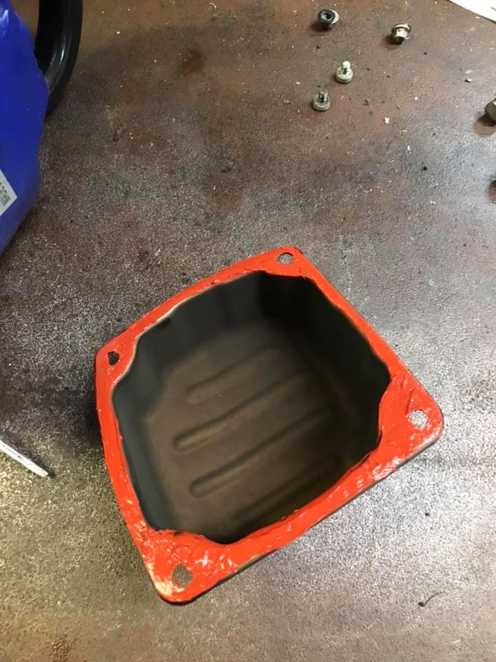

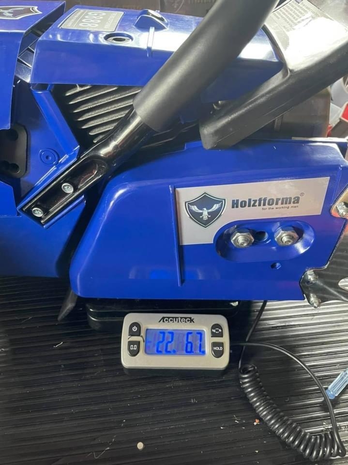

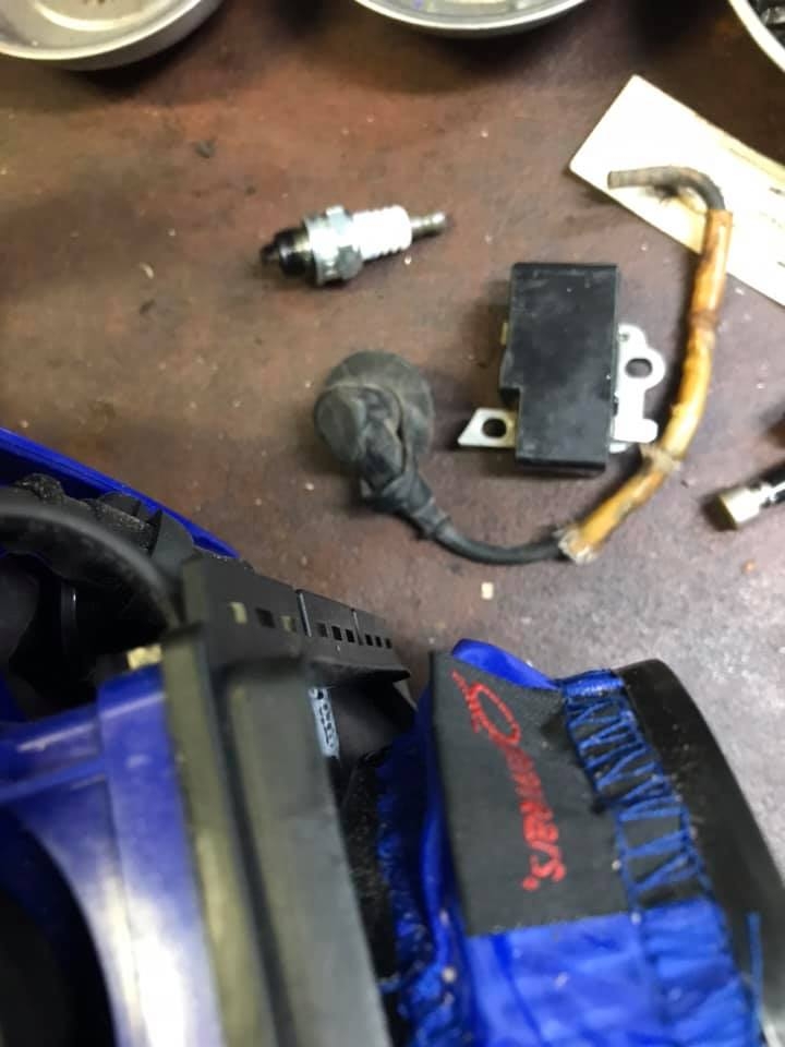

G888 I didnt pull cylinder off. Just changed to unlimited coil and did a muffler mod.
Also since OEM and clone dont use gasket on cover. I did the high heat on cover.

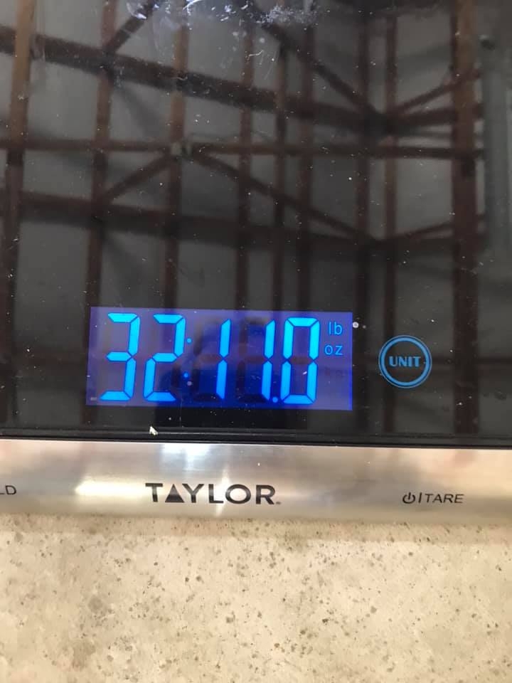

With just a 36" cannon bar and 3/8 chain and filled tanks was over 32lbs. Then dry PHO weight like oem weighs.

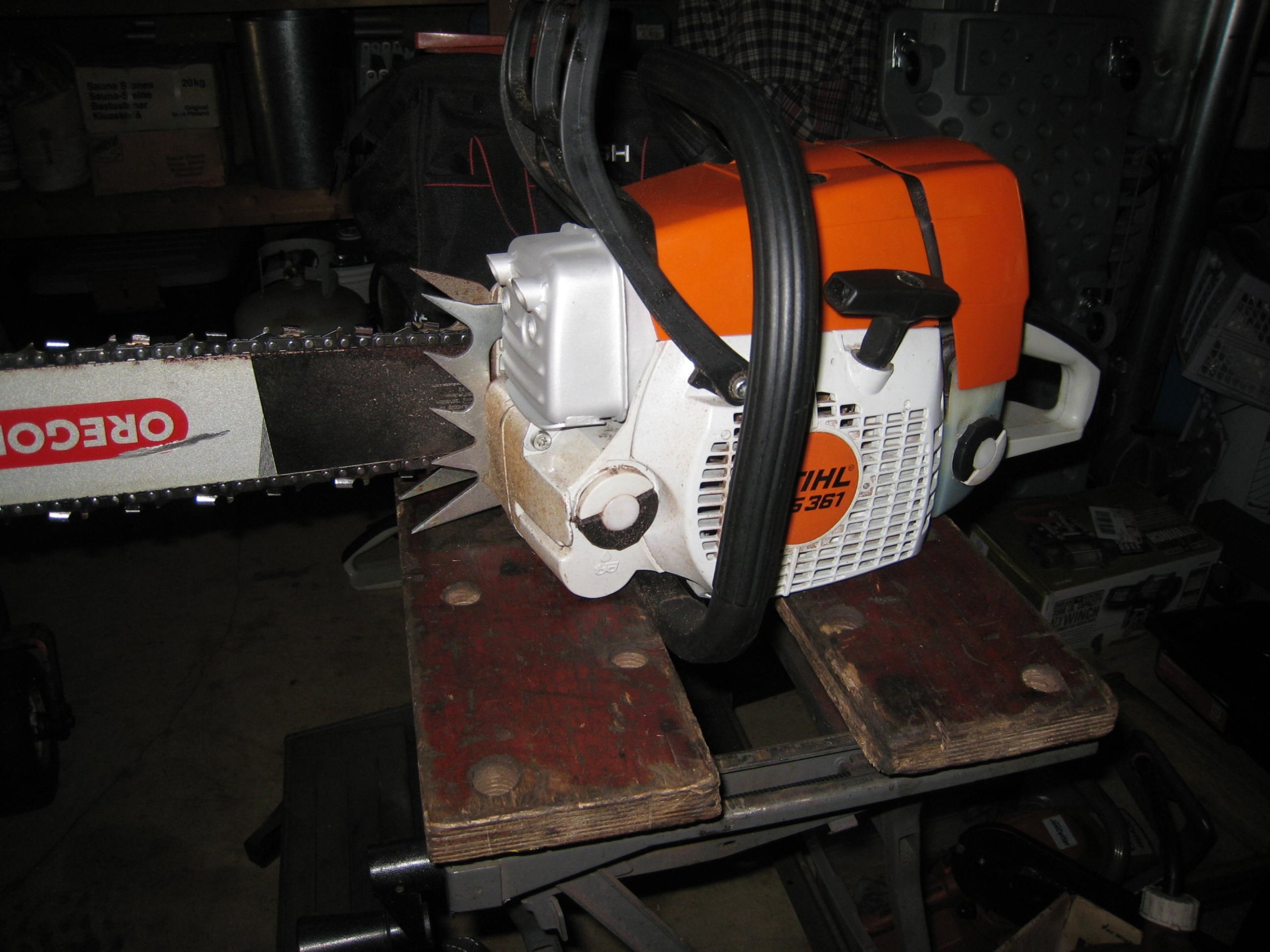

I have built Farmertec MS361 and MS660 clone kits couple of years ago and am satisfied with both of them as occasional homeowner use saws.
The 660 is a beast and I will put it thru real testing this winter since we had loggers cut down bunch of up to 44 inch diameter Douglas Fir trees, which most of have been hauled to sawmills, but I have been left with many shorter large diameter pieces on the ground and will have to cut them for future firewood little later during this coming winter.
I have used both of these saws enough to know they were well worth assembling for my intended use.
660 with a little 16" pro saw in the back:
361:
