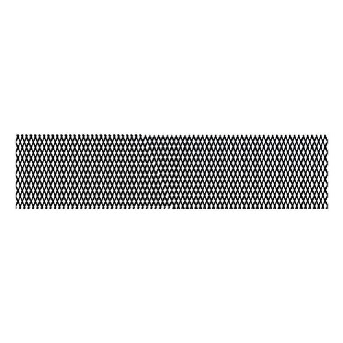

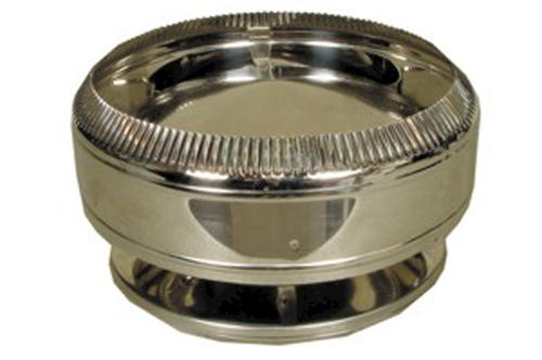

One would think that. I have a round 6" pipe with cap. An option is for stainless screen to insert it. I had some same size galvanized screen so I tried that because of cost. Didn't work. Plugged up very fast. Burned Dry wood and hot fires. I am thinking as the smoke cools it accumulates. I took the screen out and will try to find a larger screen.
On 10/12 metal roof at peak so everything needs to be planned out well before I make a move. I installed a bracket on the roof to hook an extension ladder half to reach the thing comfortably and safely. Ext ladder to get on first level roof then another ladder to scale the long steep metal section. I just need to find a bigger screen than what the pipe company suggests and offers.[/Q

Here is the POC super cap I got that lets little birds through. When I bought it originally thought it is not bird proof, and I was correct. Also the manufacturers sized screen I tried to no avail. Possibly I need a bigger screen because all is well except for the few birds that can sneak through in the spring when FP is off more often. Maybe I'll perch an owl on top, a heat resistant one.
I would go for an eagle - I just like it better and I really do not think it wold matter to the little birds, any big bird will do.
