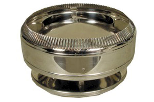

For some reason my flue does not build up much but I do get a build up on the bottom (inside) of the flue cap. Have not figured that out yet.
Most likely you have one of the newer gassifier type stoves, they are extremely clean burning and produce very little creosote because they recirculate the smoke/gases and reburn them. But I've found the same thing....the problem area is the top cap. It only seems to happen in really cold (for here) weather...like teens and below. My theory is that cap is ice cold, and the only place for whatever is left in the exhaust to condense. Ours builds up to the point it shuts off the draw of the flue, and I know when to hit the roof because we start getting a smoke smell in the house.

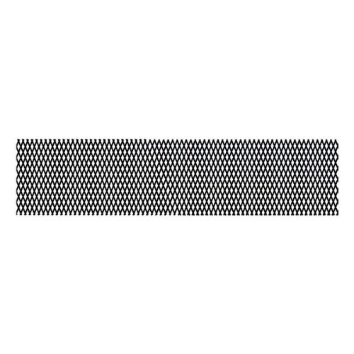

Correct, I have a secondary air burn and cat. My temps are not as cold as yours and my buildup on the cap is not enough to block the exhaust but still it is there. Worst thing is it drips on the masonary chimney cap (flue liner in masonary chimney) and stains. I am thinking of buying a second cap and swapping it out so I can clean one on the ground good and then just swap them out. Speaking of caps curious how many have a screen on them?

Funny thing is the screen on mine is fairly large mesh opening....more to keep birds out than to arrest sparks. Diamond mesh that is like 3/4" at the wide point....but it still clogs up. I was thinking of making it taller, it's only about 4-5" tall on the mesh part....was thinking that much again, and it would have a hard time clogging up that much....maybe. My roof is really tall, and steep pitch....don't enjoy walking the ridge line !
   / Chimney Fire - Is it Possible with a Selaed Insert? #29
In some areas a screen is mandatory as a 'spark arrester'.
Sparks do fly and are known to start forest fires.
Same applies to exhausts on chain saws and ATV's.
