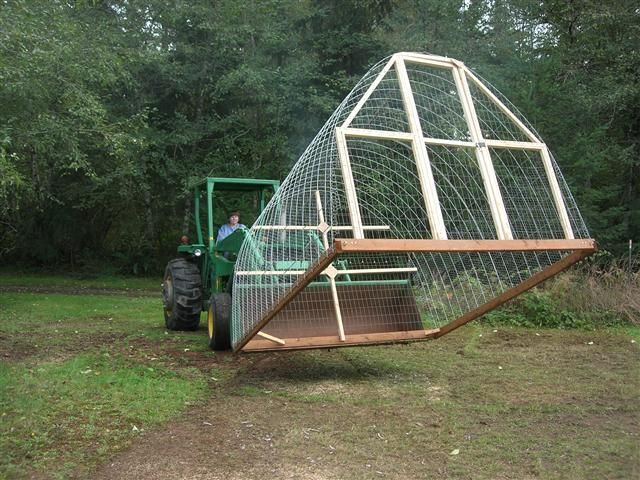

Expanding on that .... mount the tongue so the coupler is above ground enough to back a hitch and ball under it. Use a 3 point mounted trailer mover and the three point lift to raise it. No trailer jack needed unless desired.
Yep, and expanding on that:
If the trailing wheels are 24" behind the enclosure (touching the ground), and ball hitch is 192" (16 feet) forward from the wheels, and your 3 point hitch will lift its end 18", then the lifted ground clearance at the rear of the enclosure will be (18 X 24)/192=
about 2 inches.
If that's not enough, maybe extend the ballmount rearward (and/or shorten the toplink). Reduced lift capacity won't be a problem on part of 600 lbs.

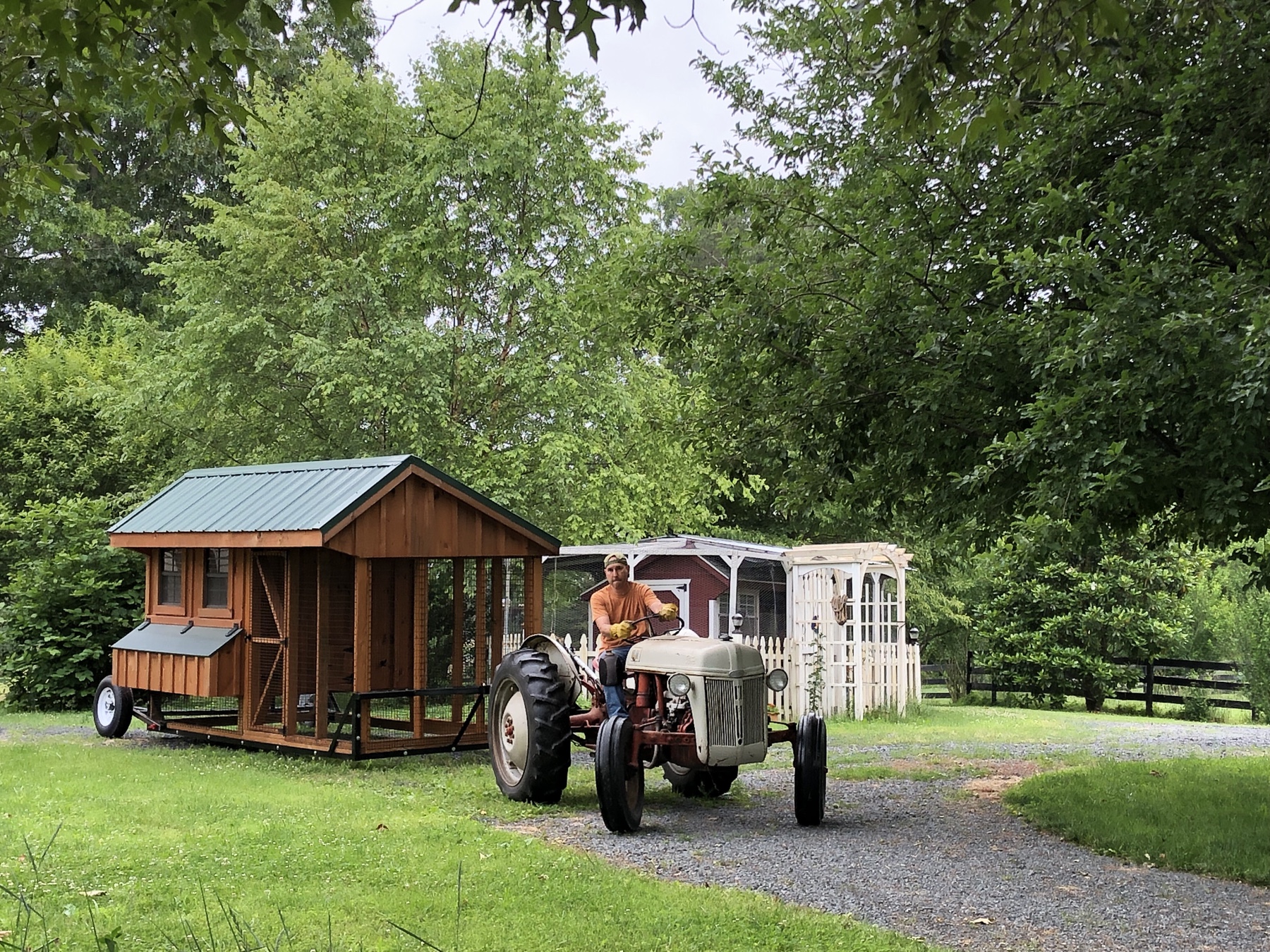

These are the wife’s prized Polish and bantam chickens so they’re not on the menu for us or the predators lurking around. We already lost two this year to that fox when we let them out for an hour.
When we move the chicken tractor we let them out. Since they’re Polish hens with big poofs on their heads they’re half blind and easy to catch and corral back in.

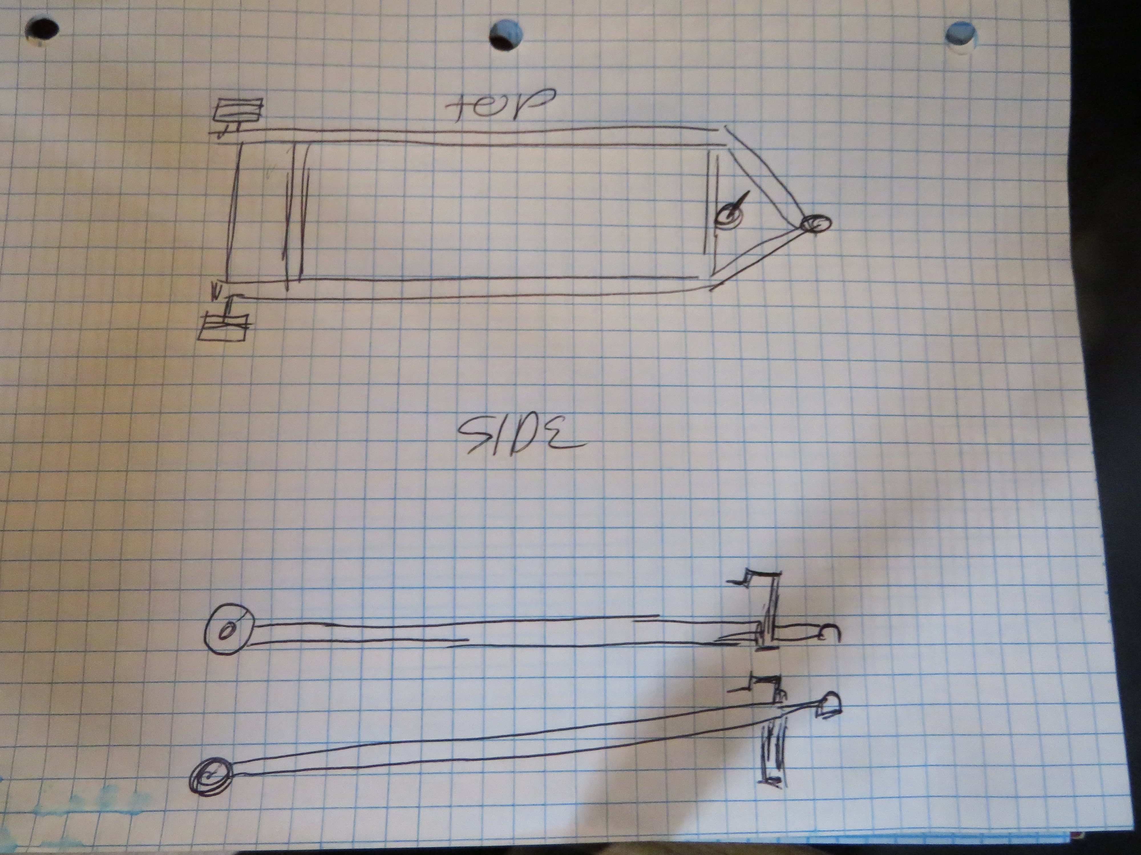

Sounds like you like your current system, you just don't like the strength needed to lever the wheels up. What if you nested 2x2 square tube inside of 2-1/2 x 2-1/2 square tubing & attached your spindles to the bottom of the 2x2. A cheap bottle jack on top of the 2x2 with a bearing plate attached to the coop frame above it could be used to push/extend the wheel/spindle to the length needed for your height. Drill a hole through both tubes at the right height & run a pin there to maintain. No tractor remotes needed & you could keep using the same tractor you have now. Reverse & use the bottle jack/remove pin to drop it back to ground when you get to your new spot. Instead of the cost of hydraulics/hoses/beefed up framing/etc. it costs you a few feet of 1/4" square tubing in nesting sizes/1 or 2 bottle jacks (depending on whether you want to carry from side to side)/& some welding time. with the savings you could upgrade the wheels/spindles & not overload the current weak axles. You should be able to get everything at TSC (except maybe the weight bearing plate), in which case you could substitute some additional square tube & weld up an inverted "L" for the bottle jack to press against.

If the current wheels are the issue, why not just get some sidewind jacks and atv tires?
You'll break that wood frame before hurting either of those components.

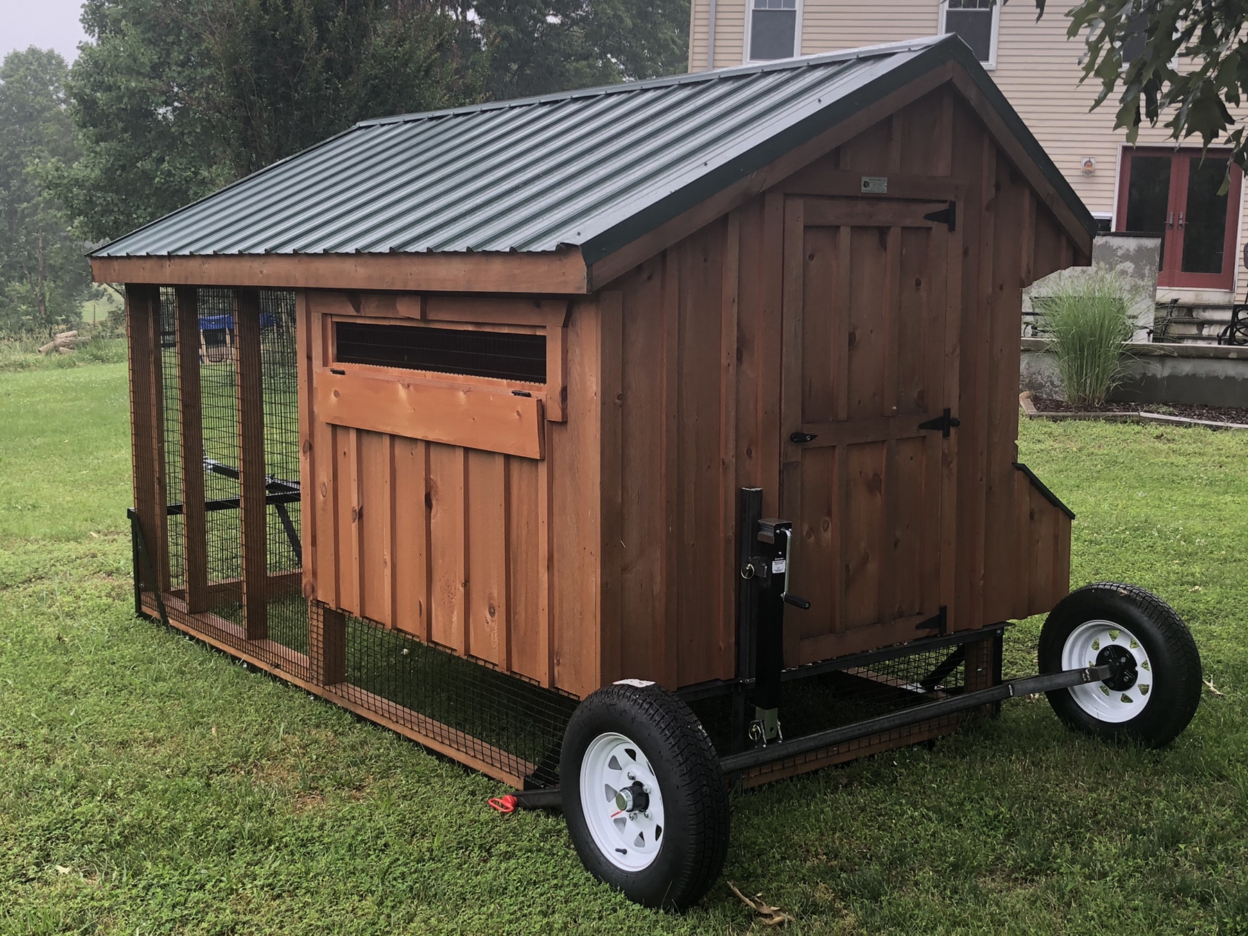

Wanted to update this thread with the solution we came up with for our new chicken tractor. I was originally going to use hydraulic cylinders to lift the coop. Then in the Hydraulics section they recommended I use linear actuators which I thought would work well.
In the end, due to cost, $62 vs $900, we opted to use a side crank trailer jack to actuate a rear swing arm that I welded together. When we get a new tractor with rear remotes I may convert it to use hydraulic cylinders. Probably the cost to benefit ratio wouldn’t compute, but it would just be cool. For now, we like the simplicity of a single hand crank to raise it and lower it.

Looks really nice. I'm sure the chickens are going to enjoy it!!!
