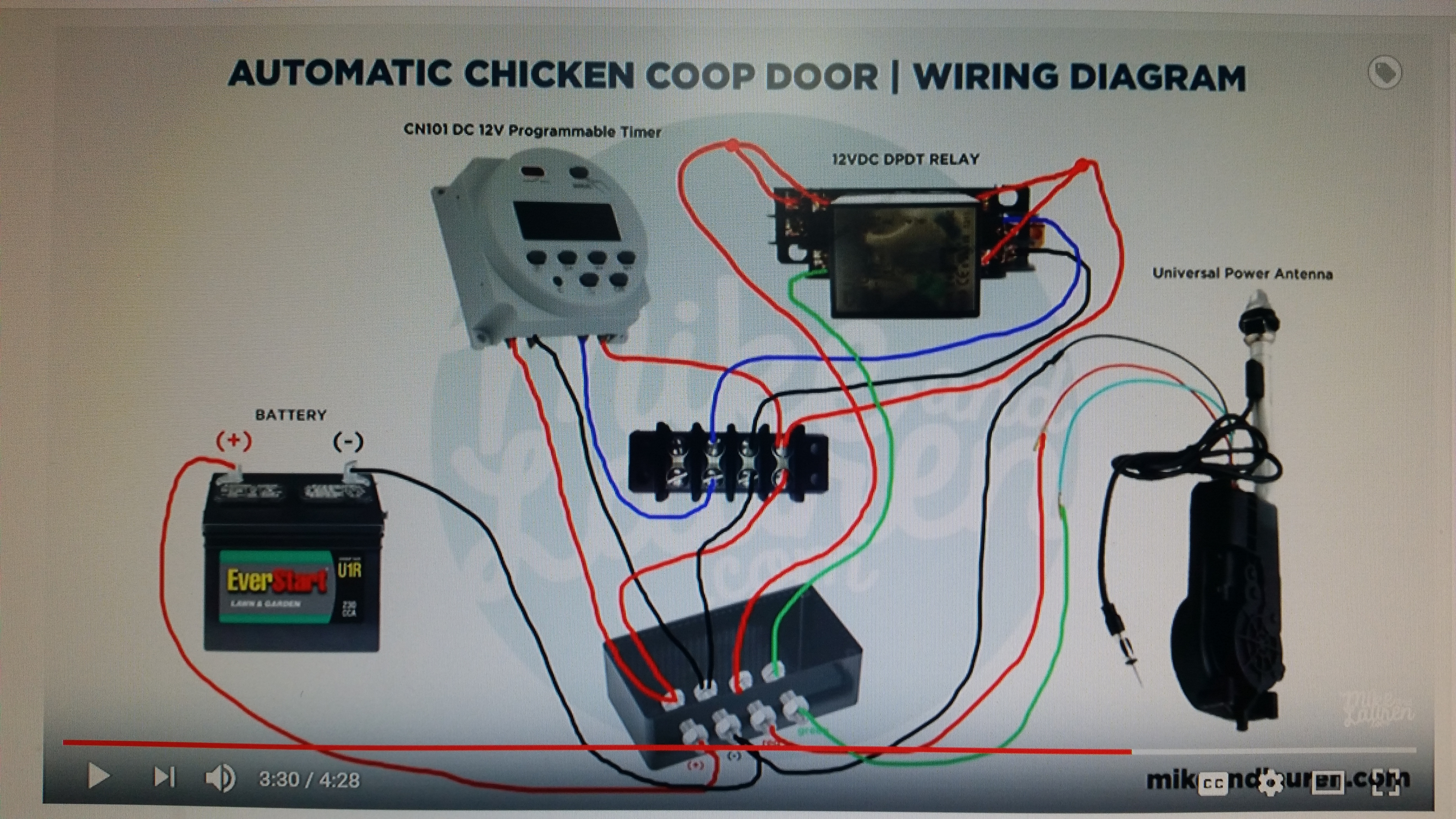

Ok Gals and Guys.......
Found this by mikeandlauren.com, an he actually got it to work, with a radio antennae. I like the door fastened to the Drawer Slides, looks very secure. I am going to buy an actuator and try one that way. This is his wiring diagram, the 1st box from battery is to House everything. He cut a round hole in it's lid so the Timer was accessible without having to open the lid.
This was a comment left on the youtube page, some very good points...[[Nice video.....thou you do not need the DPDT as the antenna will automatically retract when one of the power leads are removed by way of timer.Also, the bottom draw rail will very soon fill with dirt (freeze in colder weather) and chicken poop and seize. The antenna has very little power to overcome resistance especially on the extending stroke. I know because one of my first designs was exactly the same. To eliminate this put the door on the vertical as the antenna has more power pulling in the antenna (ie opening the door) and the drawer slides will not fill with dirt....... thou rusting and freezing will still be a problem.Over the years I have found that antenna version of my coop door was not as secure(because of issues mentioned) as what I wanted so I now use an 12" actuator piston (with built in limit switches), photocell, DPDT(needed for this to reverse polarity) and a 12 volt transformer. This version works like a charm. Not putting your door down....it will work fine....just continuing to build a better "mouse trap".]]

/ Chicken door Thoughts #26
Here is the link for anyone else following.....DIY Automatic Chicken Coop Door Opener Build | PART 3 - YouTube
This is the one I used: HERE
