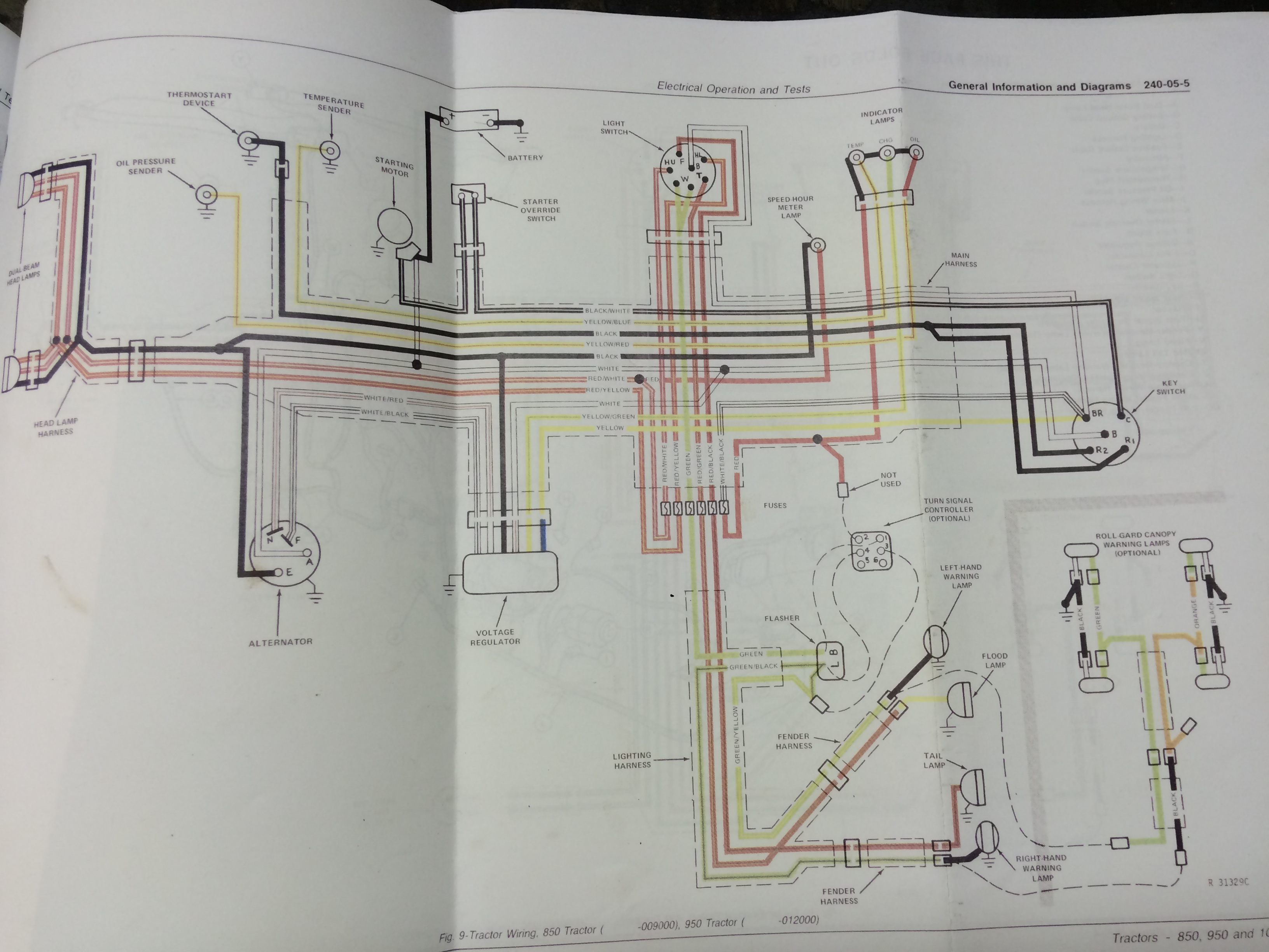

Here is the schematic

I'm using the same bulbs in mine. That's a fresh diagram, easy on the eyes haha. Honestly everything seems to be pointing back to the voltage regulator. Although power is getting to the CHG lamp so why it's not lighting is mind boggling.

Since there is only one hot wire that goes to the 3 light indicator assembly I think the bulbs get there ground at the 2 senders and the voltage regulator. I would disconnect the yellow/green wire at the voltage regulator and try grounding it. Am I reading that schematic right? I'll be the first to admit me and electricity just barely get along. I know the way to test the temp light is to ground the wire at the sender.
