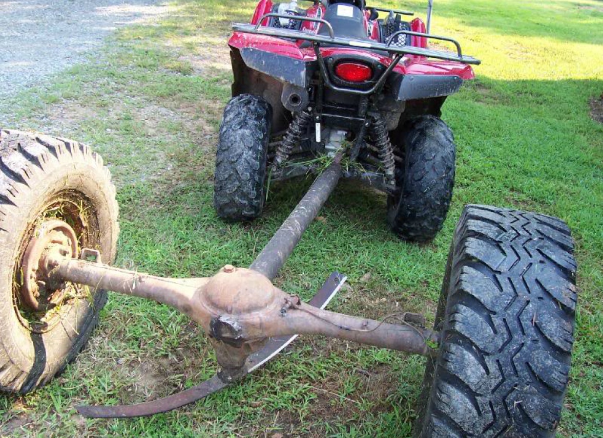

Is it possible? To turn a chevy rear end into a brush cutter/brush hog?
I've been thinking of turning a rear end axel differential into a drag style brush cutter. Turning the pinion and pointing it down and attaching a solid homemade blade to it, similar to a regular lawn mower blade except it would be 5 foot long. Basically the blade would turn when pulled and the wheels are turning. What are your thoughts and opinions? Do you think adding a grease zerk to the back of the differential housing to pump full of grease, instead of using oil would work?
What ratio should I use? Thanks for your input!

Would not be good for anything rough. Might work otherwise.
/ Chevy rear end brush cutter #3
If you are talking of using the drive shaft to turn the blade and the wheels to turn the shaft, I don't think it will turn fast enough to cut anything.
/ Chevy rear end brush cutter #4
My father used a mercury rear end with drive shaft pointing up to spin and spread chemical fertilizer. way to slow for a bush hog application.
Also the first stump or rock the pinion shaft or ring gear would be damaged not designed for this application.

I'll just be cutting 10 acres of Bermuda grass. No stumps, No stick ups or rocks. Yall say it won't turn fast enough? Wouldn't that depend on your ground speed? The faster you go! The faster your blade would spin?

It has been done, in a couple of ways:

Thanks for those pictures Bruce! The one with the 4 wheeler is exactly what I'm talking about.
/ Chevy rear end brush cutter #13
The one behind the atv is super simple... but gosh darn it, take that pic down before the safety police or your insurance agent see it!
/ Chevy rear end brush cutter #14
A deck over that blade would be welcome!

Notice the pulleys from the output from the BLACK one multiply the speed about 6:1. I bet it's difficult to get it going again if stalled. Agreed it's too light to get drive power from wheel traction. I'm a little surprised there's no heavy ballast. All the work that guy put into it looks like fun - but I bet he could cut a lot more grass setting a motor on it.
The one pulled by the ATV is probably so slow the blades need to be kept sharp but up high out of the rocks it's probably OK.

The black one was built by a member here, with description and video.

One problem with the long-bladed dangerous one is the curved blade (leaf spring?) will try to cut a weed stalk several times instead of only once.
Bruce
/ Chevy rear end brush cutter #18
with most rearends being a 4/1 or higher, I can't imagine it would cut well with just four revs per one tire rev. If you calculate tip speed from a pto system it is much faster.

The idea to take from the black one is that blade(s) can be belt driven and sped up, as opposed to the limitations of direct drive.
Ground drive is successful with reel mowers and sickle bar mowers, but not so much with rotary mowers, or we would see commercial ones to buy, especially for ATV's.
