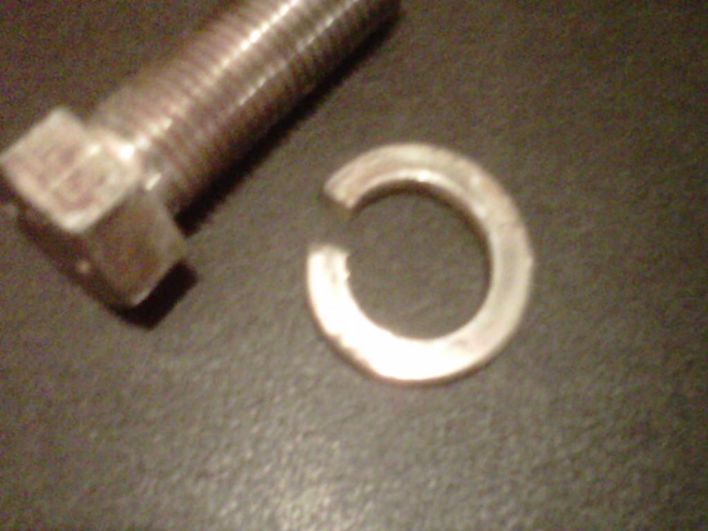

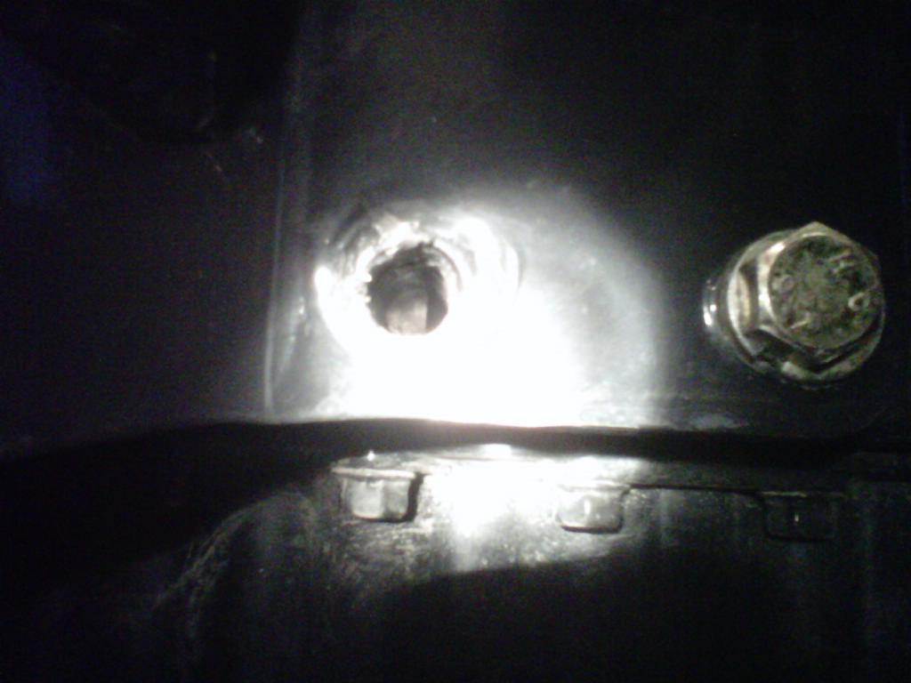

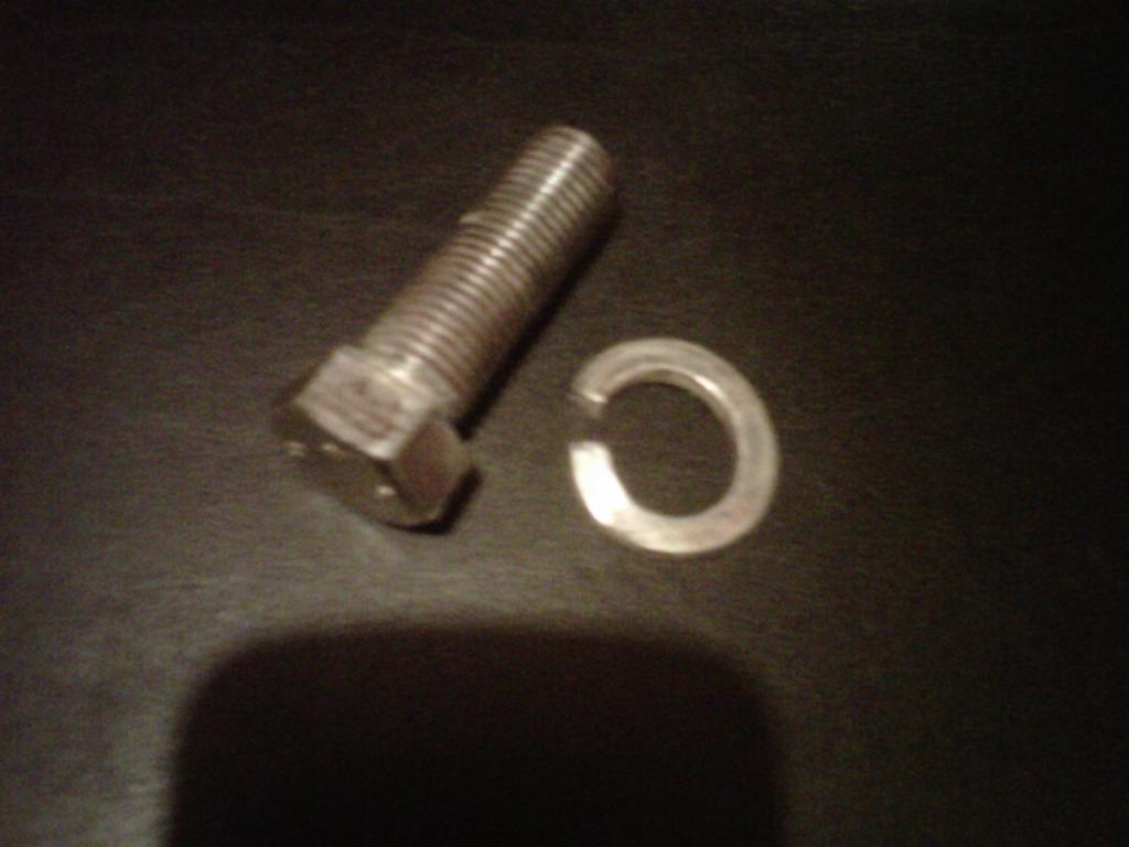

Hey Pack.
I have 166 hrs now and thought I better check the bolts since my FIL has been using it for some intense loader work the past 2 weeks. The tables in the manual so easy to read and comprehend......NOT!!!!
Anyhow, the loader mount bolts on the right side (front of the support arm) were pretty loose and I noticed the 2 bottom washers split apart (see photos). This doesn't look normal, does it?:confused:
I pressed the washer back together and put it back together. Didn't have any blue locktite so I just tightened it. I couldn't quite get to the 120lbs setting but shes pretty darn close to it!
If you look at the last picture, you can see the other washer split. This is all after hours, of course, so I'll call my dealer tomorrow and ask about it. Some of the bolts on the left side (both front and back of the support arm) were loose but not as bad as the right front were. The bolts to the arms running to the axles that have 3 bolts, 2 of the 3 were loose on both sides. Still have the wheels to check.
Hope everyone takes a few minutes to check their bolts!!??
IT - thanks for the original post on this......:thumbsup:

I have to correct myself. I just reviewed Rick Wallace's post to me towards the beginning of this thread. Apparently there are lock washers so the split would be normal. It would not be so normal if those washers had no spring in them however. Easy to replace.

It seems from the pics that the bolts line up top to bottom such that the back top and bottom and front top and bottom bolts could have a piece of flat stock thin metal drilled out to overlap each hole and then have a 'tab' which could be bent down to stop the bolts from loosening from vibration. This would include using the lock washers supplied and cleaning the threads of all the bolts prior to installing them back in 'chased' holes, ( ie. cleaned by a thread chaser, tap, before reinstalling each bolt with blue Locktite). This method is used a lot on mowers exhaust/ muffler bolts because of the intense heat and vibration. In the loader mount bolts case it seems there is sufficient jarring and shock to the entire area to warrant installing something to prevent the bolts from coming loose to begin with.
I'll check my DK-40 tomorrow because at 200 hrs or thereabout I have not checked the torque on any bolts except the loader structure, which I often find to be loose as a goose or missing bolts.
