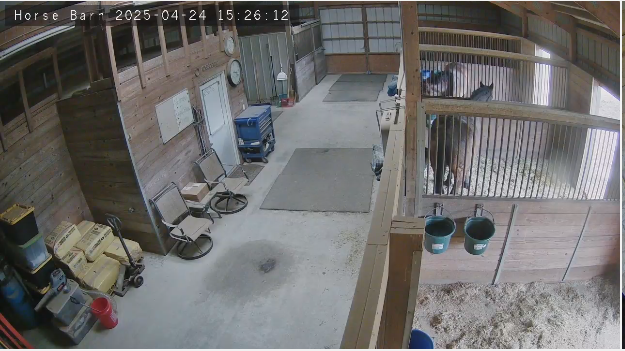

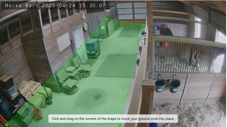

Being a retired firefighter/peace officer, we went for overkill. We have 2 separate fire detector systems in our house. One is the regular system with one smoke detector in each sleeping space, one outside the door, and all interconnected. The 2nd system is our burglar/fire alarm system. For the house burglary detection it has detectors on each window and exterior door, detectors on the attic pull down stairs, and internal and external sirens. In the house it has a smoke detector at each end of the house, heat detectors in the attic, and a siren. The stables has a door burglary detector on the tack room and a beam smoke detector covering the whole length of the building, 48'. The shop has door detectors, a glass break detector for the large window, and heat detectors. All are monitored 24/7 and can be accessed on our phones and computers.

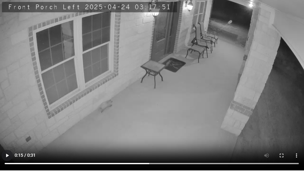

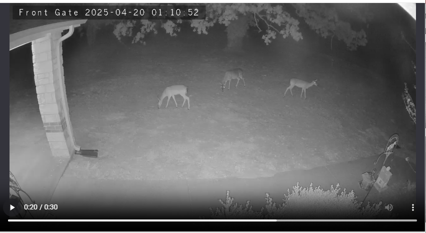

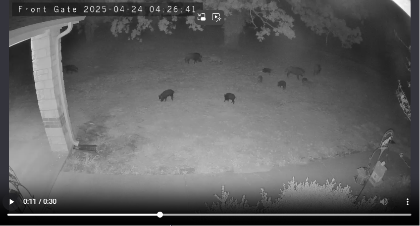

We also have 11 video cameras covering the outside of the house and the interior of the stables. It is nice to be able to check on the horses from inside the house. In the event of an alarm all cameras record for 30 seconds. Plus any motion on a camera causes a 30 second recording and sends a notification to my phone. We define the trigger area so the horses don't trip the system. It is amazing how many feral cats and other critters, i.e. opossums, hogs, and deer visit every night. I was feeding the deer in the front yard until the hogs showed up.
