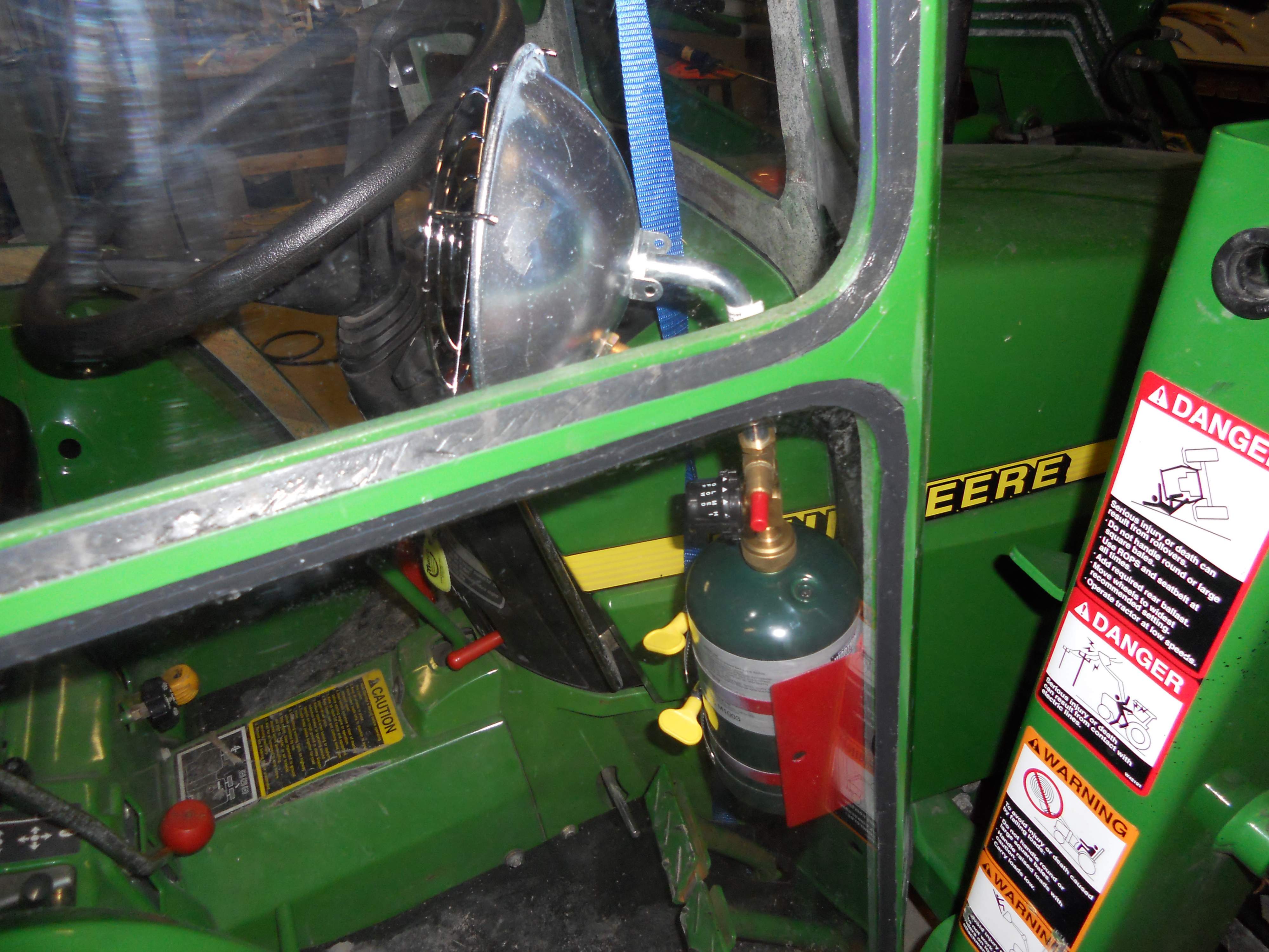

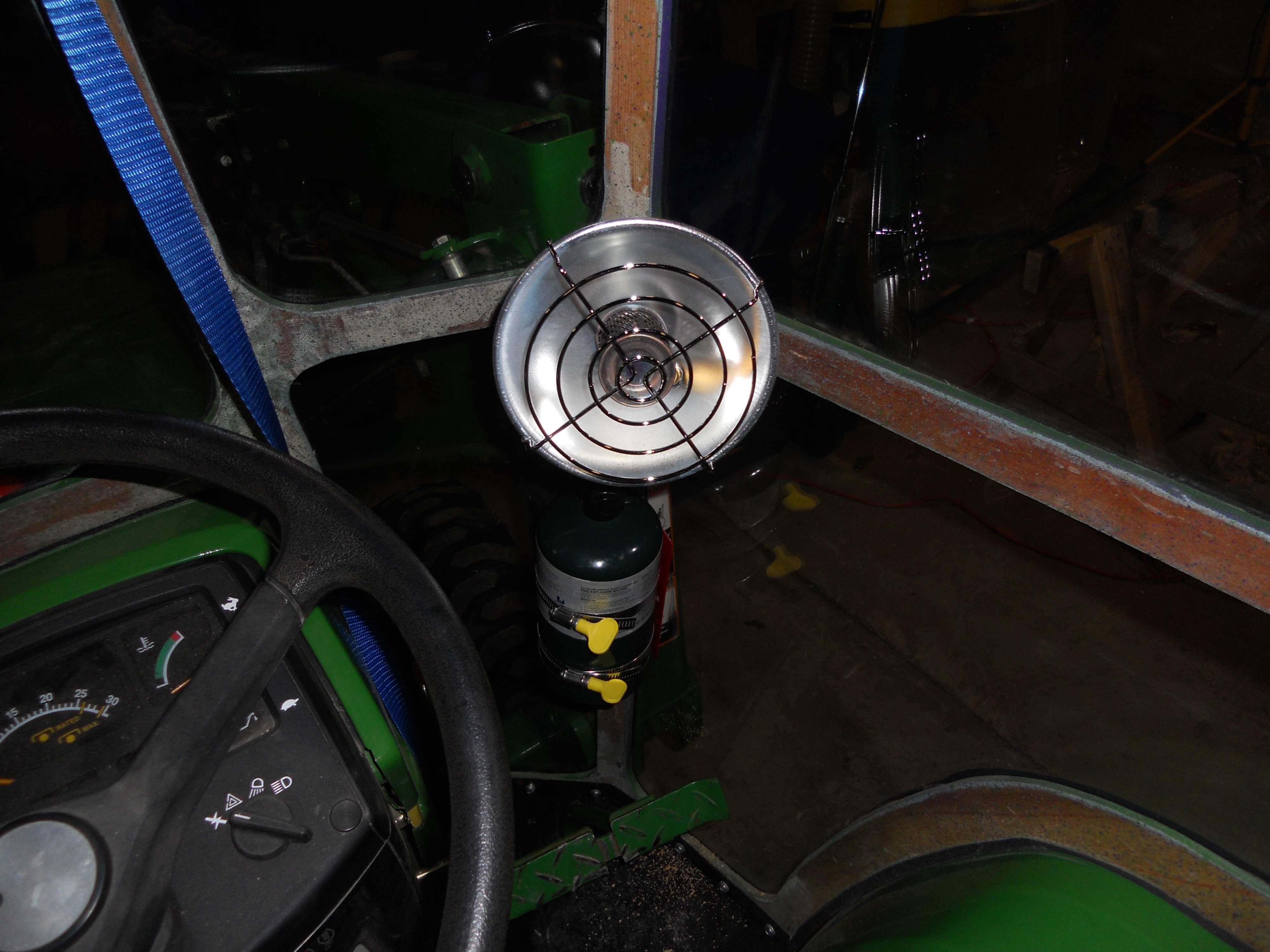

Hey Guys. Ive been needing a little heat for my cab this winter but I really didnt want to spend alot of money and time. Im not in my tractor much in the winter other than clearing alittle snow for me and my neighbors. An hour or two at the most after it snows is all I do. But I need just a little heat to chase the chill.
I came up with this. I bought a small camping heater at Dunhams ($25.00) and built a mounting brackett to attach it to the corner of my cab. Time on the brackett was about 1hr including the paint to dry. The clamps are dryer vent clamps with large "keys" to turn the clamp. Works great and cheap too. Even on the lowest setting cab gets really warm.

Those are great little heaters. I have one in all my deerstands one in my utv,tractor and a few to take camping when it gets cold.:thumbsup:

Be aware of the CO danger of a propane heater in an enclosed cab.

Just be sure to crack a window. Lots of people use those types of heaters when ice fishing. Every year we read about someone dying in their ice tent when overcome by the fumes from one of those. ;)

you should just get an old heater core from a junk yard and install a fan behind it.Much safer:thumbsup:
