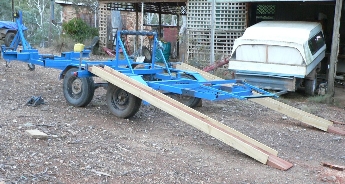

Made the ramps today - opted for greased slides instead of rollers due to far less work - think they will be OK because the angle is not very steep - or will not be when the stern rises. As noted earlier. two 4WD vehicles, one on either side of the trailer will have more than enough grunt. Note the raised sides on each ramp - to keep the keels from slipping sideways. A cross beam bolted between the two ramps will also stop any unwanted sideways movement
Here is a picture of the rig - The struts at the extreme rear end (seen here folded flat) are raised with a hydraulic jack to level the boat on the trailer rollers. The high roller in the center supports the deck when travelling. It does not affect the loading or unloading.

Is there going to be a third person there so somebody can be an observer and keep the pull in synch?
The two vehicles will be put into forward gear for the pull or will they serve each serve as an anchor point for a come along or winch to do the pull?
   / CHEAPEST WAY TO BUILD LOADING RAMPS
#80
There is already a winch on the center-line of the trailer but it is only a hand winch designed to work when the boat FLOATS onto the trailer It will not be strong enough to do this job. I considered a come-along or chain block but the pull needs to be along BOTH sides of the boat via ropes running from the aft sheet winches along the sides to get it lined up with the ramps and stay that way as it comes up.
It might be possible to use TWO chain blocks but the use of two vehicles seems more practical. I propose to have both of the "pull" vehicles FACING the boat.and pulling in reverse gear. That way both drivers can see what is happening and adjust accordingly.
