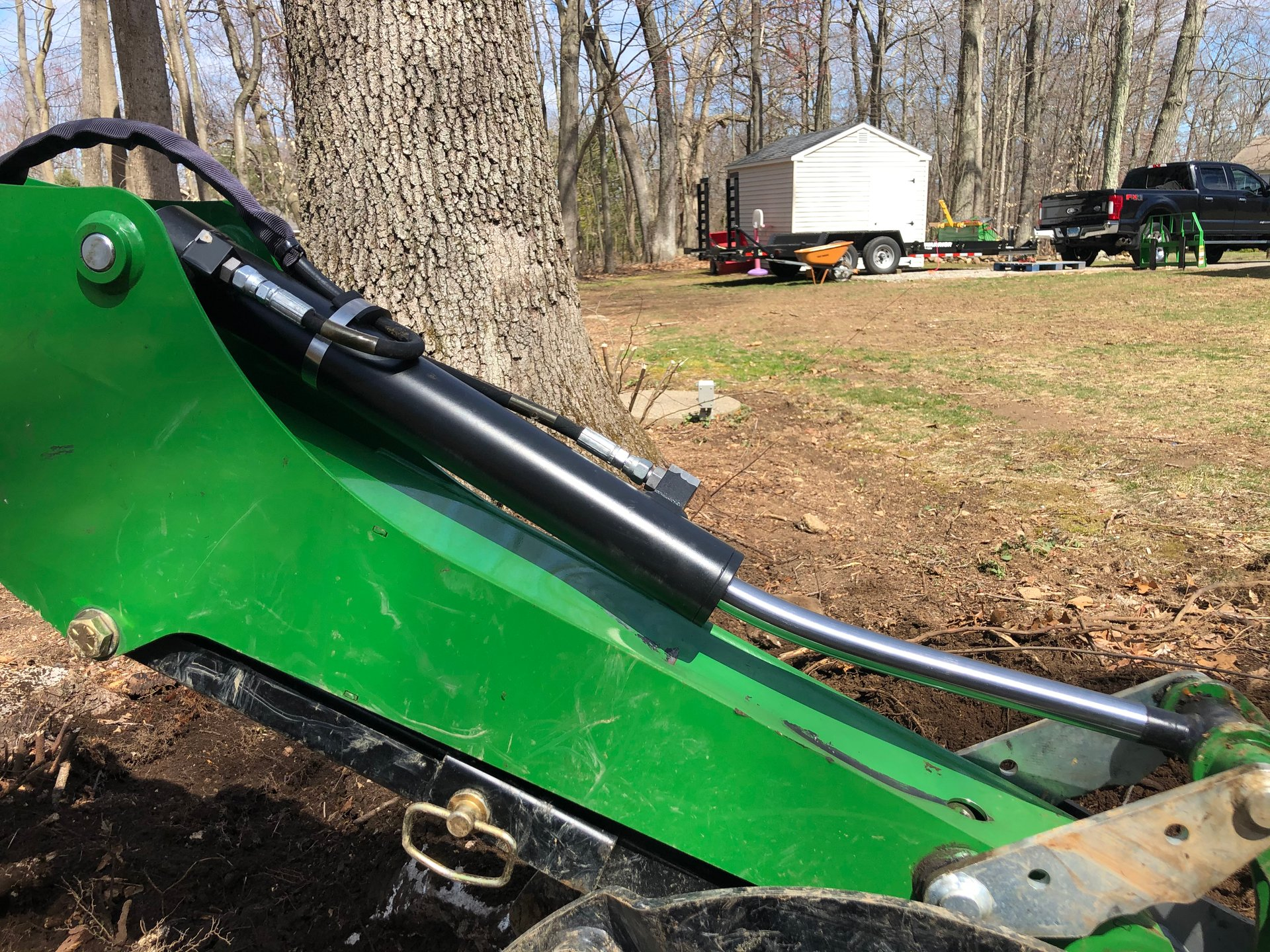

Can happen on any cylinder. The 4-bar doesnt prevent it. Its simply a function of length vs rod diameter and exceeding what is allowable. If you have a 1" rod sticking 20" out of the cylinder barrel.....a given force will make it buckle regardless of what its attached to.
"a given force will make it buckle regardless of what its attached to."
I certainly agree with that statement. It's interesting how all the cylinder rods bend "down" as if the weight of the cylinder is the determining factor but I think friction in the front pivot joint also contributes.
I do think, however, that the extra link keeping the cylinder rod farther from the pivot joint allows it to take more torque without buckling. I say this because the force produced by a given torque diminishes as the lever arm length increases.
Without the extra link, the cylinder rod will almost fall down on top of the pivot point when it is fully extended. The cylinder rod doesn't stand much of a chance when this close to the pivot.

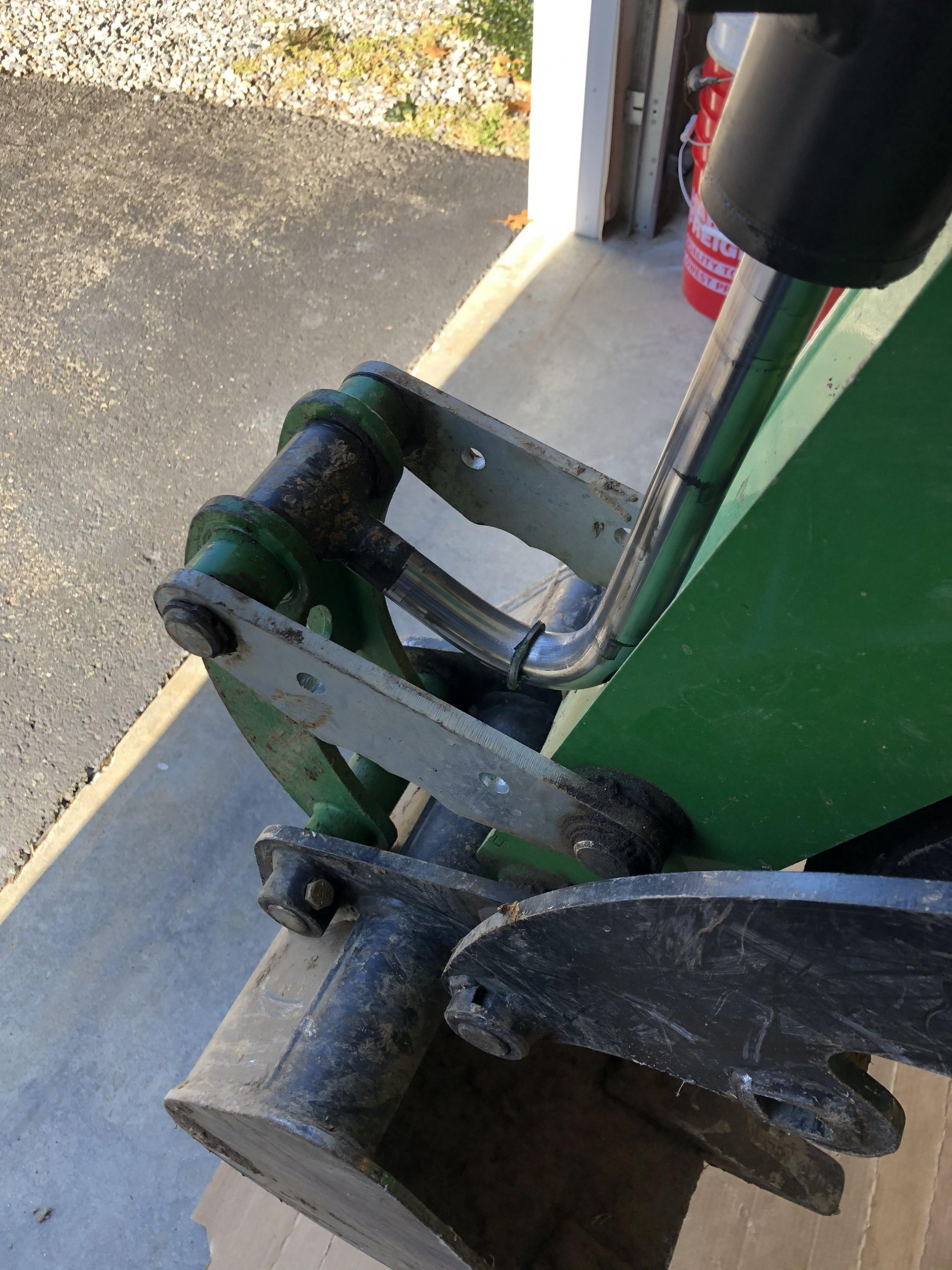

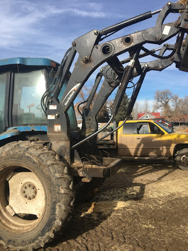

/ Cheap FEL cylinders keep bending #132
Oh so many things jumps out at me after seeing all the images…
Notice the holes… why are they unused?
When it should have these brackets in place like these…
Somebody screwed up at the dealership.
Nobody screwed up at the dealership. The cylinders are non interchangeable. Some bean counter at the manufacturer made a deliberate effort to do this.

Yep, concur. Making the failure less likely is worthwhile I would think. My second photo in post #116 shows the extremely extended cylinders right down against the tip end of the loader frame. You'd think some forward scraping, hitting an object like concrete, or down force by the loader while the tip of the bucket is on a rock or log , etc. that I mentioned earlier could potentially bend the cylinder rod upward (arched down over the end of the loader frame) but the cases seen so far are bent in the other direction -- downward.
Yes, that picture definitely shows the issue. Assuming a distance of 24" from bucket tip to the pivot pin and 4" from the cylinder rod to the pivot pin gives a ratio of 6:1. So, assuming a point load on the bucket tip of 1000 lbs would produce six times that or 6000 lbs compressive load on the cylinder rod. The load on the cylinder would be reduced by half if the rod was 8" from the pivot pin. Might still bend the rod if too small of diameter.
The rod diameter is, as several mentioned, very important. A 1-1/4" diameter rod, for example, is 56% stronger than a 1" diameter rod.
