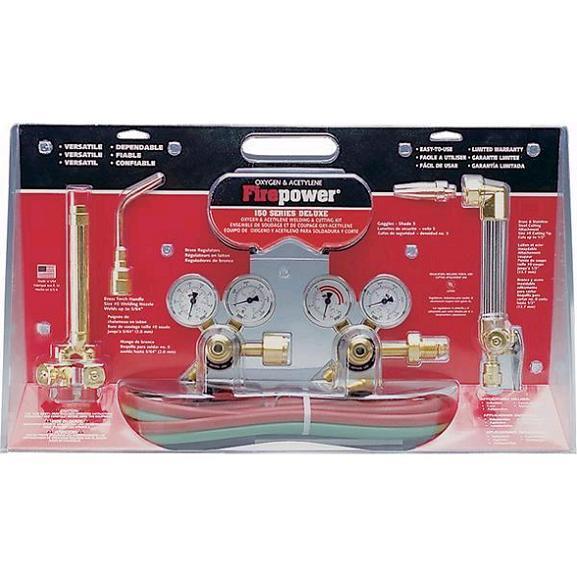

I've been eyeing this set.
I like the angle grinders.Get my 7' disks from Grainger and when they get smallish,I run them in the 4". Harbor Fright cut/weld set
Just for the heck of it I clicked on this link found in a Google search posted 5 years ago and low and behold the same set of cutting torches are currently on sell for $89. :D

I just went in with my dad on the large oxygen and and acetyline tanks. 250.00 each with the gauges, 50' hose, torch, and 2 welding tips and a sunflower tip plus gloves and goggles. They were both half full. We were using my brothers small portable tanks but the tanks seem to run out sorta quick, we were running 7 psi on the acetaline and 30 psi on the oxygen. The new large tanks seem to last a lot longer and the price to refill them is not much more than th small tanks. I found them on craigslist might want to check that out, also the set we got is victor.

I have 2 sets, a craftsman/victor in the shop roll around and a meco on my portable trailer. I have a professional / dental practice so I have multiple, like 14, tank leases so the tanks are not a problem and I use medical as it just costs 3 bucks more ( actually the same stuff, but don't tell)...
Anyway, 2 suggestions. One look at the cutting torch from Harbor Freight. I got 2 at 50 apiece and I love them. Better than the Victor and not bad when compared with the gold standard cutmaster. For 50 bucks they are amazing. Second, it is possible to buy older ( probably smaller)tanks at a sale and fill from a bigger bottle. I have mid sized tanks on the portable for O2 and I just link them with a filler I got from my gas company and I get almost a full tank and not a lot less in the big tank... which I use in the shop and take back and forth from the office.
