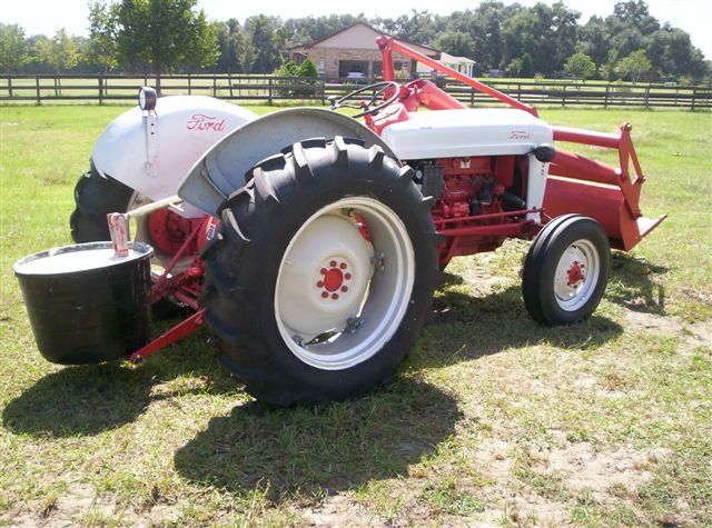

You mean like this one ? I got it from the local barrel company. It was a used juice barrel, only $10.00 without the head. They get about $20.00 for a standard oil drum with bungs all clean, painted and ready to use.
I hope to get some concrete in it soon.

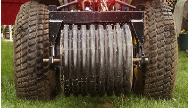

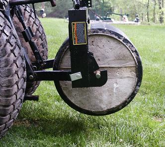

Finally got some pics of mine.

MD - Looks almost like you could use this as a roller as well.
