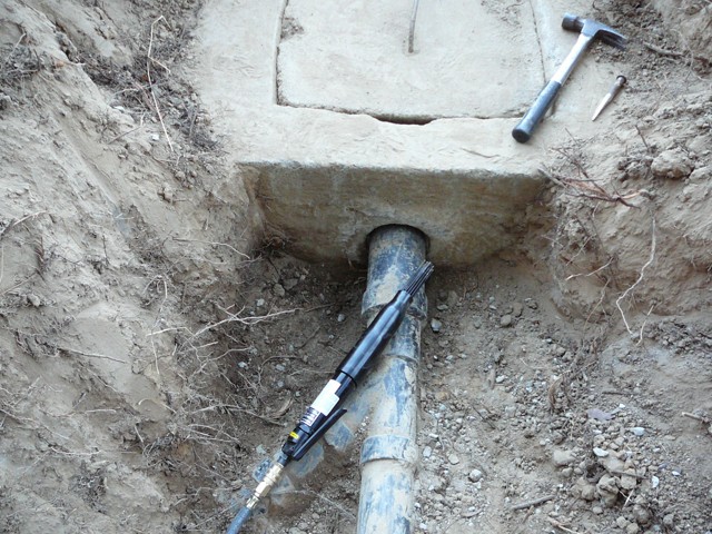

I had a similar application for air tools, a leak where a replacement plastic sewer pipe had been poorly cemented into the septic tank. Redwood tree roots were growing in and clogging the tank. I paid a septic pump company to repair it but whatever they did didn't slow down the roots at all.
I used a HF Needle Scaler (the larger one) to pulverize the mortar fragments that the roots had cracked. This worked great. A few moments work cleaned deep into the joint, progress I hadn't accomplished in an hour with chisels and wires. Highly recommended!
