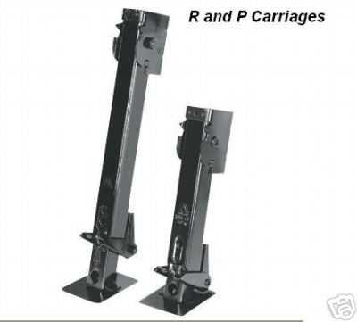

Spiker, Here is a pic of some stabilizer jacks I was going to use on the rear if necessary. They are about $40 a pair and thy fold down.

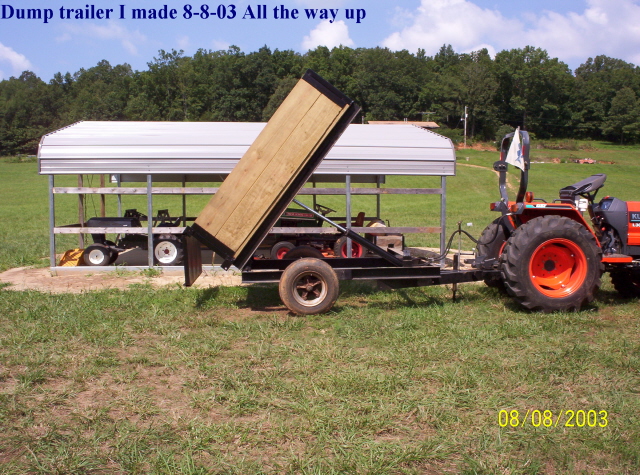

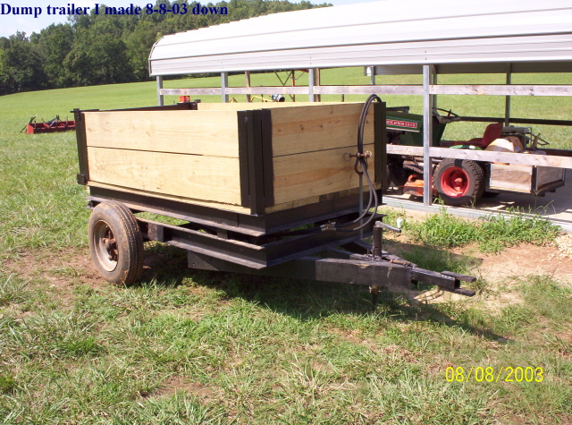

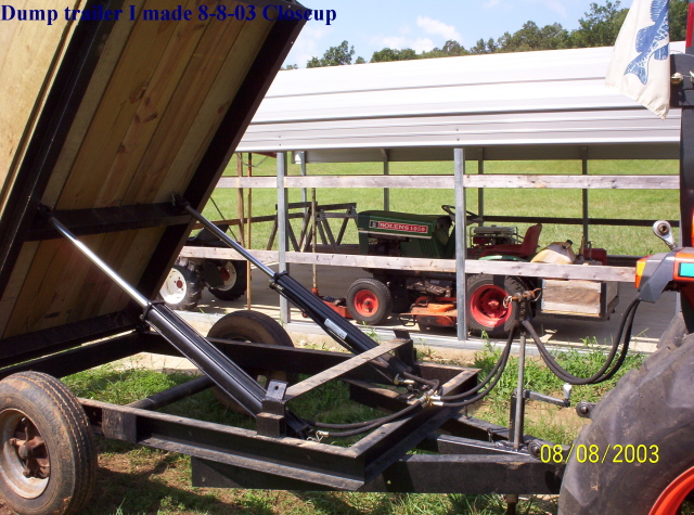

Here is the one I made. It's made with 4" C , 3'' cyl. At the time I had a L3010and that is all the trailer (when loaded) you want behind it. It's not the pulling, it's when you have to go down a hill. Put your axle back far enough then you can unhook and load, just make sure you don't forget to put something under the front jack. You well not need a rear jack then. The dump angle is 54 deg. when all the way up. If the load hangs up it just pulls up on the front about 20 t0 50 lbs.
I went with one axle because when loaded I wanted to be able to jackknife without any trouble. I sure can tell you for sure that little traler well hold alot of weight. I run with around 70lbs of air in the tires and when its loaded with the old wet pond dirt the tires well look like they about 1/2 full.

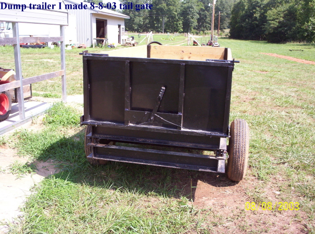

I forgot to say, make the tail gate so you can remove real easy. I didn't mine. That is what I got to do with this one. Got in a little trouble with large rocks hanging up. Other then that it has work out well.

Steve, have you looked at any manufactured trailers lately. 3 x1.5x3/16 channel iron is over kill compared to them. The frame and tongue is going to be box tubing and the frame for the bed is going to be channel.
Bill
Bill:
I have 2 of these http://www.harborfreightusa.com/usa...o?itemid=42950&CategoryName=&SubCategoryName=
which I think I paid around 20 each for on sale at the local store.
I just have not put them on as i have been using it for wood mostly lately and there is no worry about getting too much on the back as it stays on the tractor and I hand toss wood in then pull out of the woods.
The problem only lays when I disconnect the trailer park it and start loading it with the tractor bucket. I usually do this with gravel and sand out of the creek bottom or with dirt. even then loading usually is not hard, just need to load front half first. real problem lays if loaded pretty full and re-attaching to the 3pt. the coupler would raise UP if not right on the BALL this raises tong up and if the load shifted much then it would go backwards. I wanted the crank down/up as when loaded with 2.5 yards of gravel the 7K mobile home axle compresses enough to maybe bind up a solid mount, i have been simply sticking a hunk of firewood under the back. works well & just drive off not worry about it needing cranked down.
I haven't decided if I am going to put a tailgate on it or not. Do you have any thing over the wood floor on the inside. I wasn't sure how well dirt would slide on wood. I was thinking of using wood and putting a piece of liner like we use in the dump trailers at work over the wood. I wouldn't have to lift as high with the liner.
