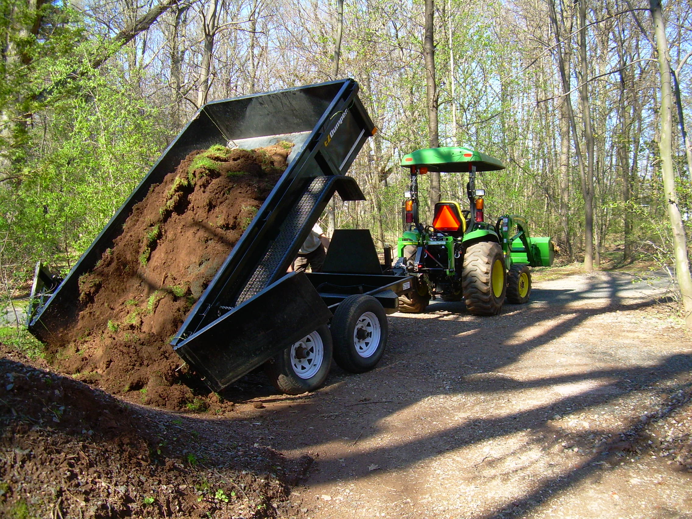

The uncontrolled 3pt rise is a real concern, but can be taken care of with a limiter chain attach to extended draw bar.
When I dump the 5 ton, just before the load slides out there is a tremendous upward load on the hitch, but the chain controls it.
JB.

JB thanks for the pics. Now I know how to hook the chain to limit the TPH lifting while dumping.

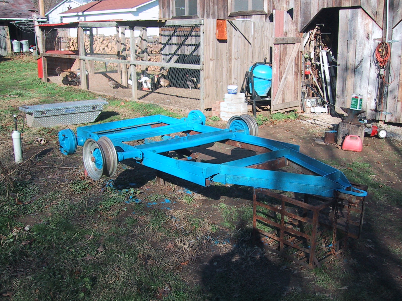

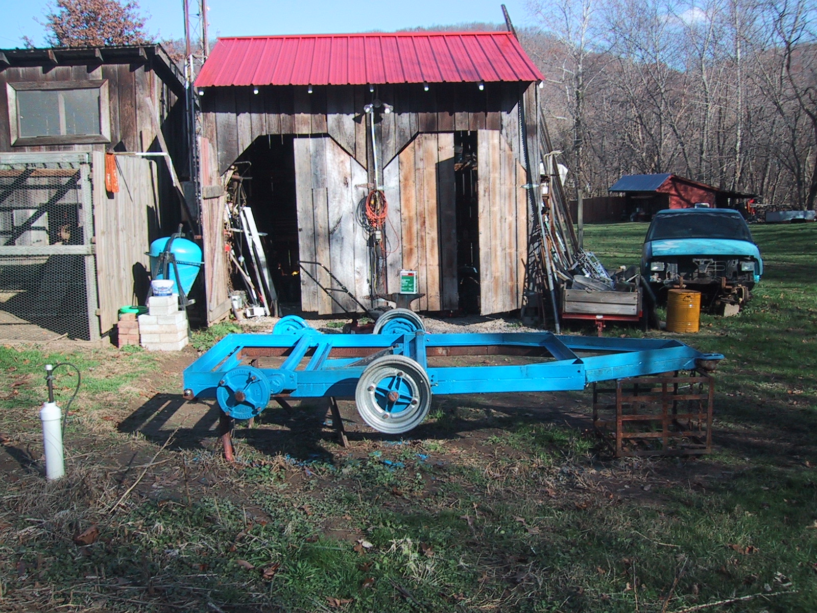

I have started one about two years ago but haven't finished yet. Is 5'X8' here is picture
