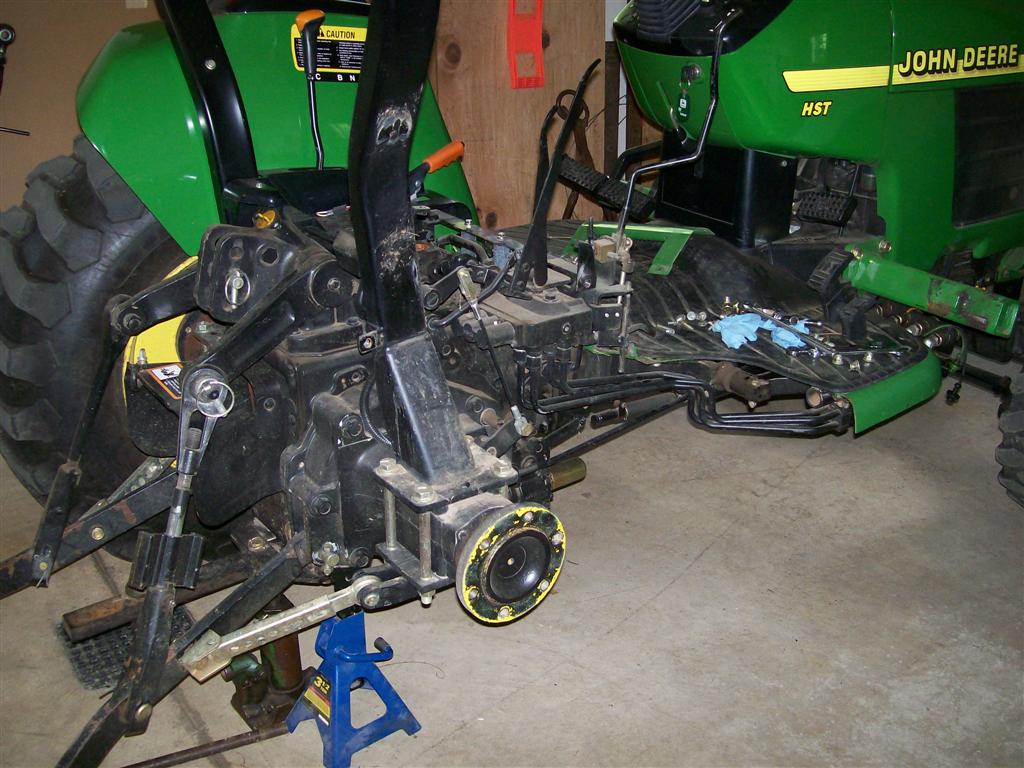

Where is the correct jack placement, to enable me to remove both rear tire/wheel's, so I can swap their position. The dished wheel right/left swap will provide the added width I require. The only place I feel appears correct, is under the Rops attachment point, under rear axle, where there is a relatively flat spot. Only issue is I need another floor jack, since once placed in that position, there is no room for a floor jack stand. Any suggestions?
/ Changing Rear Tire Width #2
Put the floor jack under the bracket that the drawbar slides through, to either side depending on which side you want to put the jack stand. Then move to the other side of the drawbar to lift to place the other jack stand.
Block the front wheels well so they cannot roll forward or back. Also, don't lift the tire more than just enough clearance to remove the tires. Do all loosening and tightening while the tires are still tight to the floor. Not while they are sitting on the jack stands.
Move slowly and safely.
Here is pic showing the bottle jack and jack stand. Floor jack works in same place just as well.
I just flipped my IND rears around on my 4300 yesterday. (I gained
only 1.25" inch width, however.)
What I did was use 2 scissors jacks, like the kind that comes with many
cars. I have a bunch of these and I love them in that they fit into tight
places, are hand-adjustable, and can be used in out-of-vertical orientation.
I put one under each axle housing, right at one of the bolt bosses. The
footprints of these jacks are smaller than my jackstands, so they do not
interfere with the tire. You can buy these jacks at AgriSupply for $15.
If you only lift the wheel so that it barely clears the floor, you can remount
them by starting one bolt without perfectly aligning the wheel, then rolling
the wheel around that one bolt until it settles onto the flange. If filled,
you can use a long steel rod for leverage.

If swapping the rears with only one floor jack, I first jack from the center as
above. Then I remove the wheel and place a jack stand under the wheel
flange. Then I move the floor jack as far to the other side as the remaining
tire will allow. Now jacking up to remove the remaining wheel has to be
done extra-carefully due to the side-to-side imbalance. That is why I have
moved to a 2-jack procedure.
