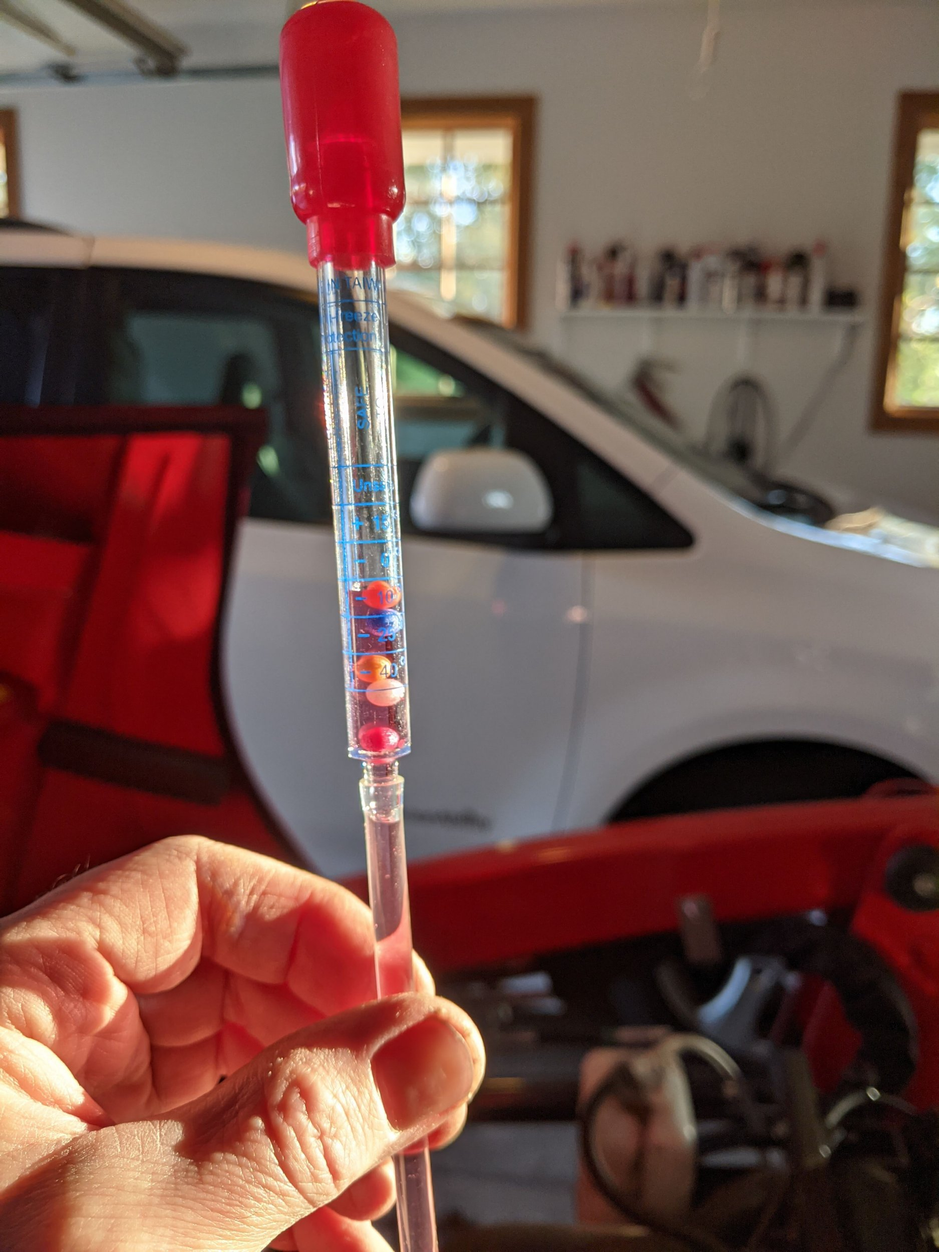

Anyways, today I stumbled on my el cheapo coolant tester, so since it's in my hand, why not. Tested the coolant and found this:
Maybe I don’t understand how to read that tester, but looks to me like it’s good to -40? If they were all floating it would be ‘unsafe’?
Yup, I totally hear ya, I'm also confused by the gradients on the tester. But really it's all about how many balls are floating vs sinking, the fewer the worse.

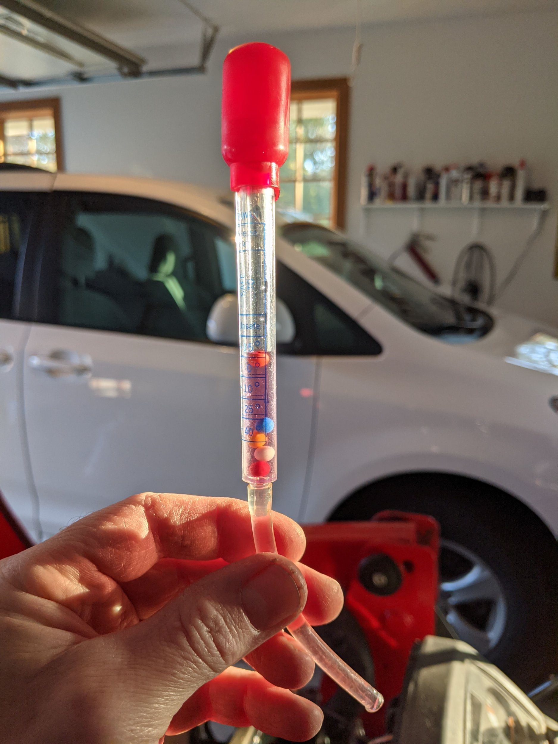

So, found something interesting today. I changed coolant last year on my GC1710, used this stuff:
I had no intention of changing coolant this year, not as though the tractor is a daily driver or anything. Anyways, today I stumbled on my el cheapo coolant tester, so since it's in my hand, why not. Tested the coolant and found this:
I thought maybe there's a problem with the tester, so tested some of this same coolant leftover in the container, and got 3 balls floating from that (safe to -10 deg). So yeh, this is surprising, and looks like I'm changing coolant this year after all.
