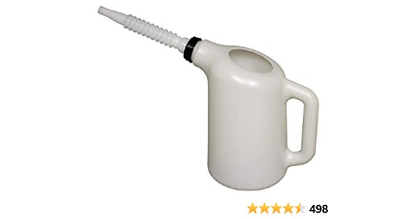

Stupid question incoming...what's your method for mixing from concentrate? Just take an empty gallon jug and pour in half coolant and top off with distilled water? I'm on a well, so definitely wouldn't use my tap water.
   / Changing coolant yearly or lack thereof. #22
Usually use one of these types of jugs and a graduated cylinder to mix the concentrate.
My jug has volume markings on it that I use for the distilled water.

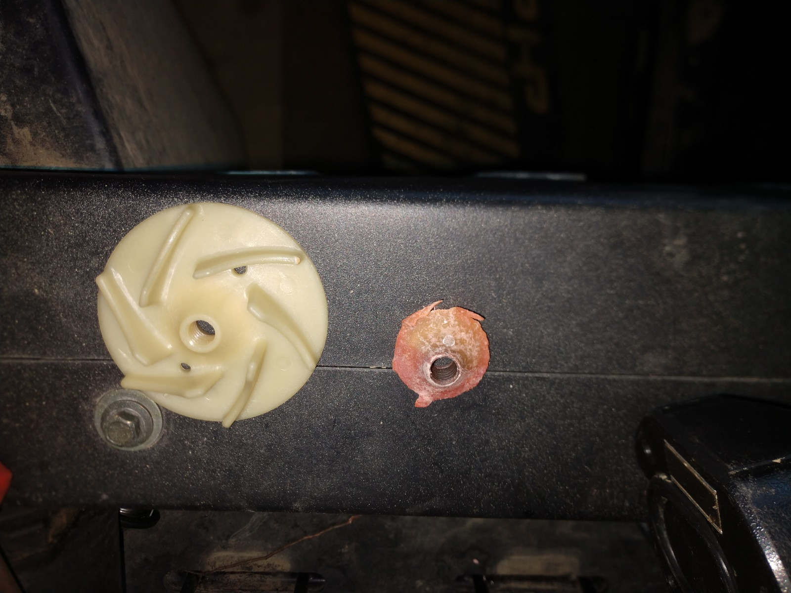

As I mentioned in my first line these new coolants are not compatible with each other or the old green stuff.
An example of what can happen with one of the new "long" life coolants and the old green stuff.
The first picture is after I couldn't figure out my over heating problem, after flushing and refilling a system.
It had run for several days and then overheated one night while it was idling and providing lighting for late work.
That was the internal of the water pump, the second picture is the impeller from the water pump the new one compared
to the old that chewed itself up trying to pump a waxy hard setting material. It toke considerable cleaning and several
chemicals to get the engine cleaned out.
