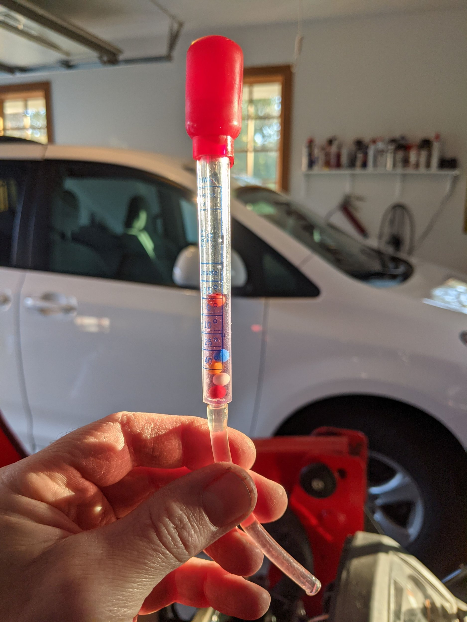

These are good points, fellas. Maybe it is the tester too, will pick up a new one at TSC today. In any case, looks like a year in the radiator degraded the coolant, which is strange.
When you changed the coolant the first time, did you warm it up to make sure it all mixed with whatever you didnt get drained out and retested? Have you at any point (or anyone) topped the coolant off with straight water?
The ONLY way I have seen coolant loose freeze protection (especially in as little as a year) is dilution.
But to me, that doesnt warrant a replacement of fluid.
Simple math. Figure the system capacity, what the current mix % is based on freeze point to figure out how many gallons of straight need to be added to get the 50/50 mix. Then only drain that amount and top off with straight.

OMG, you figured it out, my post is a big lie! :rolleyes:
That is not what I asked nor implied; the tester image does not show the right color and it also does not register anywhere near the -10 you said you got out of the jug. Even if one did go bad that is too big a variance without adding a huge amount of water.
As far as i can guess your coolant got mixed somewhere, I do not recall seeing that color used for anything aside from RV.
It is not exactly uncommon to have ... stingy gas stations crossmix coolant to get rid of old stock.

The original coolant was the standard eth glycol green stuff. What I did at the time was drain from the drain tube, flush with distilled water till clear, plugged the drain and then ran the engine to warm with distilled water, then drained that. After that, drained the water, then poured in this STP stuff until red started coming out of the drain tube, plugged the drain tube, topped off the radiator, and drained/flushed/and filled the coolant overflow reservoir.
What I never did do was drain the block (the manual states the drain tube drains both radiator and block), so maybe there was reserve water there which diluted the premix coolant?

That’s my suspicion that the engine wasn’t sufficiently drained and diluted the coolant. It’s possible that tester doesn’t work right either but the color looks weak so I suspect it’s diluted. I agree with you on the pre mixed stuff. It just takes a minute to mix it with water to save $10 a gallon. I always just use tap water but distilled water is cheap if you want that option.
   / Changing coolant yearly or lack thereof. #19
That would only be the case in the other direction, there would not be enough leftover to make the freeze point lower unless it was concentrate.
The meter age is a valid comment, I had forgotten there were two types. When they first came out with the new ones they used to say not to be used with whatever the old coolant type was.
Edit: ethylene glycol and propylene glycol. They have very different gravities.

Hmm, good points. Yesterday, I drained off some via drain tube, and topped off with whatever I had leftover from the gallon container. After that, I was on the tractor all day which should have mixed all that up. I'll check it again today.
