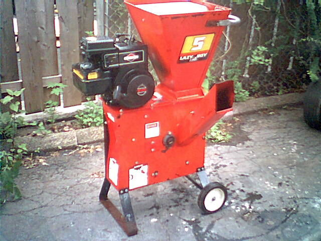

I have an MTD chipper shredder w/ 10 HP BS engine. Compression is too great for easy pull start, so would like to modify power input to PTO on my Ford 1210. Two main issues--BS motor is 3600 RPM, PTO is 400-540, and PTO turns opposite direction of BS motor. Ideally I need a 6:1 gear reduction (increase) box that also changes direction of rotation. Somebody out there must have tried this. Would like to hear from anyone with recommendations.
I had this 5hp hard starting chipper/shredder. I took the pull-rope assembly off and chucked up a deep well socket onto a cordless drill and started the engine with it. Don't try it with an impact driver. Make sure to remove the socket and drill as the engine begins to fire or they could go flying.
