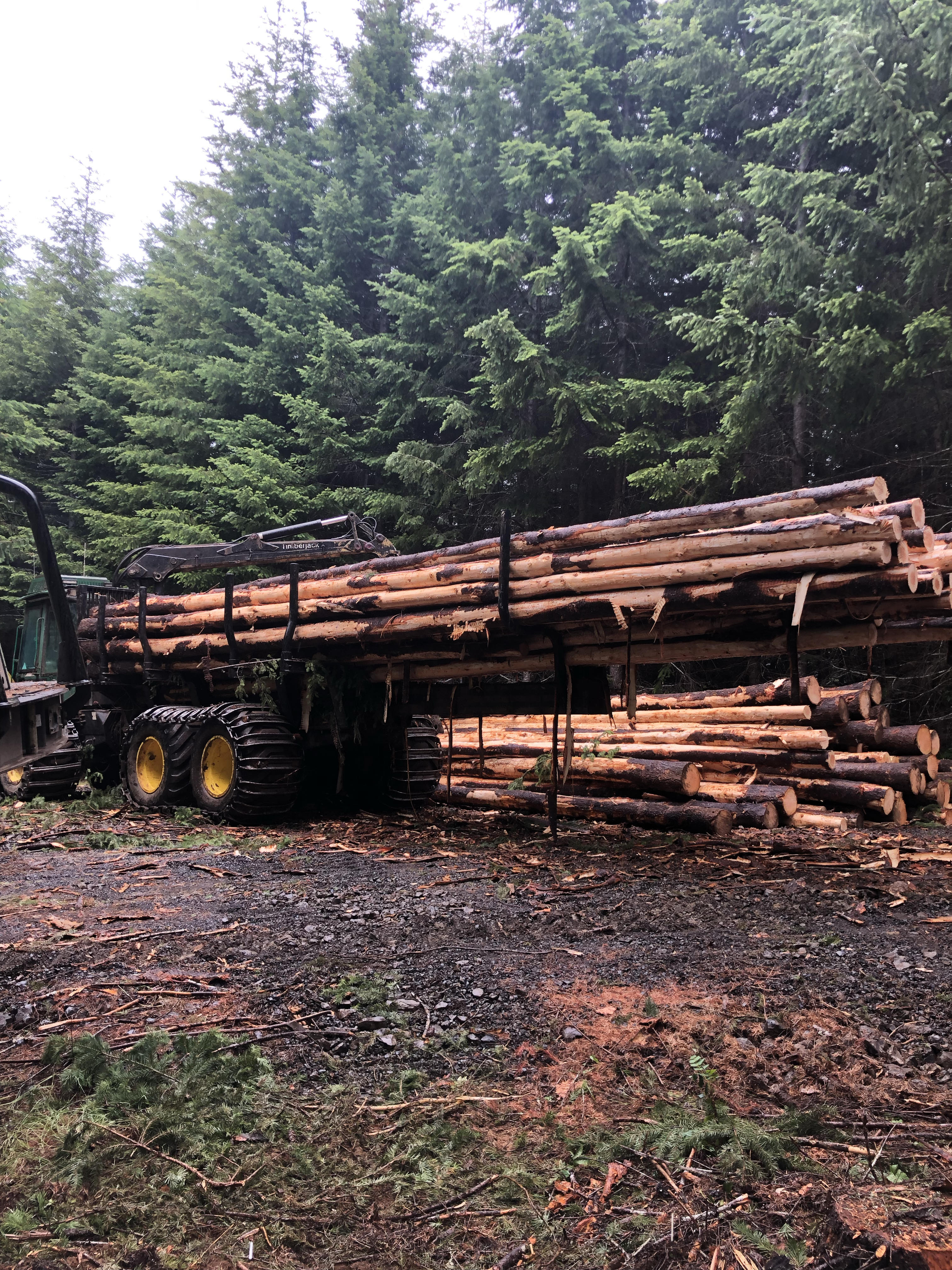

The east coast is much smaller scale then out here on the west coast, for out here I’m small with 3 guys that’s includes a truck driver. As far as innovation a lot of it has been happening out here, just across the river from me is where the two tethering companies are. IMG_1051.jpg
Here’s some of the innovations we’ve had to do the last few years since none of our mills out here will take short logs anymore. That’s a load of 37’ logs on a TJ1210 well doing a thinning in 25 year old Douglas Fir we do about 75 to 80 tons of those a day depending on how the truck is setup that day.

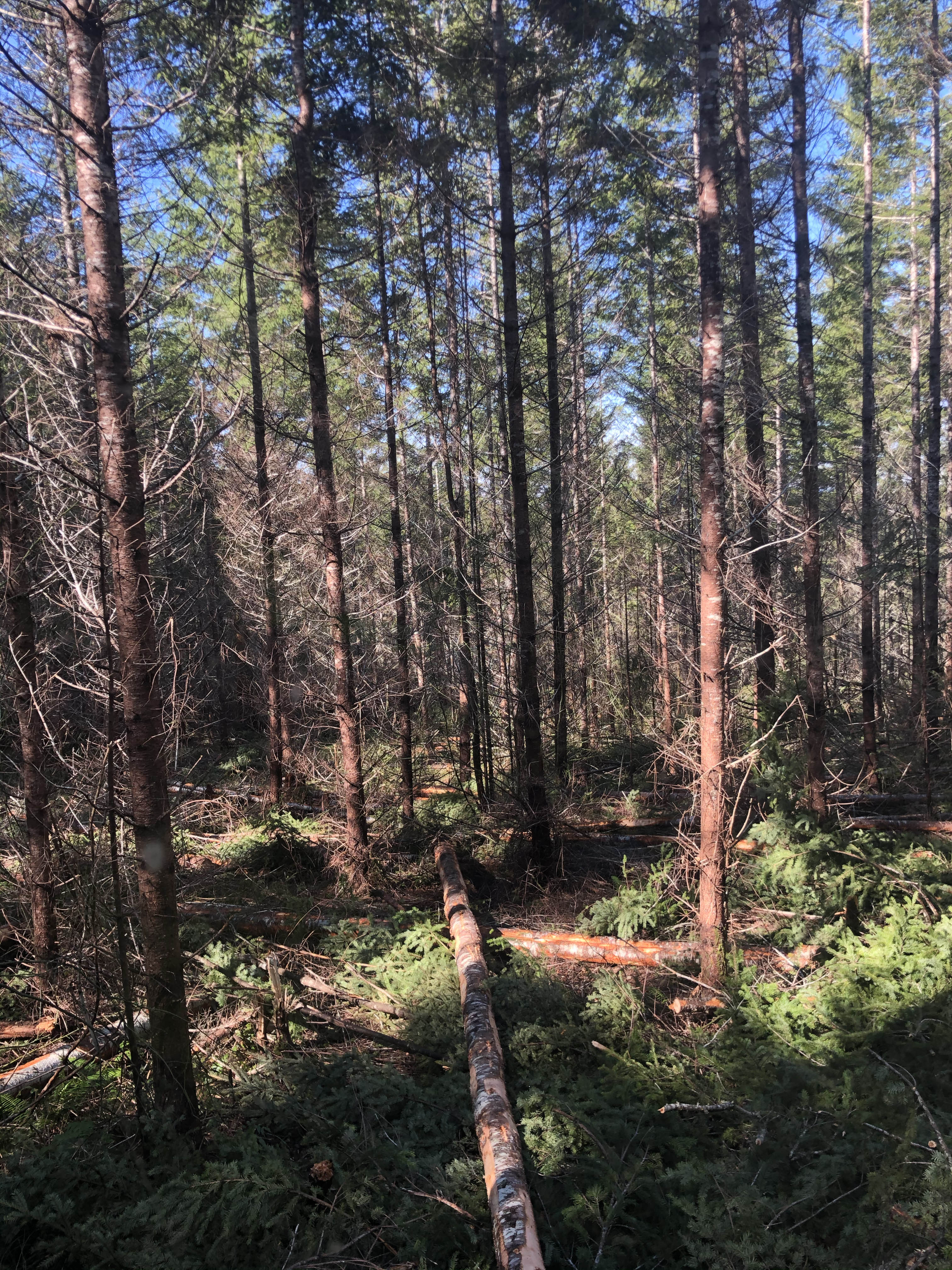

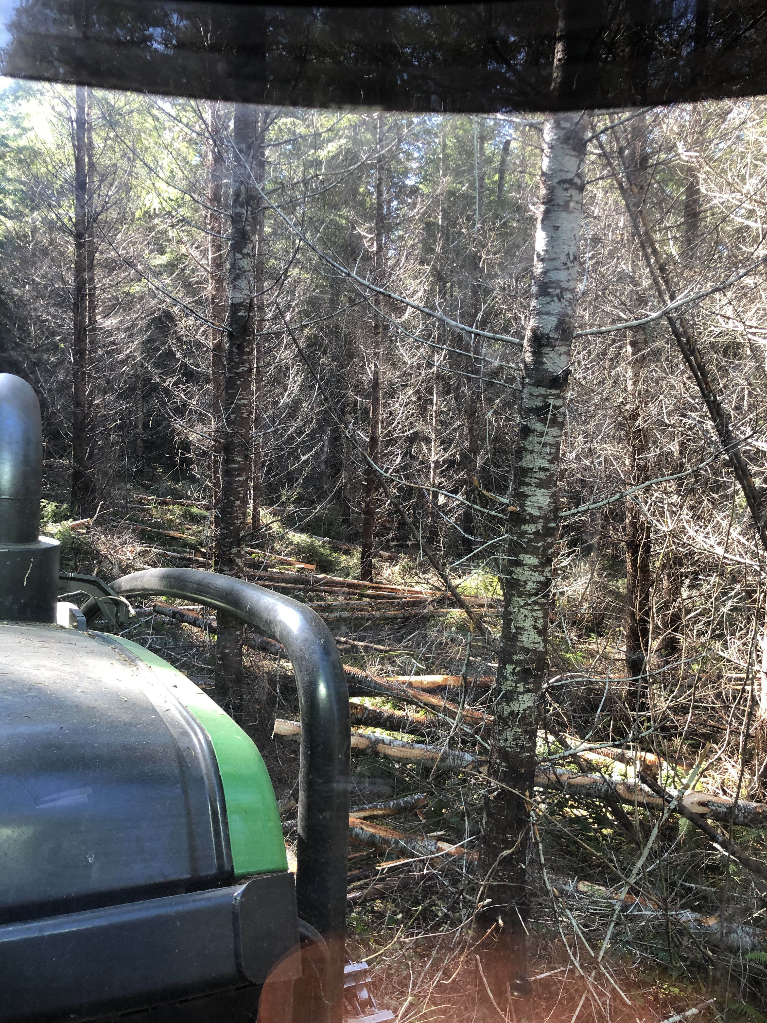

These are some of those thinnings I’ve done in the past impact is as close to 0 as possible most of the trails are a one and done setup.
