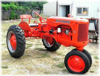

40 years ago I was a kid in high school. It was spring, about 2 weeks left in the school year. I was a farm kid and so when I got home from school, I would do the evening chores (milk cow, feed horses, chickens, etc.) and then grab the chainsaw and head out to the woods to cut some pulpwood (a way to make spending money). That particular spring day, as I was gathering up my axe, chainsaw, gas can, etc., my Mom asked me where I was cutting, which was about a quarter-mile into the woods from our house. She told me I was wasting time and energy carrying everything to and from the spot I was cutting at. "Take the tractor", she said. Hey, who was I to argue with Mom? I strapped my stuff onto an Allis Chalmers "C" tractor and headed for the woods. Little did I know at that time that those three words from her would save my life.
I was cutting 12" poplar trees. I had dropped a couple of them and was trimming off branches when I made a mistake and buried the saw bar into my left knee. Unknown to me at that time, I had severed the patellar tendon which made my knee as useful as a floppy door hinge. With the tendon cut, I had no muscle control over the lower half of my leg so walking on it was impossible. I crawled over to the tractor and spent an unknown amount of time getting up onto the seat. We didn't have the backrest on our "C" which made it easier but that fender to fender seat was still a challenge to get up onto with only one working leg.
I got the tractor started and headed down the logging trail, as fast as I could manage, towards the house. Every bump I hit hurt like ****. I made it to the house and my Dad got me off the tractor and into the truck for a no-holds-barred race to the little hospital in town, about 20 minutes away. The OR staff was already waiting for us by the time we arrived. I was in shock but otherwise doing pretty good from what I was later told. After a couple of hours in surgery, I woke up in the recovery room with a crotch to ankle length cast on my leg and some stainless steel wire holding things together. I would go through three casts in the upcoming 9 weeks and spend the remainder of the summer on crutches.
I still cut wood alone to feed our woodstove here on the homestead in northern MN. I wear chainsaw chaps, safety boots, and a helmet with eye & hearing protection. I still take a tractor with me into the woods but now it's a much newer hydrostatic drive MF 1529 which doesn't require a working leg for a clutch. :D I'm probably more careful around chainsaws than the average cutter and amazingly, my knee doesn't even hurt when the weather turns cold! :)
For those that don't know that an AC "C" looks like, here is a photo of one.

I'm glad you recovered well, Arizona. Those old AC's have enjoyed a lot of popularity here in Missouri too.
