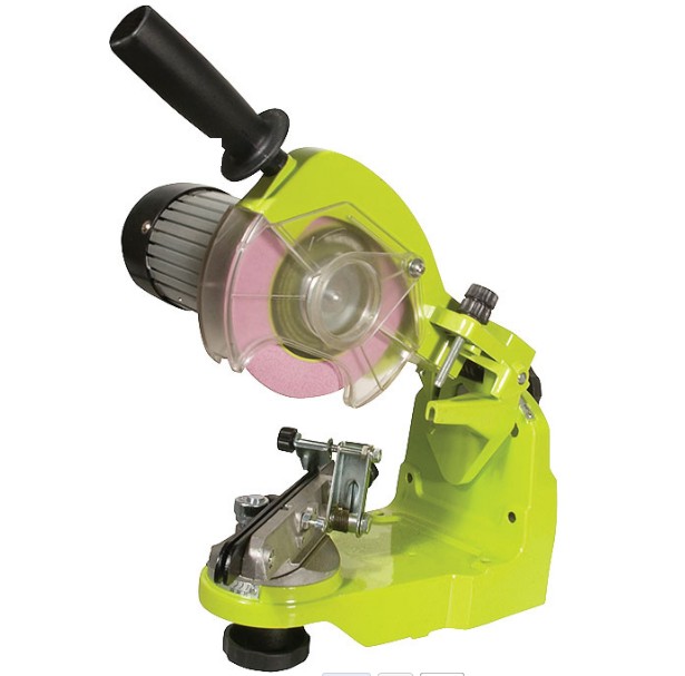

I used to sharpen saws with a file and have files, angle gauges etc, but with old age comes not necessarily laziness but a will to do it easier. TRIFOCAL glasses dont necessarily contribute to good saw filing either. I can remove the chain, put it on the little sharpener and grind every tooth in less than 10 minutes on an 18" bar. It takes me at least that long to do with a file sometimes longer depending on how many cramps I get in my hands. Using a file to sharpen a saw is indicative to using a mule to plow with, or slide rule rather than a calculator. It's OK if you're into that sort of thing but I prefer the new ways rather than the old way when it is as cheap to do as the HF sharpener and it does an adequate job for me. Maybe some folks can make them cut better than new but I never could and the electric sharpener gets every tooth perfect on angle and length everytime, it super easy to use too.
My cousin and I bought one and love it! I am a tri focal guy as well, lol. They come on sale every so often at Princess Auto, ours was reg $189 we got it for $100. We have about 8 chains between us and can get er done, if we have to, I guess lol.
