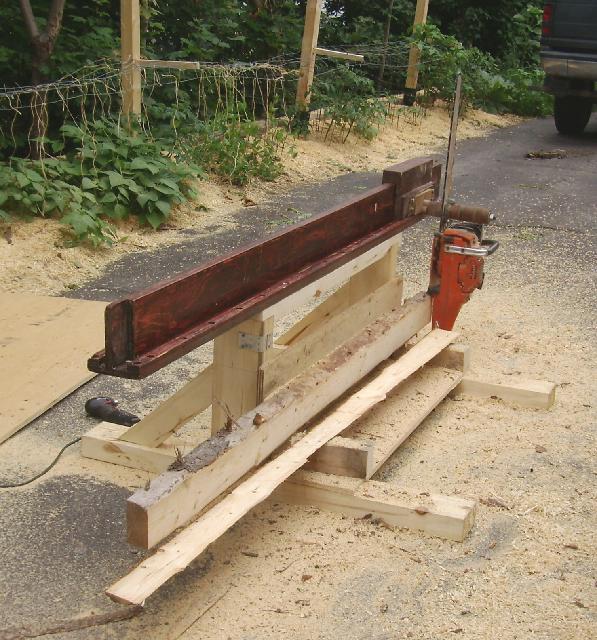

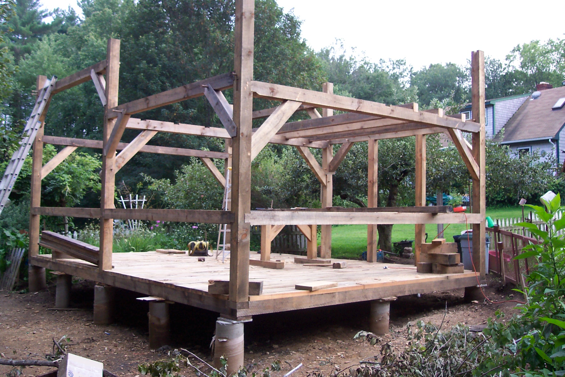

I have a Logosol M5 mill, I love it . The pictures are from last winter, this was when I was cutting beams for my up coming barn project. Oh a BIG Saw + a sharp chain = good lumber

that's some great looking joinery you got there!!!
