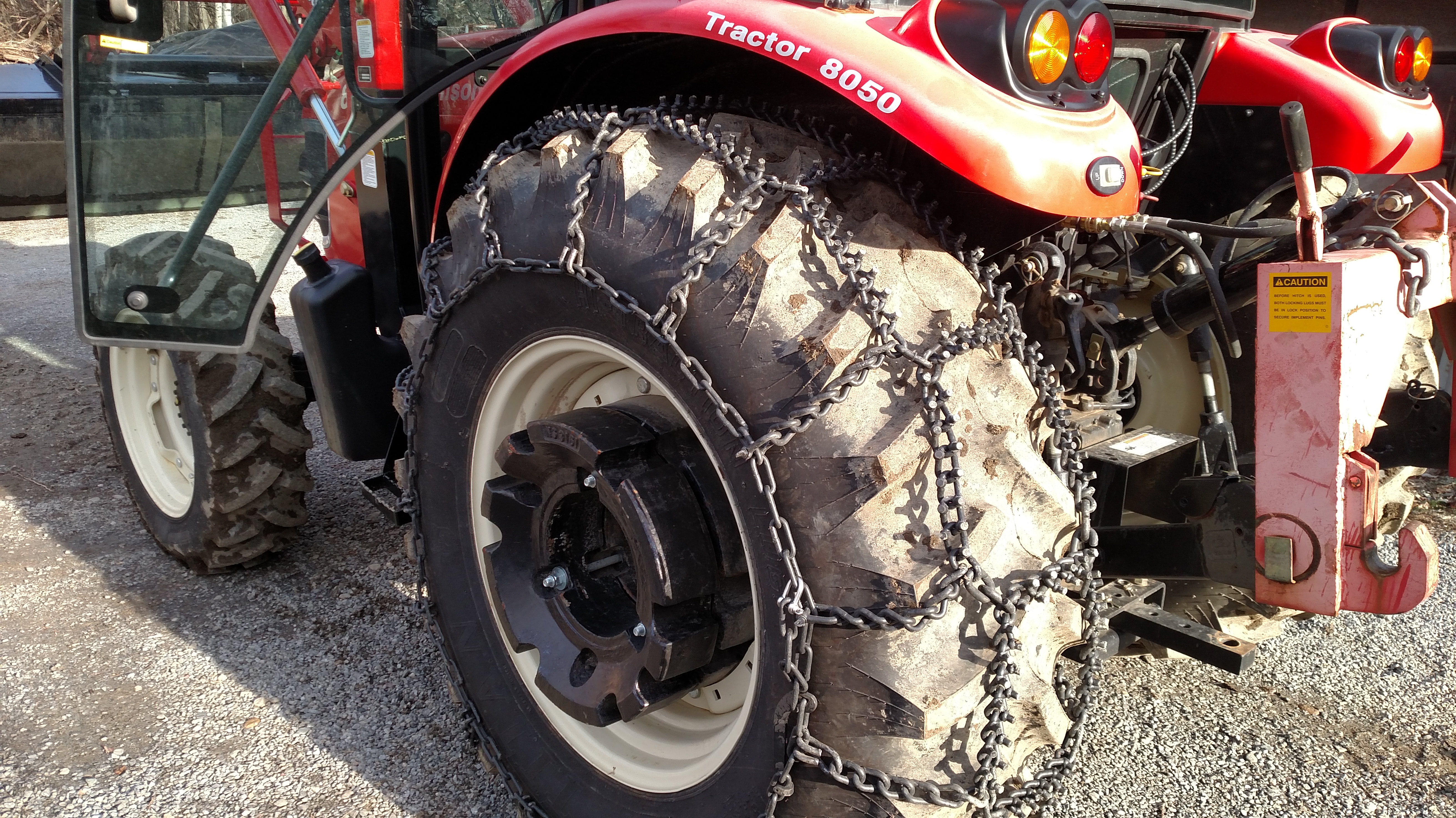

Over many years I have used and bought most all of the different styles of tire traction chains available,
It has come down to the point where I will only recommend one style and that is the euro studded style such as the Aquiline Talon.
This style of chain will give you excellent traction a smooth ride and will not tear up your driveway unless you spin them considerably
trying to push more then you should have.
A link to this style on ebay they are available from many places;
Wallingfords Aquiline Talon 1-16.5 Tractor Tire Chains - 1165AST | eBay
I know of no one that has used this style that wants to use any other unless in deep woods snow for which they would lean to skidder type ring chains.

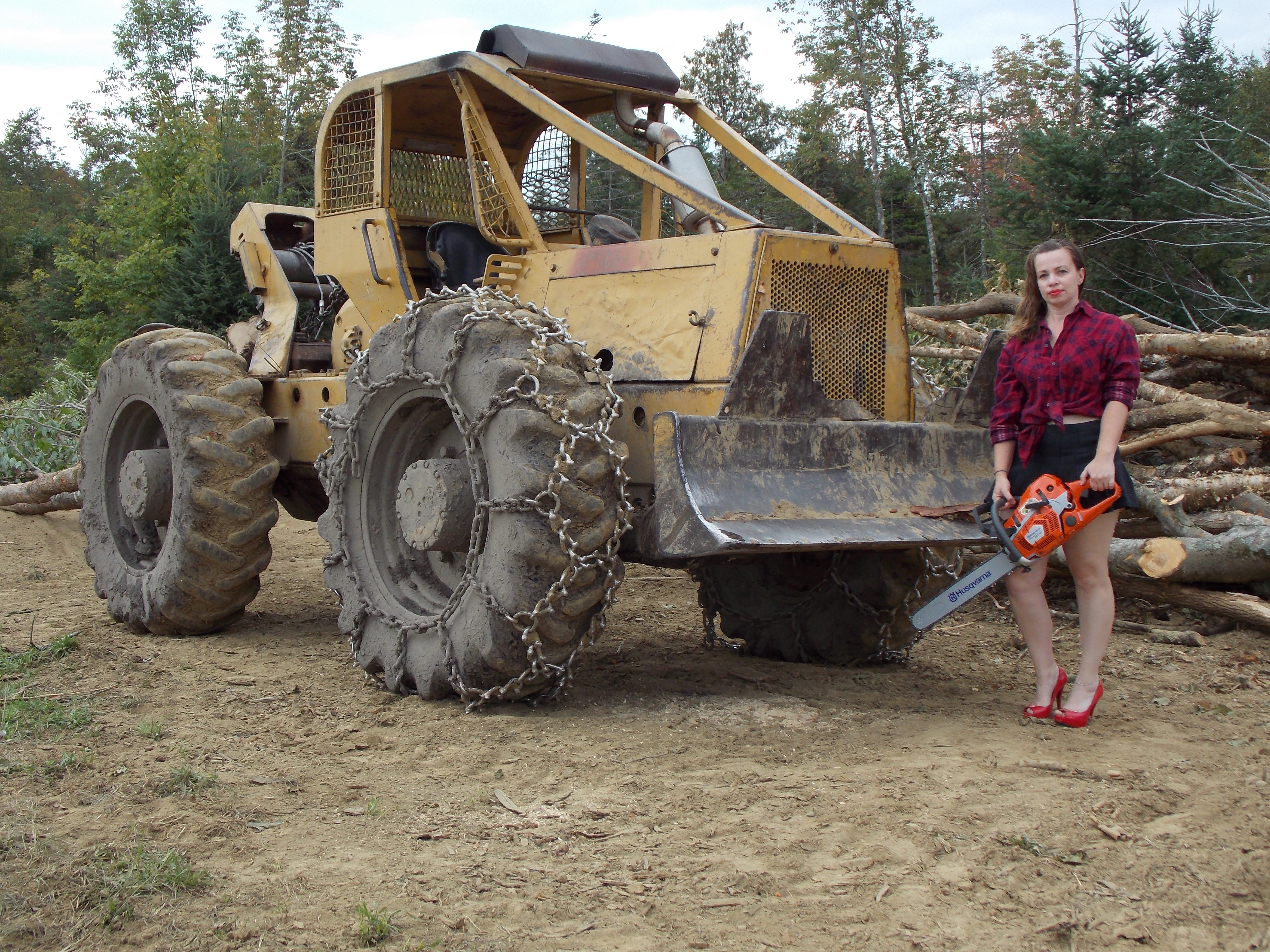

I could not agree with you more.
Ring chains can be mechanically detrimental to even skidder in my opinion. Their constant slip-grip can really damage the ring gears on the rear ends of tractors and skidders. Some may disagree, and granted this is an old junk Cable Skidder, but I only run diamond studded ice chains, and on the front tires only. If I run chains on all 4 wheels, or chains on just the rear tires, it tends to lift the front end off the ground. That does not get wood out of the woods any better, and tends to cause breakage.
These chains are all wore out in this photo, but they have earned their keep too.

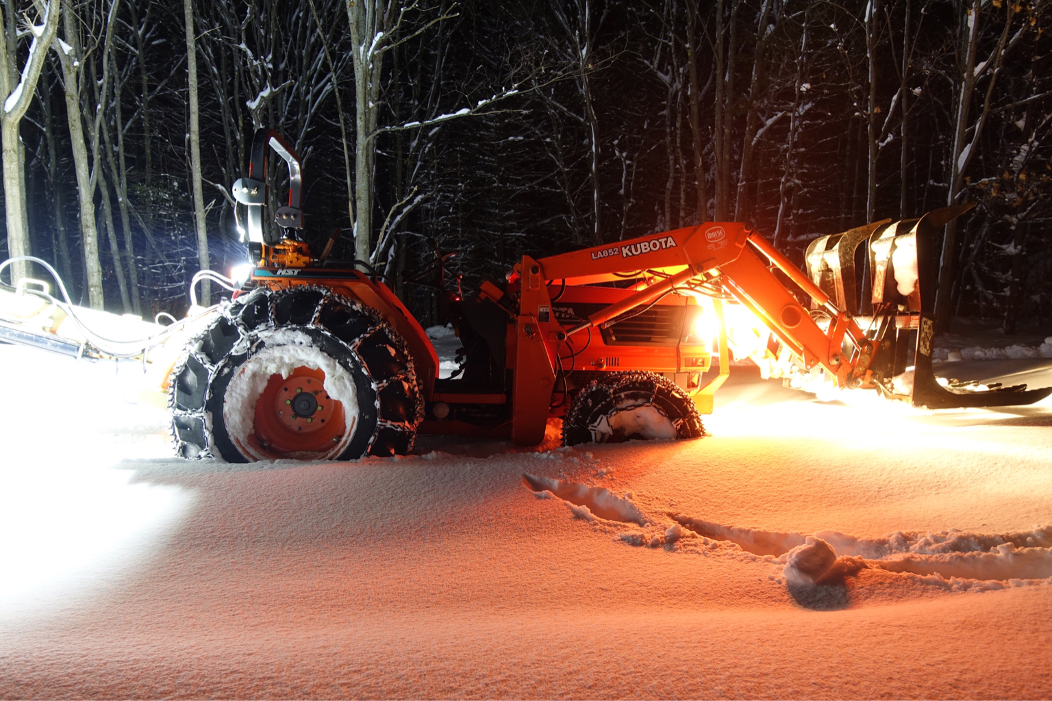

Since you live on a dirt driveway, I would absolutely go with studded ice style chains if you can get wheel spacers. This year I purchased OFA EKO 9 chains for my rears, and EKO 8 for my front tires. I purchased from Windy Ridge Corp in Tamworth, NH and they had a lot in stock.
I would not have been able to plow my dirt driveway without these chains on multiple occasions this year, and I do not have a hilly driveway, I just could not push/pull all that snow without them. I can't recommend this style chain enough.
I previously used 4 link ladder chains, which admittedly, were a huge improvement to no chains at all, but they simply do not compare in any way to the capability of the studded chains.
As mentioned, the L47 is not a standard tractor, it is an industrial beast of a machine compared to most of our compact tractors. It's meant of a commercial application vs. homeowner application. That is a very nice machine you are purchasing!
I'll never go back to ladder chains after this winter we had.
