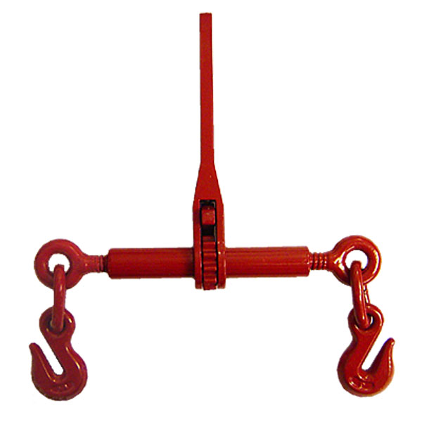

The ratcheting mechanism on a binder work off of the same principle as a ratchet strap.
Same principle doesn't mean much when once is made much "beefier" than the other. Regardless, I'm pretty sure everyone is referring to lever binders, not ratchet binders. I think for that very reason, they just aren't as trusted. I do see a lot of them on trucks though.
Does anyone know, those ratings on ratchet straps, are they for the strap itself or the ratchet mechanism? Or both as a unit I suppose?
   / Chains or straps? #43
Dmace; Wonder why tractor trailers have been using them for years?
Show me a tractor trailer towing heavy equipment with straps. You may see straps on these little homeowner tractors or bubba's atv but I guarantee those hauling excavators, backhoes, skidders, etc... have chains.
I'm talking about Chain Binders, not Ratchet Binders but even the ratchet binders use a real thick heavy duty locking key vs. the little key on those ratchet straps. Also, the ratchet binders are loaded completely differently. The ratchet is only holding the hooks from spinning whereas the ratchet straps put the entire load on that little key.
