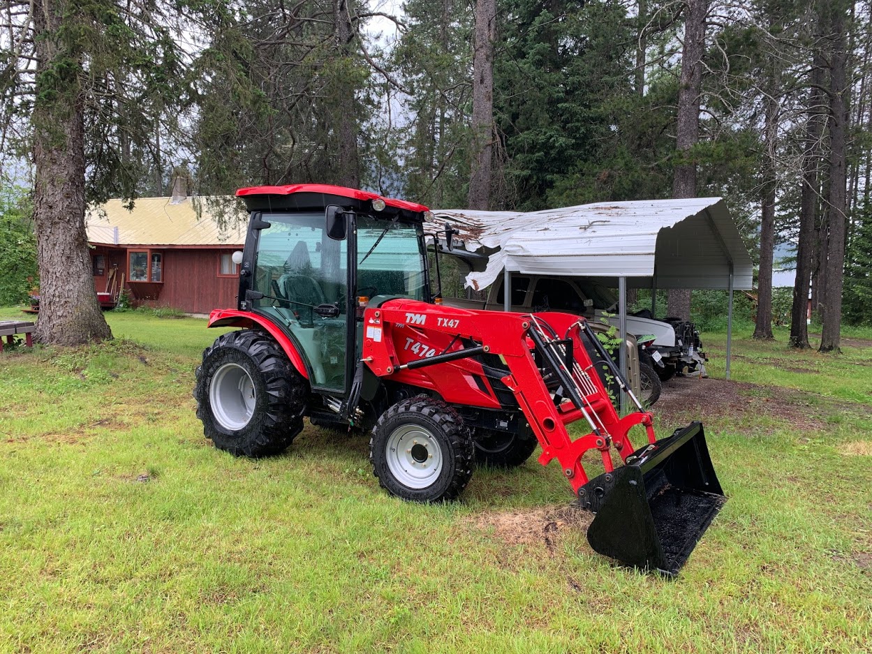

The dog was a picture of my spirit animal on how I feel most days anymore. Well back to snowremoval on sheet of ice, yes I did what you with my halfton truck plow. Plow downhill in most cases......and with a snowblower there won't be nearly the same weight to deal with either.
Here is the rig btw, 2019 TYM T474 48.3Hp
   / Chains on rear wheels only with inverted snowblower #8

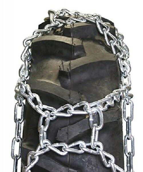

With that mule and those rear fenders I hope you have 3 inches of clearance at the front edge of the fender as otherwise 4 link V bar chains will not work.
If the chains do not fit you will need to have the rear tires loaded and invest in a set of 4 link V bar chains for the front tires or invest in combine tires and wheels to make room for chains.

I chose these H-pattern DUO239 7mm alloy chains for the rear since I have limited fender room on the front of the rear fender.
