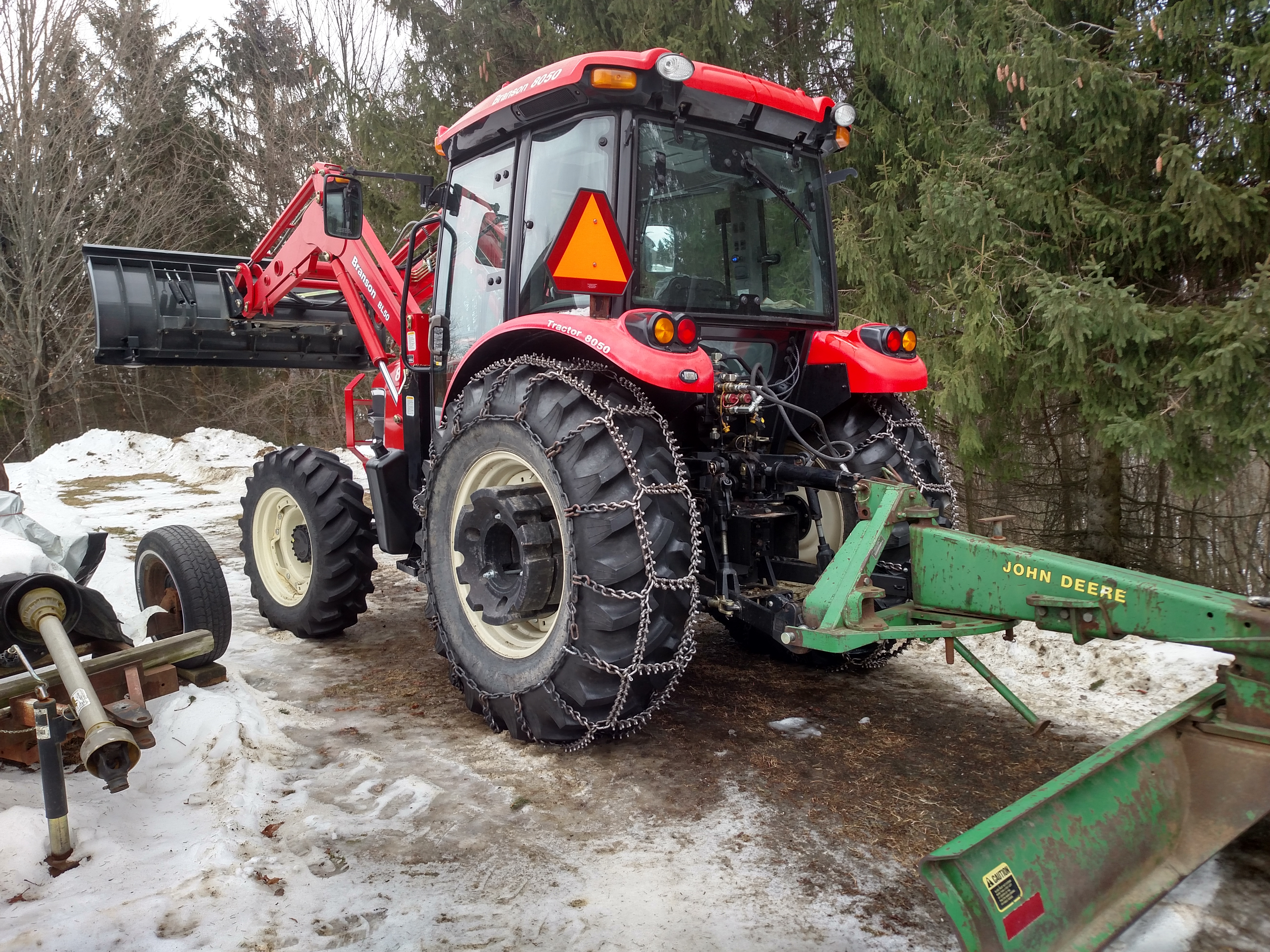

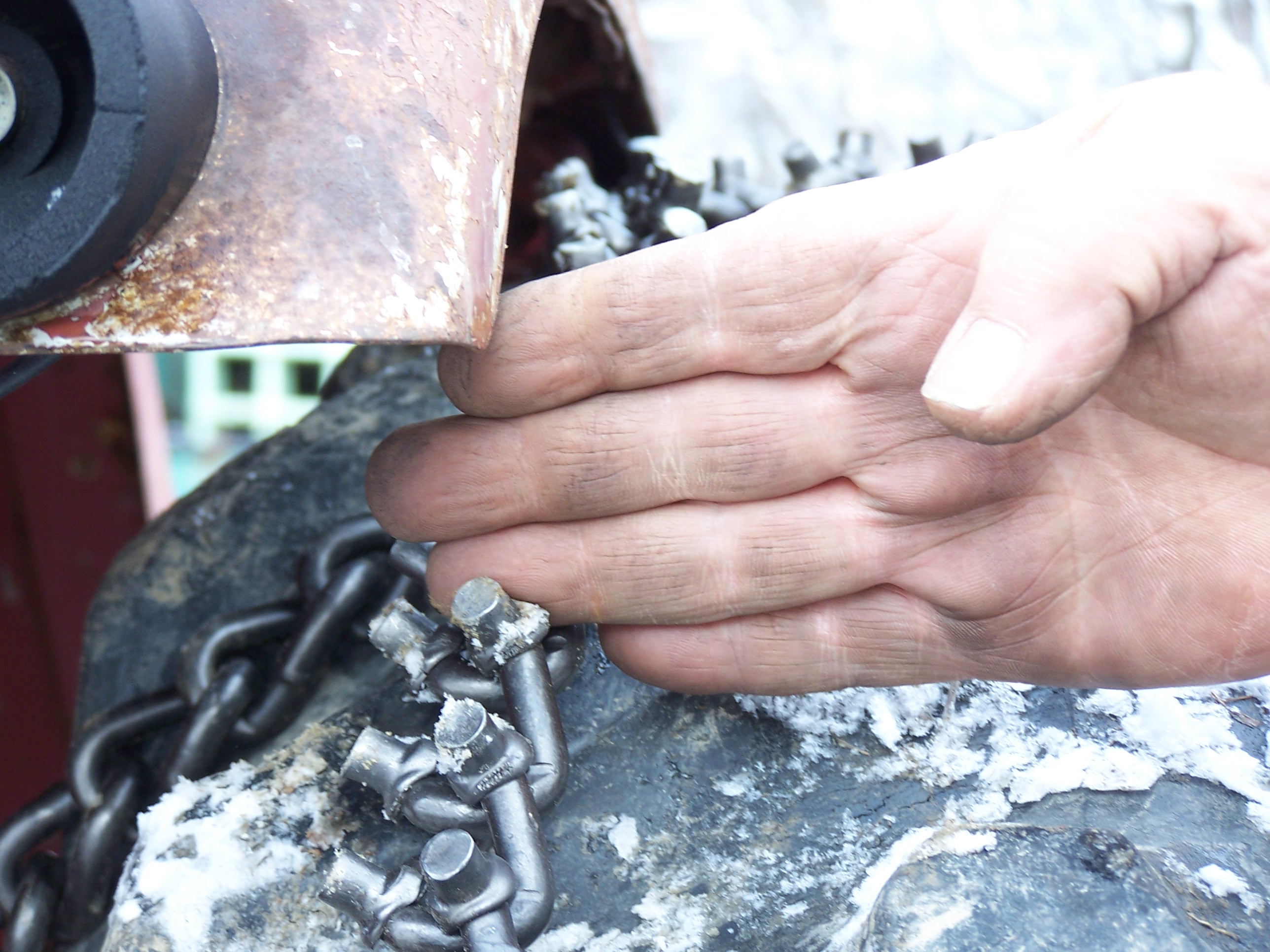

The duos are very good chains, If I were you I would ask your Tym dealer if wheel spacers
are available for your mule to increase the clearance from the fenders.

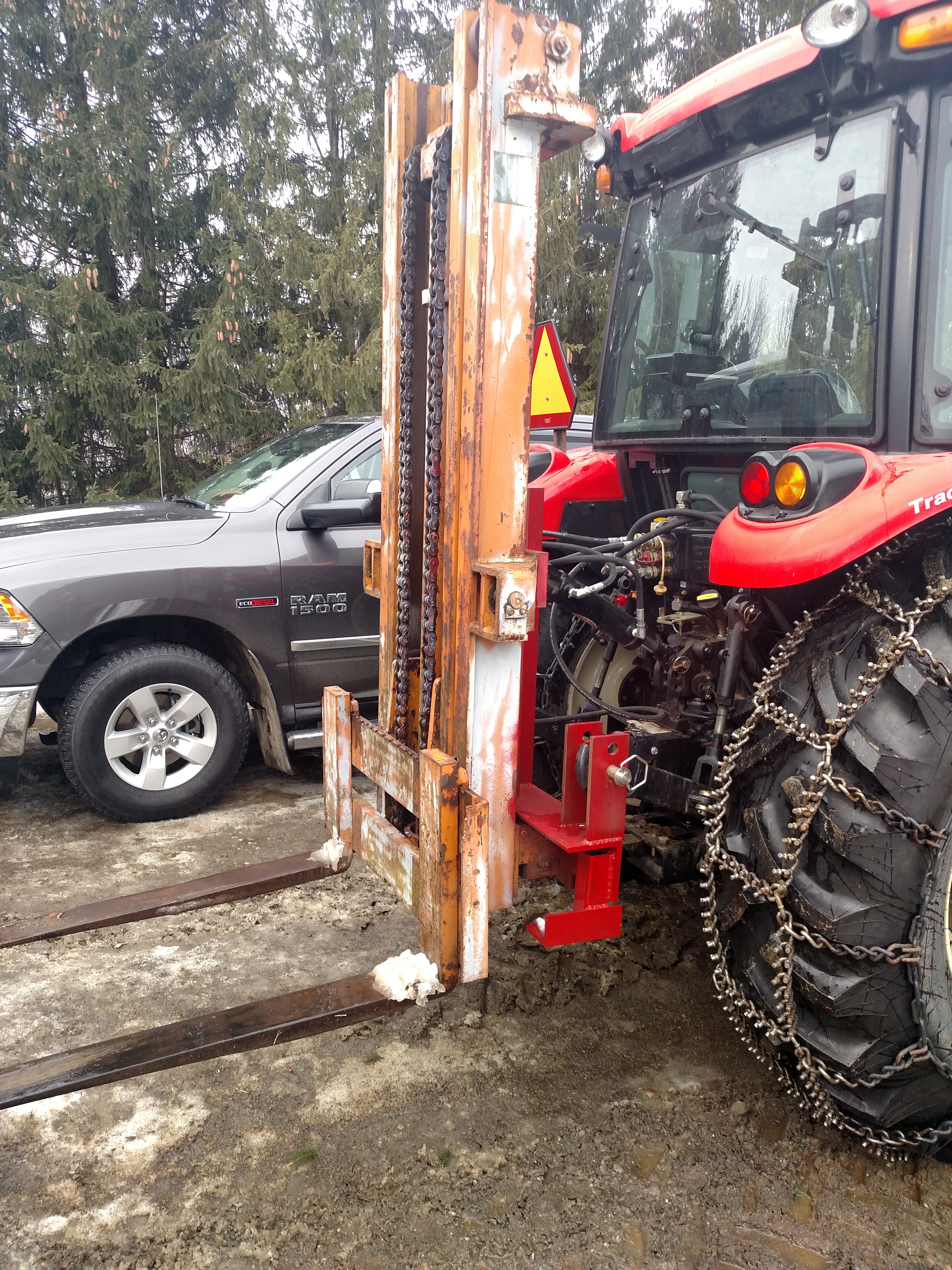

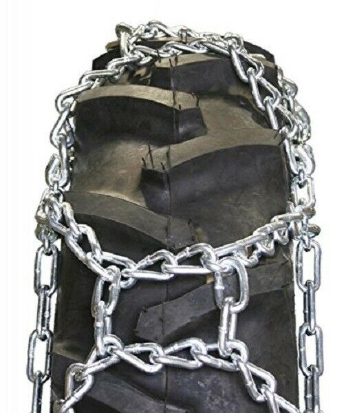

I chose these H-pattern DUO239 7mm alloy chains for the rear since I have limited fender room on the front of the rear fender.
Have you already bought those chains?
I hope not. While they will provide decent traction in snow they are not that good on ice and the ride quality is terrible.
I went with the euro style studded chains several years ago after going through all the others for many years.
The Aqualine Talons and others of that style will grip so much more and the ride is smooth almost like not even having chains on.
